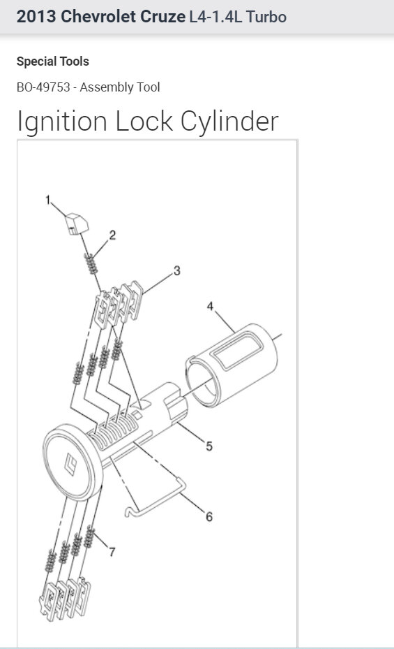

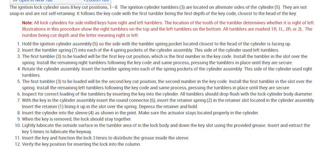

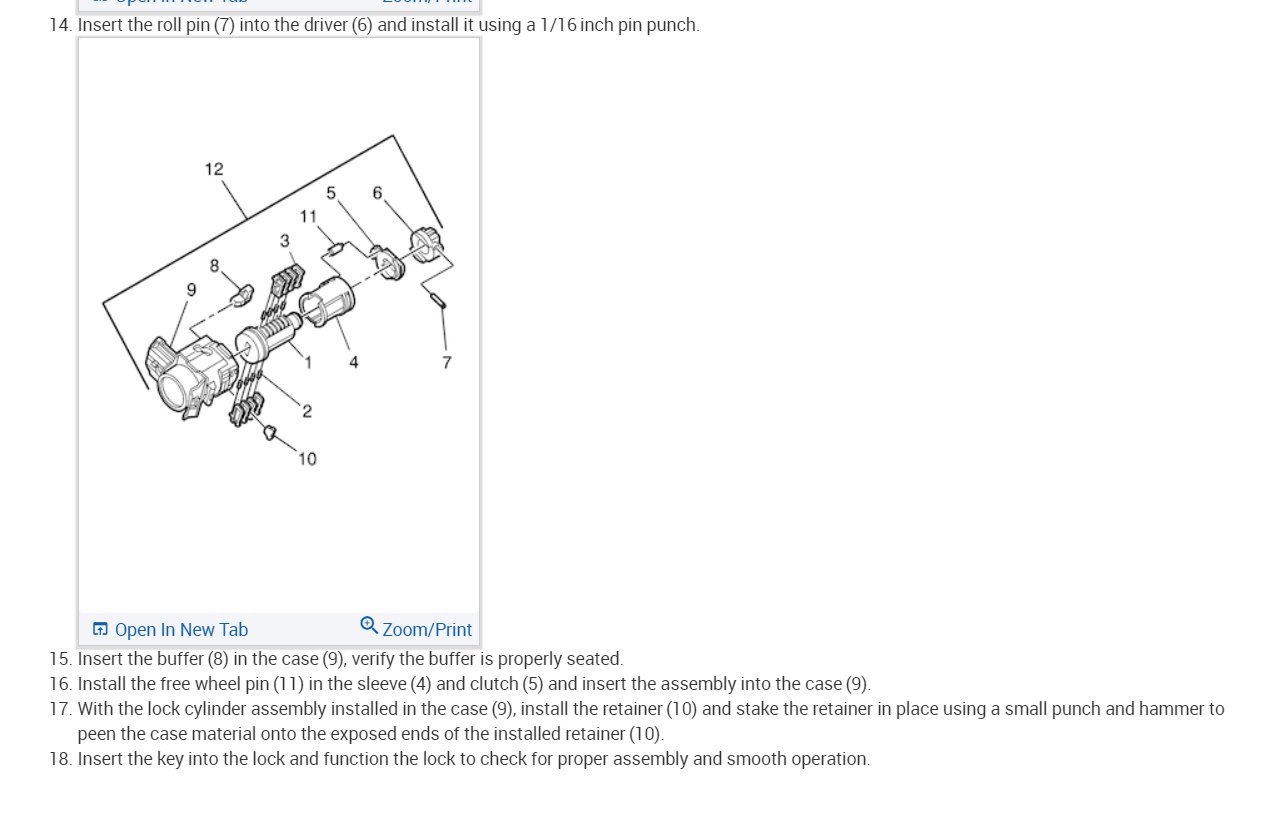

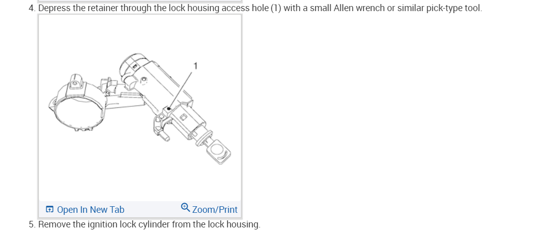

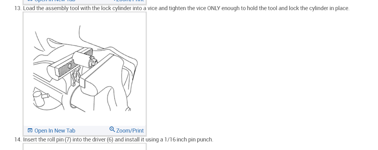

Lost springs out of ignition tumbler?
2013 CHEVROLET CRUZE
120,000 MILES • 1.4L • 4 CYL • 2WD • AUTOMATIC
SENATESKA
I need to know how to replace it?
Dec 14, 2022 at 5:42 AM
  • 55,394 POSTS

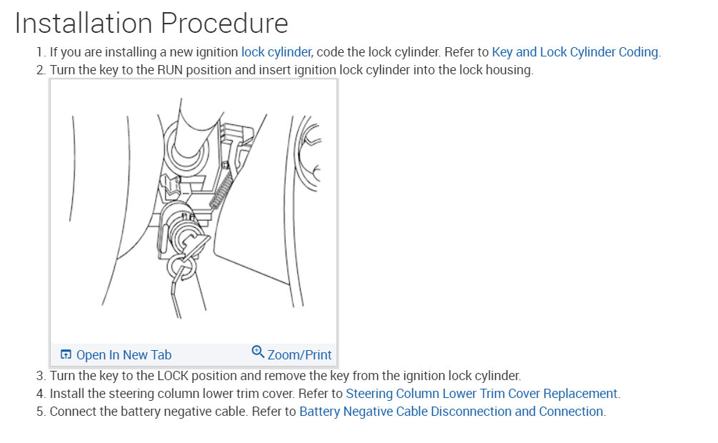

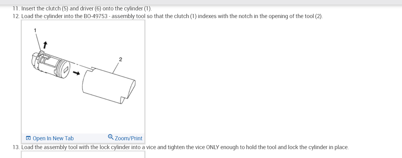

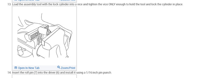

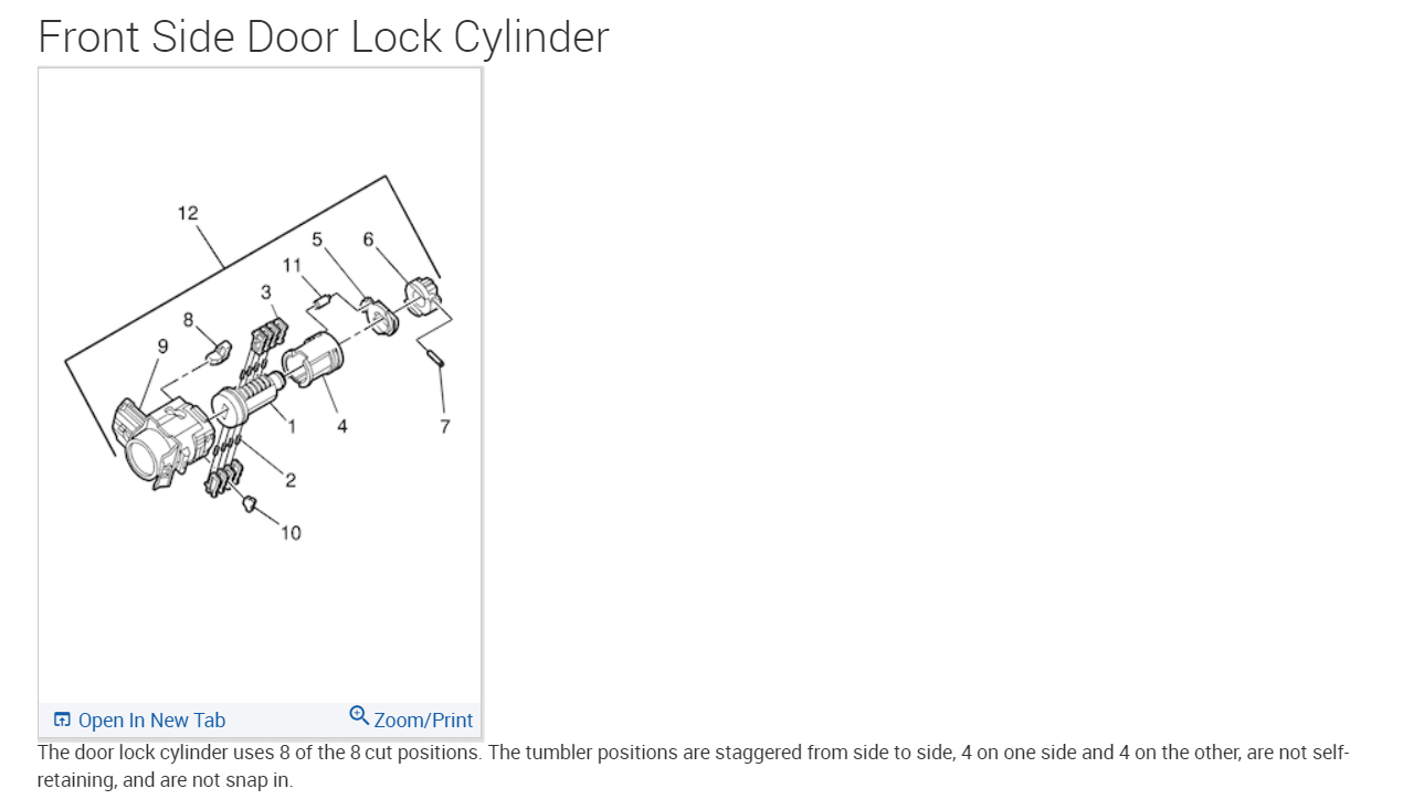

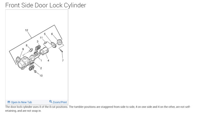

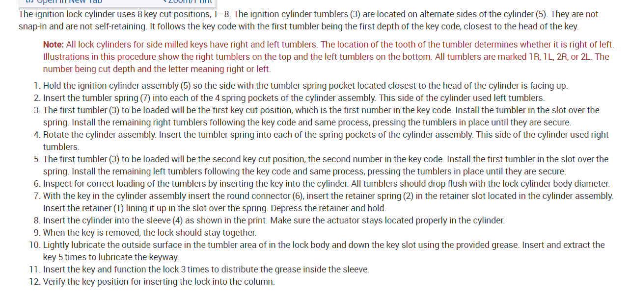

Here are the instructions on how to get the ignition lock out and how to recode the cylinder, which can be done with the door lock as well. So, the keys match or if you need the original key code. Check out the images (below). Please let us know if you need anything else to get the problem fixed.
