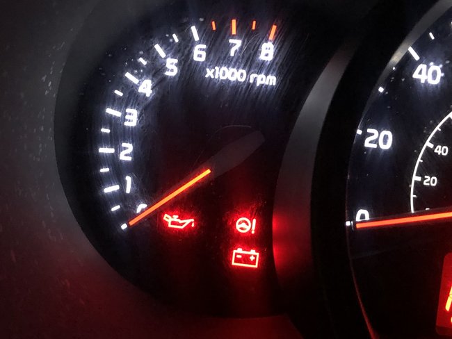

Also, pay attention to see if the tachometer is moving when you crank the engine.

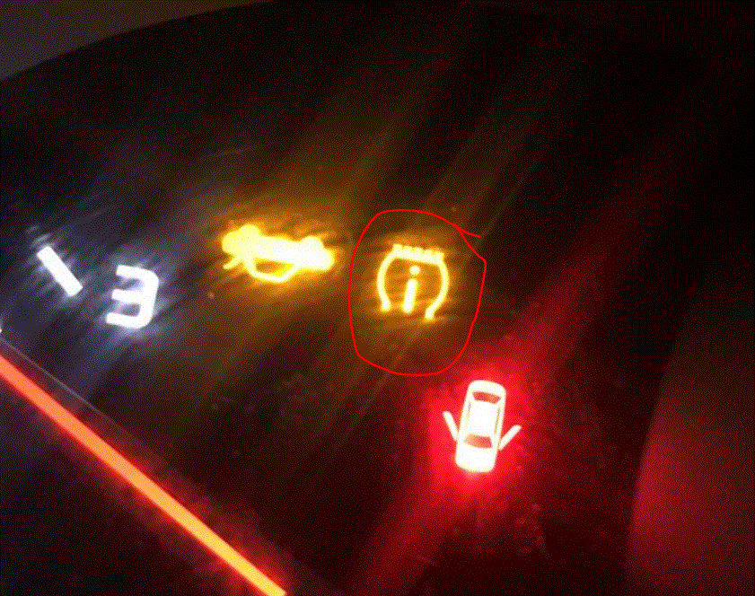

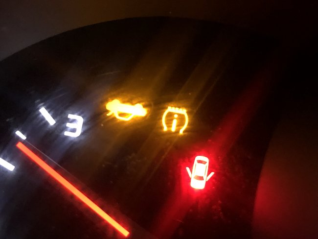

Also, this is what lights I have on dash , nit shown Is flashing light that is a yellow a meaning it looks like a letter a with a circle around it and it flashes when attempting to start car.

This is what lights I have on dash, not shown Is flashing light that is a yellow a meaning it looks like a letter a with a circle around it and it flashes when attempting to start car.

Also, I copied one of your pics and circled what I believe you are referring to. Take a look and let me know if I'm correct. If I am, that is a tire pressure indicator lamp.
See pic below.

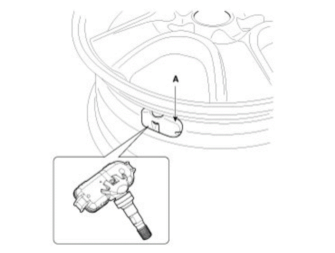

Can you give me a detailed description of where all the sensors are located?

I would be happy to. If you are referring to the tire pressure sensors, each wheel has one. I attached a pic below showing one.
If there are others you need, let me know.
See pic below.

What does the tachometer have to do with it not starting?
Jun 20, 2022 at 10:26 PM
  • 110,236 POSTS
If the tachometer doesn't move when you are cranking the engine, there is a good chance there is no RPM signal from the crankshaft position sensor which is required for it to run. I realize you replaced it, but there could be a wiring issue.
