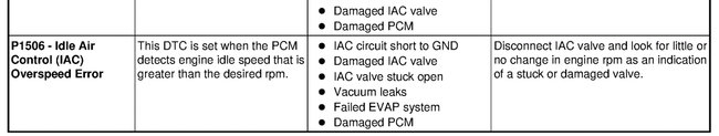

I have read the other questions related to mine but still don't know what to do. The car started stalling when i came to a quick start so after i Googled it i replaced the IAC and it fixed that issue. Now the car idles very high when you start it up but will back down to a normal idle after a few seconds. It will then start idling high while driving and when you come a stop it will remain at a very high idle until i put it in neutral. Once in neutral it will idle back down so after some research i replaced the TPS and i still have the same issue even after doing a calibration to reset the computer. I have replaced the PCV valve and both hoses. Not sure what's next. I do get a P1506 code to clean the IAC but i just replaced 2 months ago. What's next?

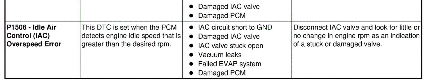

There could be a few different things causing this. The code you provided indicates an "overspeed error" which is exactly what you described.
If you look at the attached pic, it shows possible causes. The two easiest things to check is to first disconnect the IAC when it's at a high idle and see if it changes. If there is no change, then we will need to check wiring.
The second thing is to check for vacuum leaks. I realize you replaced the PCV, but there are other areas that can leak, so I would suggest checking. Here is a link that explains how to locate a leak:
Take a look at the attached pic. It indicates possible causes for this code. Also, let me know if this helps or if you have other questions.
