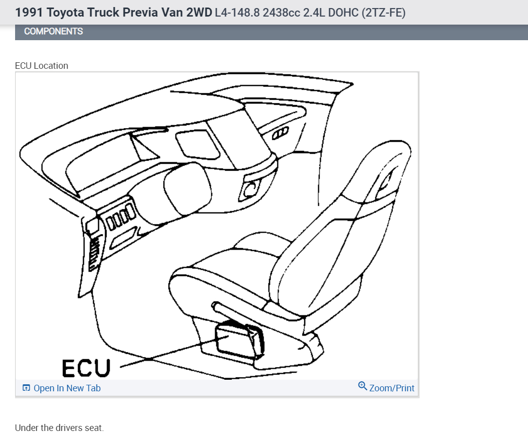

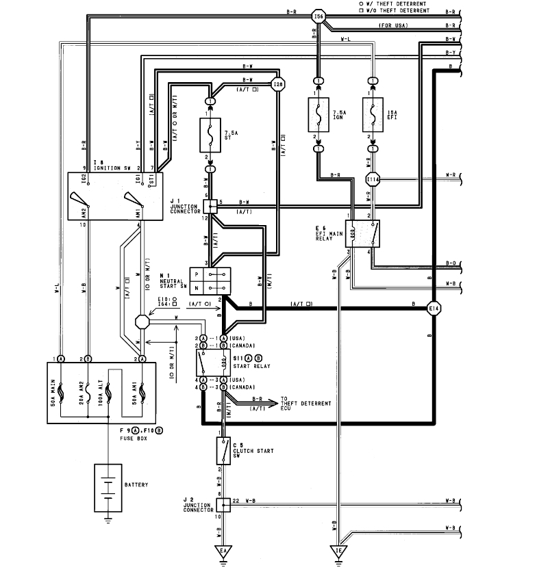

Sorry, they do not show us the engine wiring diagrams for 1991. It sounds like the voltage driver inside the ECU has gone bad or you have corrosion on the connector of the ECU. You may want to try to disconnect the coils and injectors in case one is shorted which can cause the ECU operational voltage to drop as well. Located under the driver's seat these can get wet and cause issues like this one. Check out the images (below). Please let us know what you find. We are interested to see what it is.

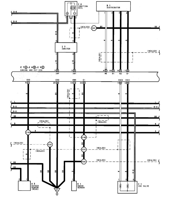

I do have the schematics (2) but this site is stating that the Filetype is not allowed as it's an Adobe Acrobat .pdf. I'll have to figure out what file to convert it to.
On a side note, I did have a driver side taillight that was so hot awhile back that it burned through the housing. I'm guessing maybe that was a bad intermittent ground that may be related as it appears gone now. The reason I bring it up is because I had a jeep that had the same rear driver light get bright when I hit the brakes (passenger side would go out completely) and at the same time it also affected the cruise control by shutting if off when I put the left turn signal on. I just rotated the bulb housing in the reflector, and it fixed both issues...maybe that's not the case here. The reflector casing on this van is plastic, whereas the jeep was metal and a 1 wire system with the reflector being the ground vs. the Previa 2 wires system to the bulb but still, maybe there's a grounding issue...

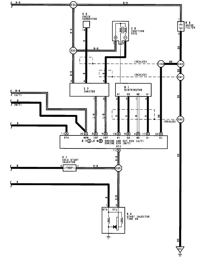

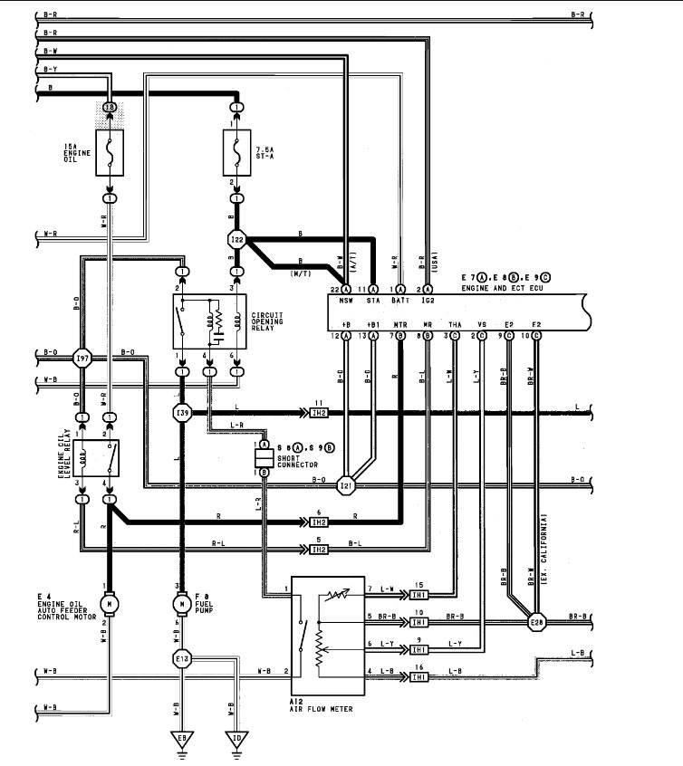

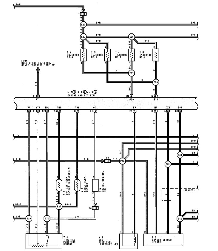

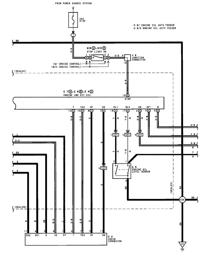

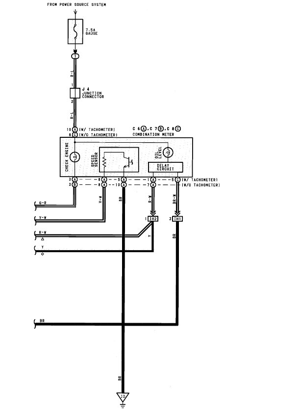

Yep, that could be, I found the engine and ECU wiring diagrams which show the grounds.
here is a guide to help you check it out and the diagrams in the images below:

Thanks, I have these in color, and I'm happy to upload them for others but I don't know what file type they need to be in. Do you? I'll have to figure out where they are in the car physically, not just electrically.
