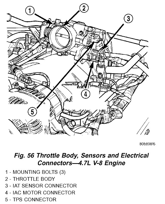

In park, RPMs run from 750 to as high as 1,400. Varies back and forth within that range every 20-30 seconds. Seems a little more intense with the A/C off. Any advice?

I have seen a bad TPS sensor, or a vacuum leak that can cause this problem, do you have a check engine light on? We should run the codes; this guide can help:

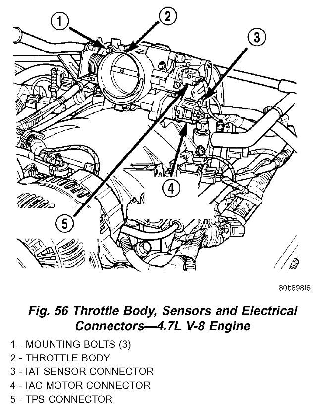

If no codes are present, then I would clean the throttle bore and IAC motor (#4) here is the location and a guide to help as well:

An erratic idle can be caused by a few different things. For example, the IAC (which you have replaced), an engine vacuum leak, fuel pressure, or the need for a tune-up. I'm sure there are other causes, but I would think these are the most common.
When you installed the new IAC, did you confirm the air passage was clear and carbon-free? If not, check that.
Here is a link that explains how to service the IAC:
https://www.2carpros.com/articles/idle-air-control-valve-service
If that doesn't help, I would be checking for engine vacuum leaks.
