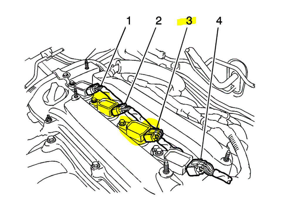

I went off the road and now traction control light, check engine light turned on, and it's throwing misfire cylinder 3 code.

ABS light is on solid, check engine light traction control is on. cleared everything changed the spark plug in cylinder three where it said misfire drove it and by time I went around the block it was doing it again and only showing misfire in cylinder three. only code it has.

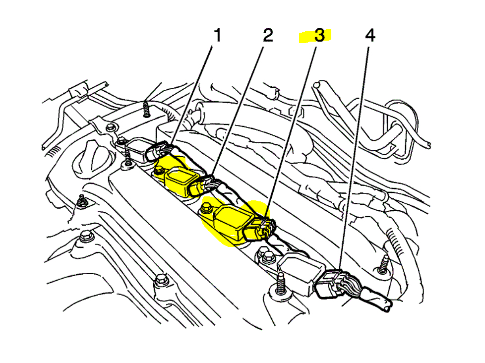

I want you to try something. The misfire could be the result of a faulty ignition coil. So, switch the cylinder 3 coil with cylinder 2. See pic 1 below. I highlighted the numbers 2 and 3 coils. If there is a problem with the number 3 coil, the misfire will move with it to cyl 2. You will need to have it scanned to confirm if it moved or not, but most parts stores will do it free of charge.
All you will need to do is disconnect the electrical connector at the two coils and then there is one bolt holding each in place. Remove the bolt and gently (while twisting back and forth) pull straight up on the coil to remove it. Install is the reverse.
Let's focus on one thing at a time. Once we get this issue resolved, we'll move on to the ABS.
Let me know what you find, if you have questions, or if I can help in any way.
See pic below.
