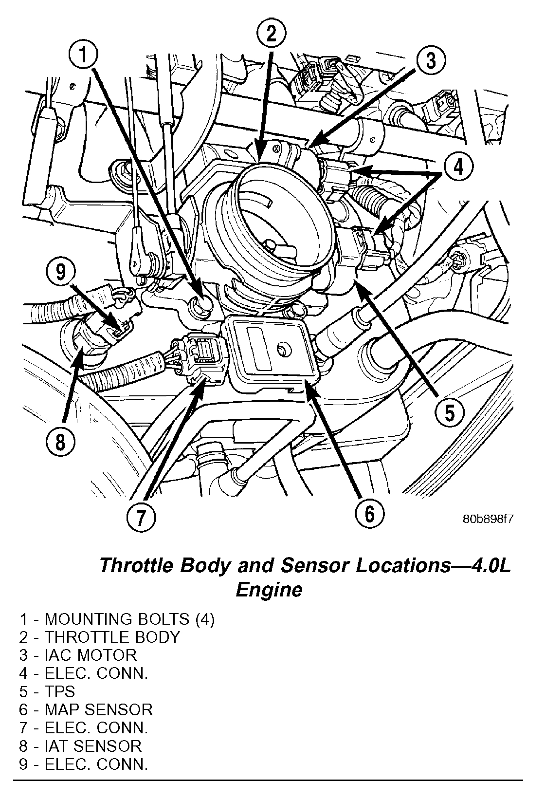

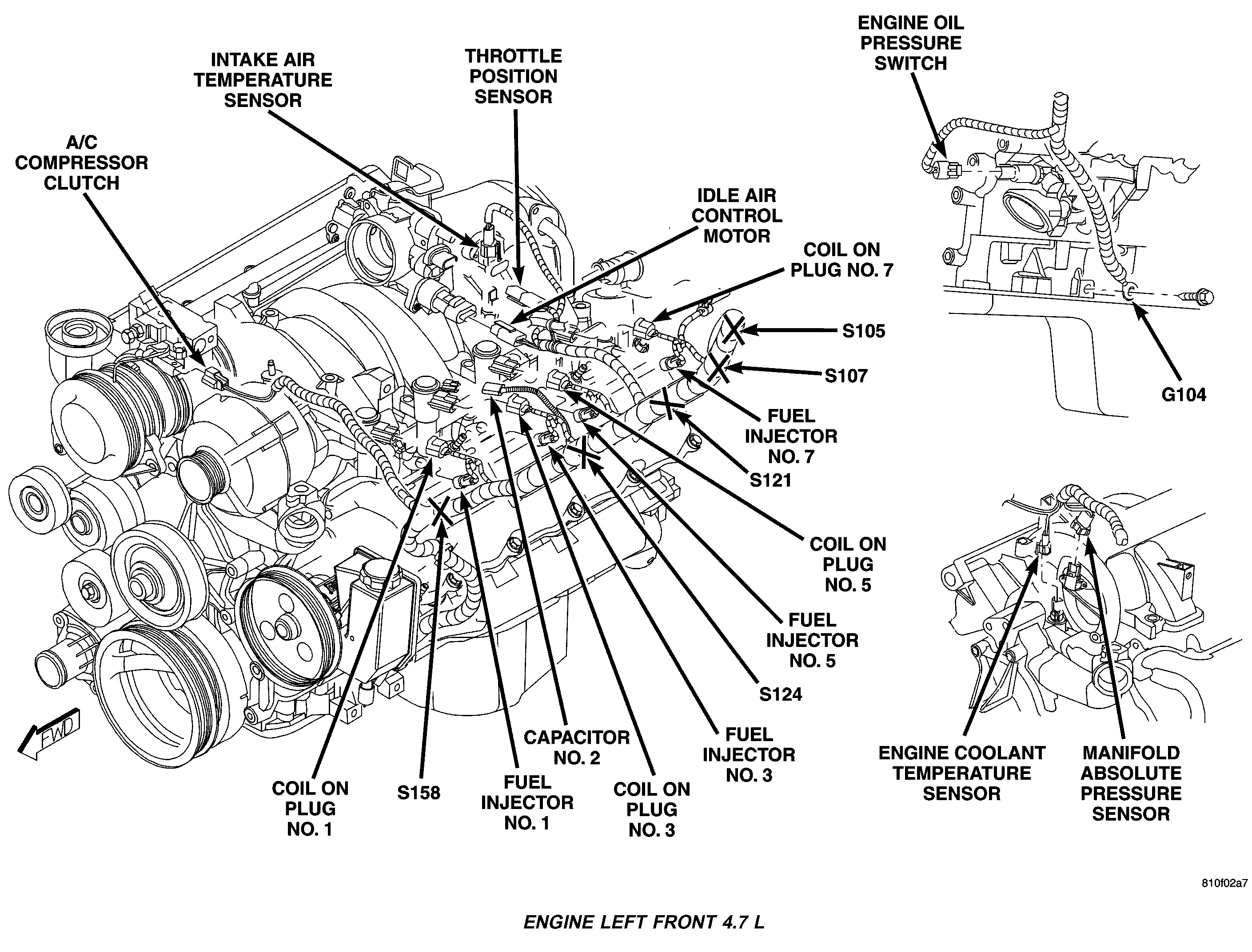

My Laredo has an rpm of 500 to 1,000 while the truck is in park? Is this normal?

I am not sure which engine you have the 4.0L or the 4.7 V8. I have attached pictures of both engines so you can locate the idle air control motor. It will be mounted on the throttle body. Picture 1 is the V8 and picture 2 is the six cylinder.
I hope this information is helpful. Let me know if you have other questions or need more information.
