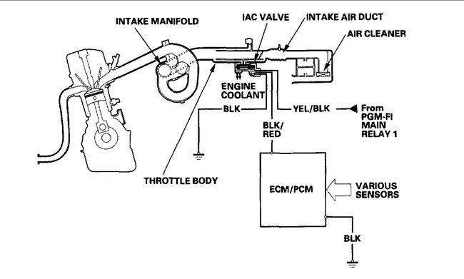

The idle can be related to a few things. For example, an engine vacuum leak, faulty idle air control system, engine coolant temperature sensor and so on. However, I'm a bit confused on the shifter. Do you mean it physically doesn't move?
As far as the idle, it is controlled by what is called an idle air control valve (IAC) which is located on the throttle body. After the engine starts, the IAC valve opens for a certain amount of time. The amount of air is increased to raise the idle speed. When the engine coolant temperature is low, the IAC valve is opened to obtain the proper fast idle speed. The amount of bypassed air is controlled in relation to engine coolant temperature.
Now, I attached a pic below of the IAC system. Here is a link that explains in general how one is serviced. You may want to start with this.
https://www.2carpros.com/articles/idle-air-control-valve-service
Also, let me know if the check engine light is staying on with the engine running and if you have ever noticed any issues with the temperature gauge in the vehicle.

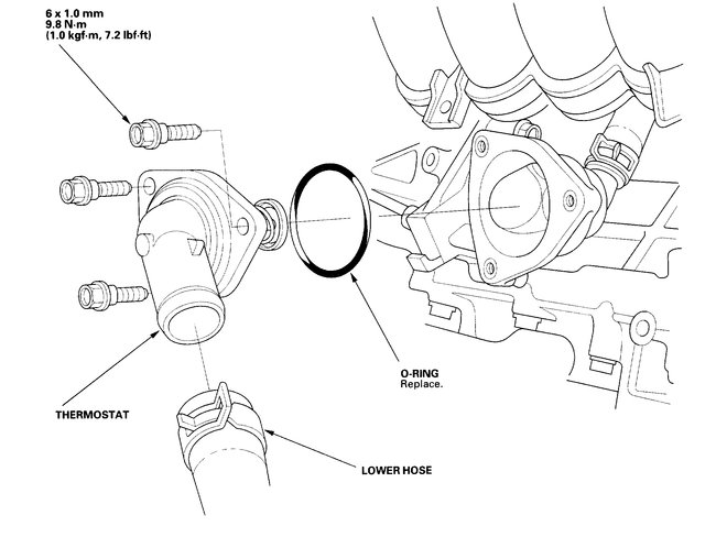

If the coolant is full and the fan is working, suspect the thermostat needs replaced. I would also flush the cooling system when replacing the thermostat.
Here are two links related to replacing the thermostat and flushing the cooling system:
https://www.2carpros.com/articles/coolant-flush-and-refill-all-cars
______________________________
Here are the directions specific to your vehicle. The attached pic correlates with the directions.
2003 Honda Truck CR-V 4WD L4-2.4L
Procedures
Vehicle Engine, Cooling and Exhaust Cooling System Thermostat Service and Repair Procedures
PROCEDURES
Pic 1
Thermostat Replacement
1. Drain the engine coolant.
2. Remove the splash shield (see step 22).
3. Remove the lower hose, then remove the thermostat.
4. Install the thermostat with a new O-ring, then install the lower hose.
5. Install the splash shield (see step 23).
6. Refill the radiator with engine coolant, and bleed air from cooling system with the heater valve open.
___________________________________________
Let me know if you are able to find any vacuum leaks.
