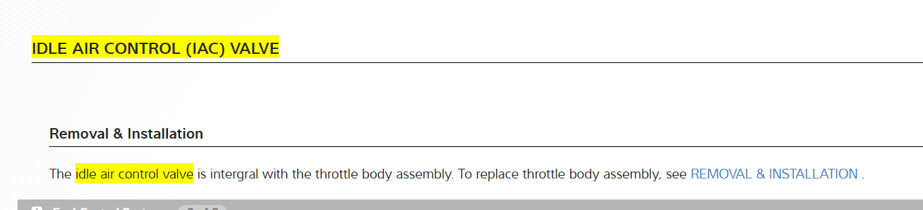

When i start my truck up it wants to shut off instantly. when i am at a stop I have to hold the gas pedal and keep it idling at about 1,000 RPM or 1,500 RPM, I replaced the EGR valve thinking it was that. Any suggestions?

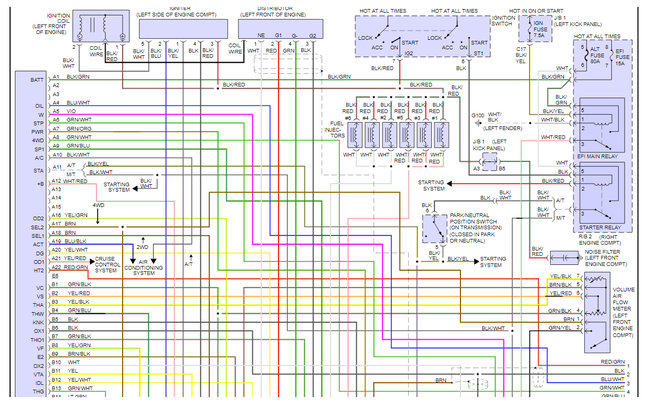

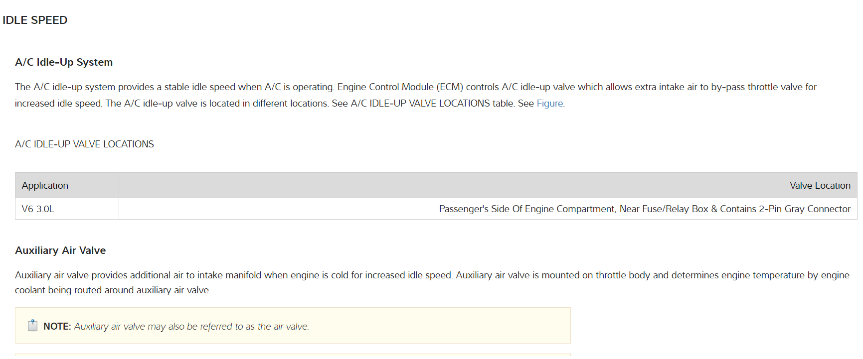

This sounds like a problem with your vehicle's Idle Air Control Valve(IAC). I have included a link for you down below that will take you to a guide for it.
https://www.2carpros.com/articles/how-to-replace-an-idle-speed-control-motor-iac

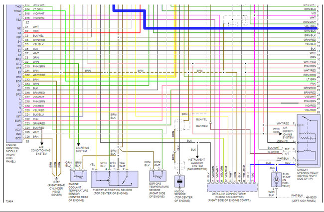

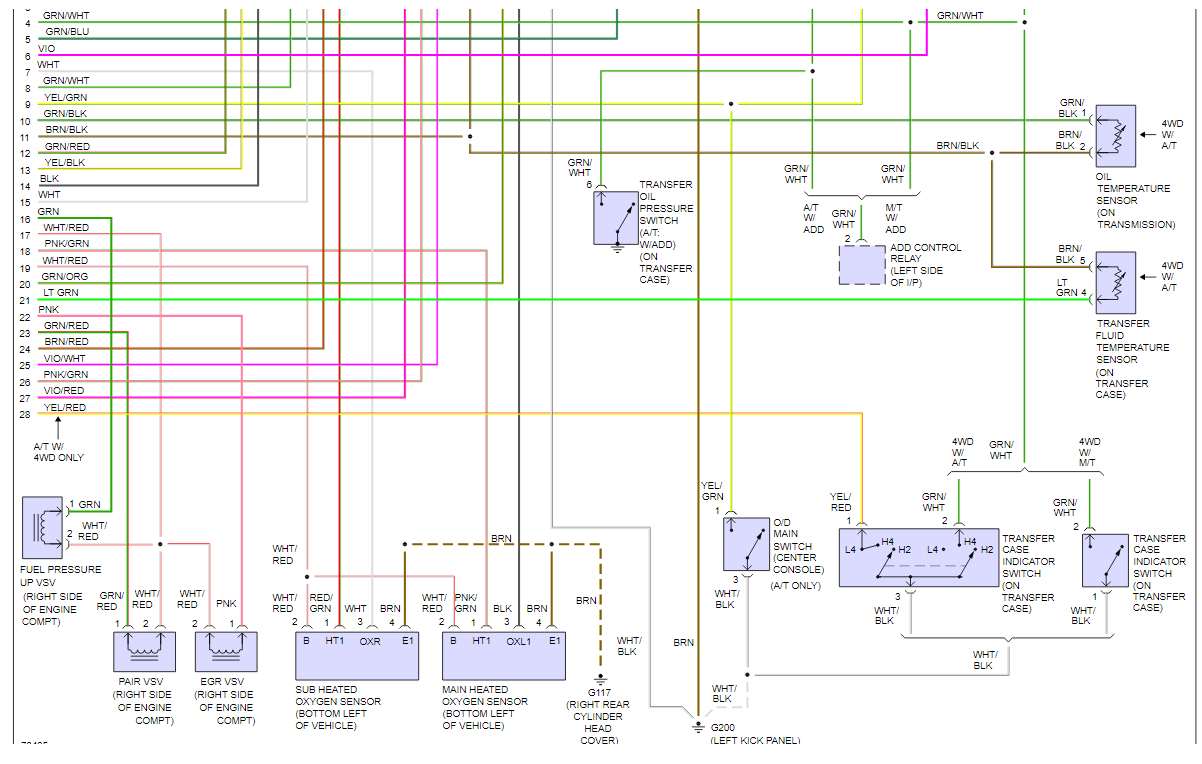

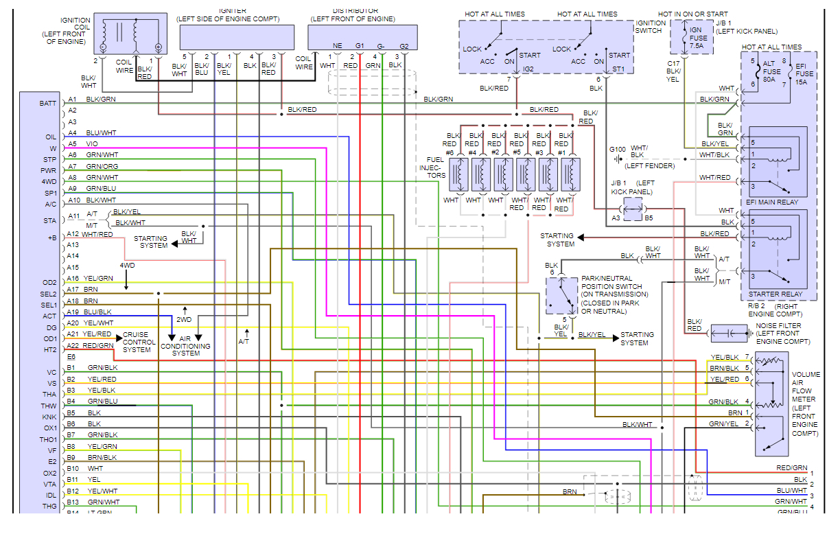

I have also included vehicle specific information for you in the diagrams down below. Please go through these and get back to us with what you find out.

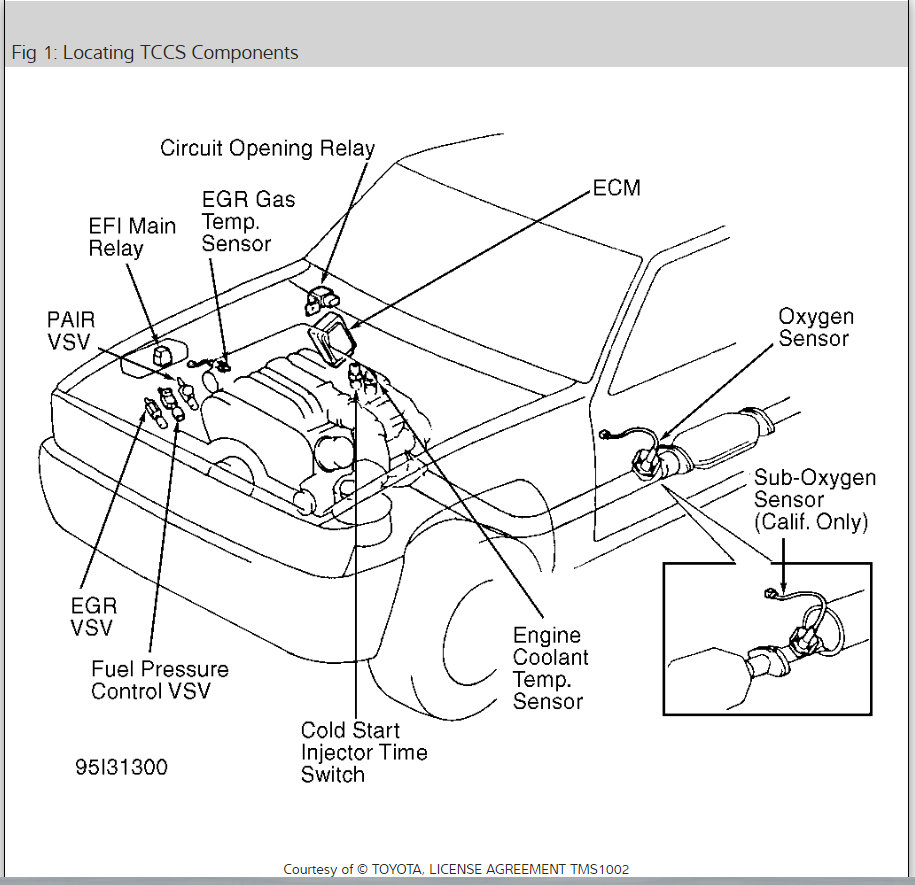

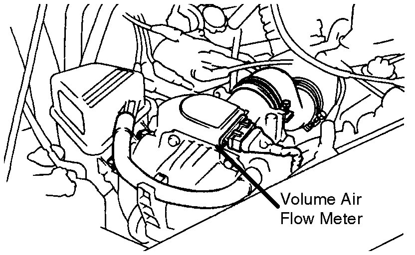

Most times this problem is related to only a few different things, a vacuum leak, plugged air filter, volume air flow sensor, or the throttle body needs cleaned.
First, here are a few links that discuss how to find a vacuum leak and clean a throttle body. Also, inspect the air filter to confirm there is nothing being blocked as well as confirm nothing is disconnected between the air box and the throttle body.
https://www.2carpros.com/articles/how-to-replace-a-car-air-filter
Now, confirm the air flow meter sensor is connected and there is no corrosion on the plug.
I attached a picture of the sensor and its location. Additionally, here are the directions for testing the sensor.

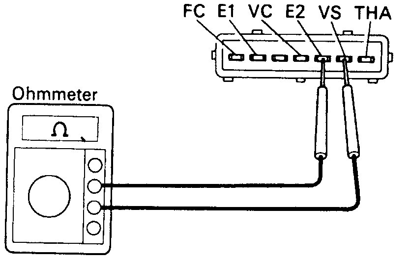

INSPECTION
On Vehicle
1. Disconnect the connector from the Volume Air Flow Meter.
Air Flow Meter Connector Terminal Identification
See picture 2
2. Using an ohmmeter measure the resistance between each terminal as shown:
Between terminals E1 and FC
measuring plate fully closed .................... infinity
Between terminals VC and E2
always .................... 200 - 400 ohms
Between terminals THA and E2
at -20°C (-4°F) .................... 10 - 20 k ohms
at 0°C (32°F) .................... 4 - 7 k ohms
at 20°C (68°F) .................... 2 - 3 k ohms
at 40°C (104°F) .................... 0.9 - 1.3 k ohms
at 60°C (104°F) .................... 0.4 - 0.7 k ohms
3. If not within specifications, replace Volume Air Flow Meter.
Off Vehicle
Picture 2
1. Using an ohmmeter measure the resistance between each terminal as shown:
measuring plate other than closed .................... zero
Between terminals VS and E2
measuring plate fully closed .................... 200 - 600 ohms
measuring plate fully open .................... 20 - 1200 ohms
2. If not within specifications, replace Volume Air Flow Meter.
NOTE: Resistance between terminals E2 and VS will change in a wave pattern as the measuring plate slowly opens.

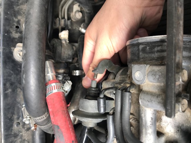

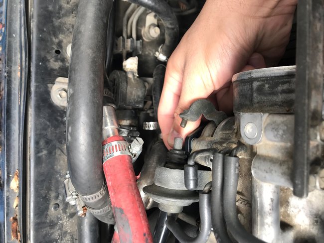

So, i got an answer last time i asked about my idling issue. it wants to shut off immediately and when i'm at a stop, i have to keep it rev'd at 1000-1500 RPM. well, I cleaned the throttle body and the bore and i was still having that issue. i was then told it was the TPS due to when i was driving it was chugging. well, i replaced the TPS but the thing is when i put it on the throttle wants to stay open. I so not know how to set it to normal, i'm lost. i spent thirty minutes just to put those tiny screws back on. Any help would be greatly appreciated. thanks in advance.
