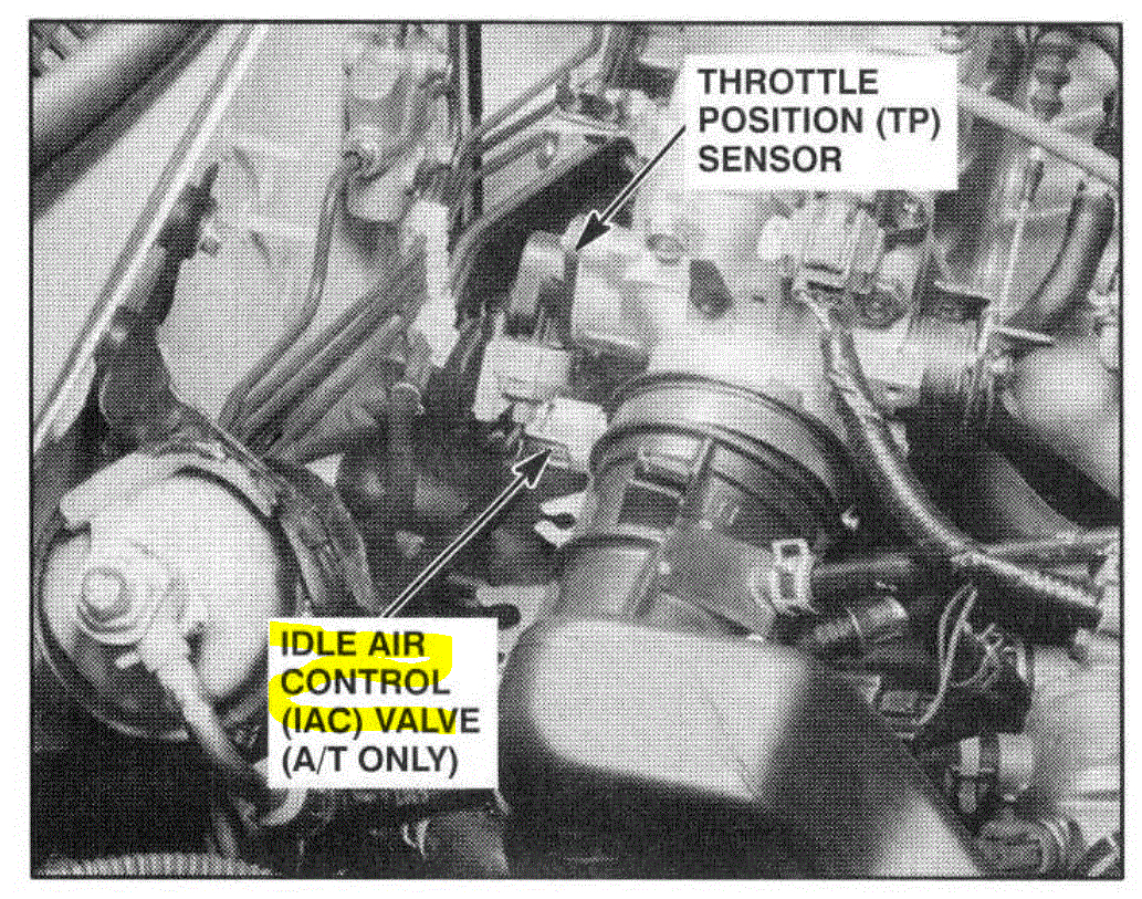

Car starts up idles good then after a few minutes idle drops down and it almost stalls stays that way for about 1 minute then idles back to normal. it repeats this cycle continuously. don't know what to do. help, thank you.

The idle speed on this vehicle is controlled by what is called an Idle Air Control valve (IAC). Now, before we assume that is the problem, let's do a couple of checks. First, I would suggest checking to see if there are any vacuum leaks. An engine vacuum leak can cause an idle issue and even a rough idle. Take a look at this link. It explains how to check for a leak.
If you find everything is okay, then I would try servicing the IAC. Here is a link that shows how it's done:
https://www.2carpros.com/articles/idle-air-control-valve-service
I attached a pic below showing where the IAC is located on this vehicle. It's on the throttle body.
Let's start with this. Let me know what you find or if you have other questions.
