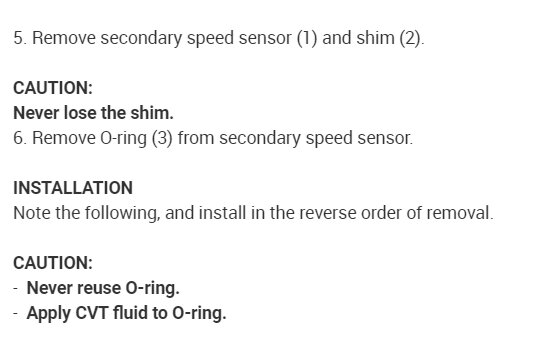

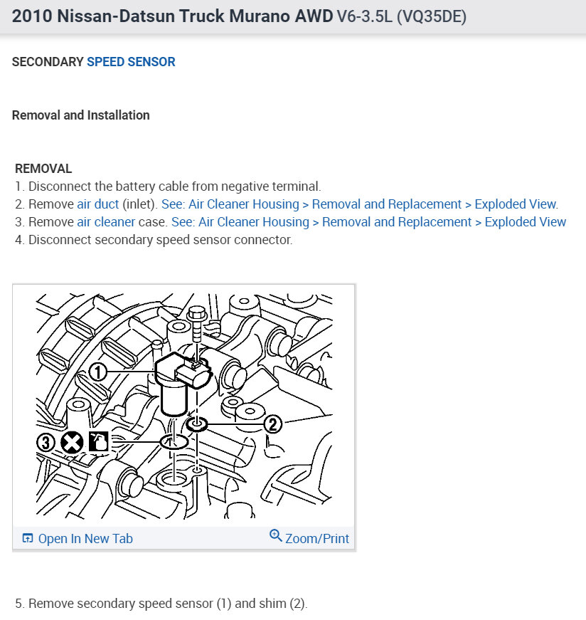

I had problems with the injections so I replaced the injectors but couldn't get the car to take them. So, I cleaned the old injectors and put them back in. did spark plugs, changed the coils, changed cam and crank shaft, can't find 1 crank so haven't done that yet, MAF, and vias solenoids 1 and 2. I put new vacuum hoses, then put the old ones back because I still had an issue with the gearshift, which made it worse. The throttle connector doesn't click when you clip it on, but it still goes on. But I can't get the car to shift out of second, the idle goes high if I go downhill, and I can go 70MPH and it still won't shift, acts as if it is not supposed to. What am I missing?

It sounds like the secondary speed sensor is out, but we should do a scan to see which codes are stored. Here is a guide to help us figure out the problem:
This guide may help as well:
Here is the location for the secondary sensor in case a code comes up for it. Check out the images (below). Please let us know how it goes. This vehicle has the CVT transmission which had problem btw.
Sep 1, 2023 at 4:59 AM
