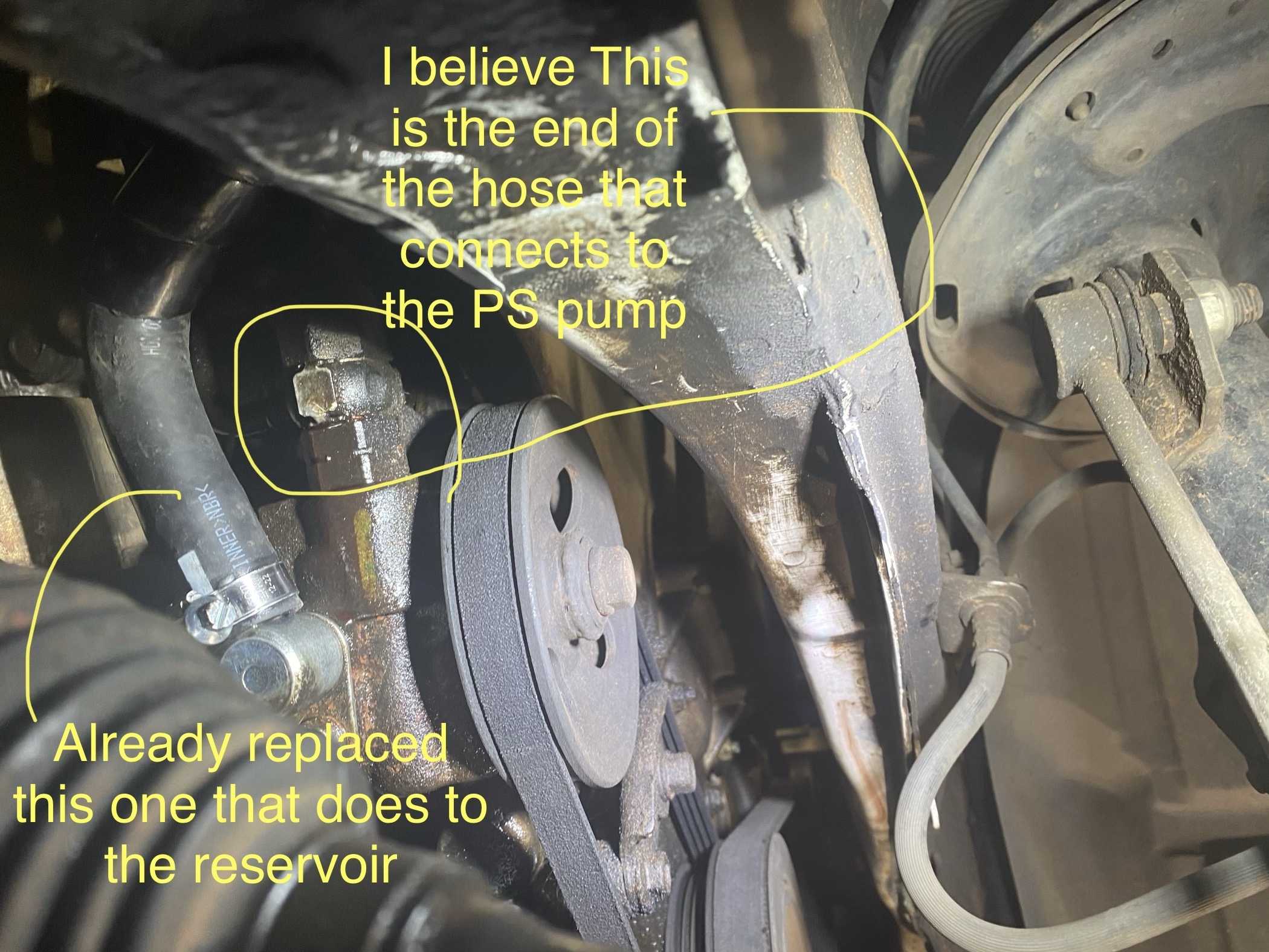

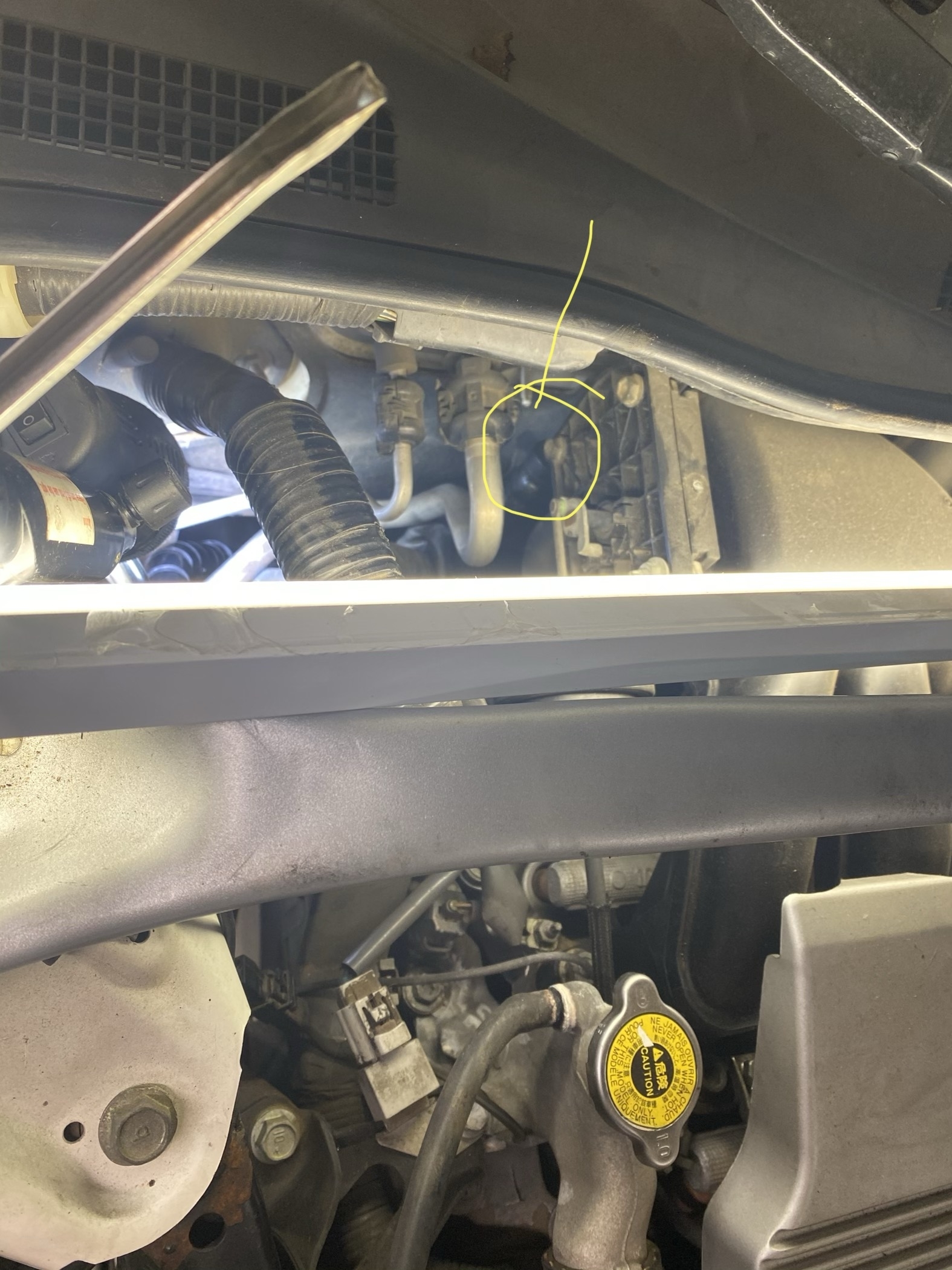

Identify power steering hose leak
2005 LEXUS ES 330
185,000 MILES
SPEAR7778
  • 5 POSTS
I believe I have found the source of the leak, but need help identifying the hose.
I will attach pics.
Oct 24, 2020 at 5:28 AM

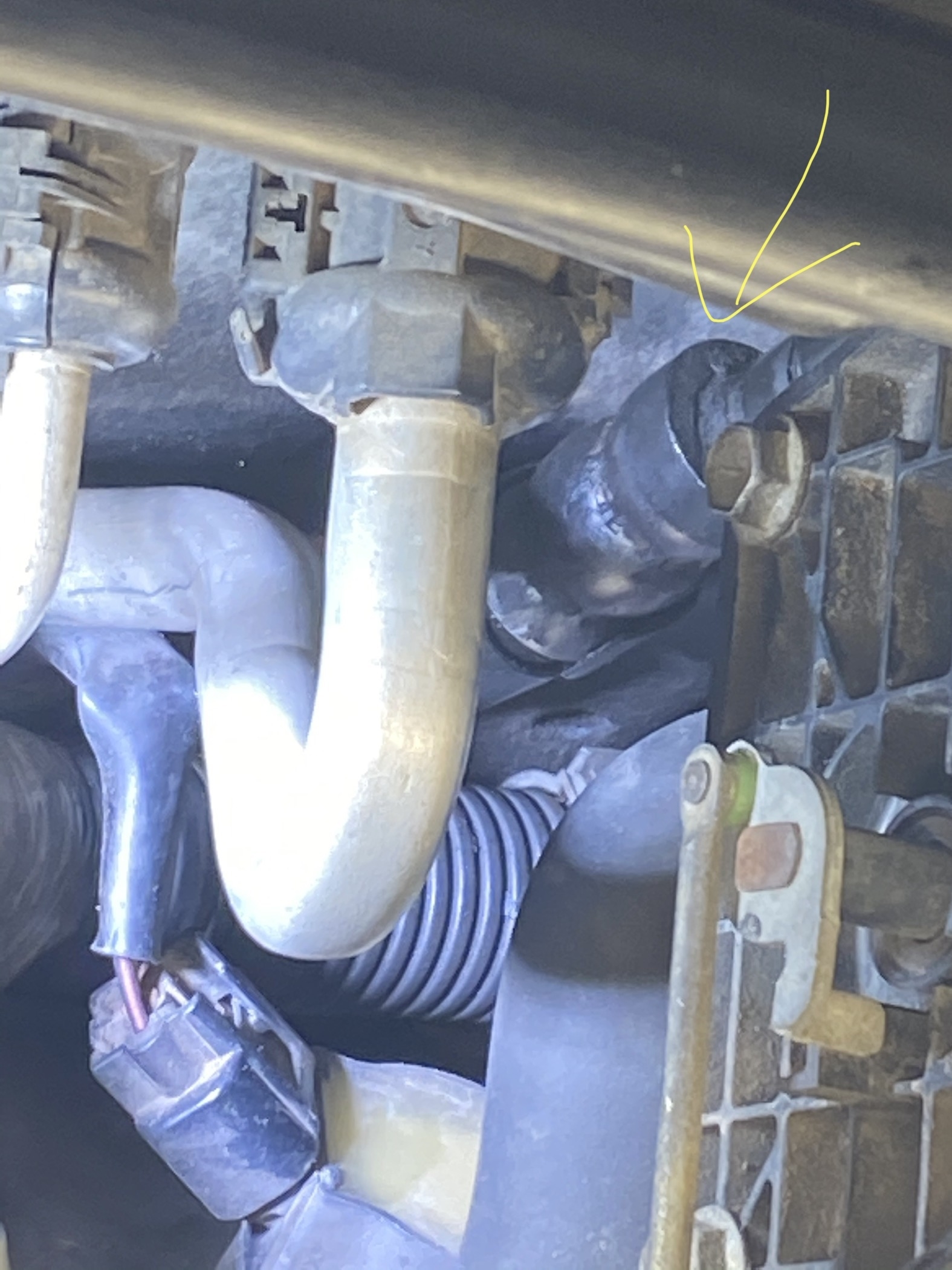

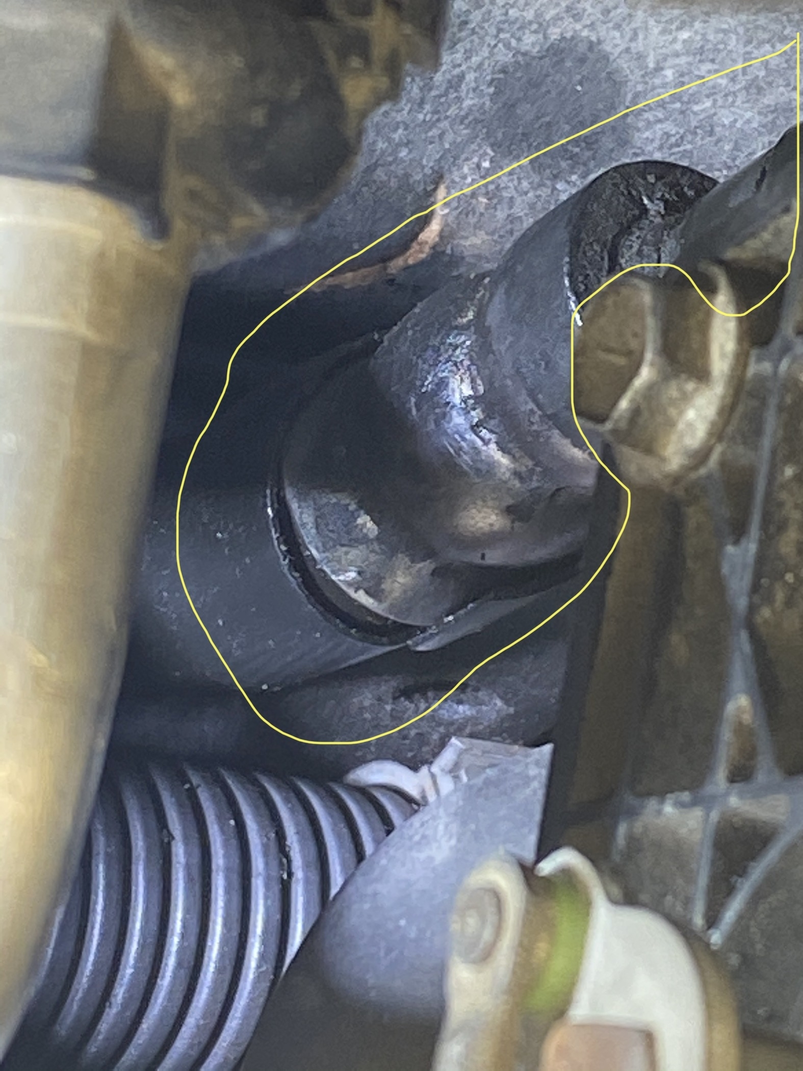

SPEAR7778
  • 5 POSTS

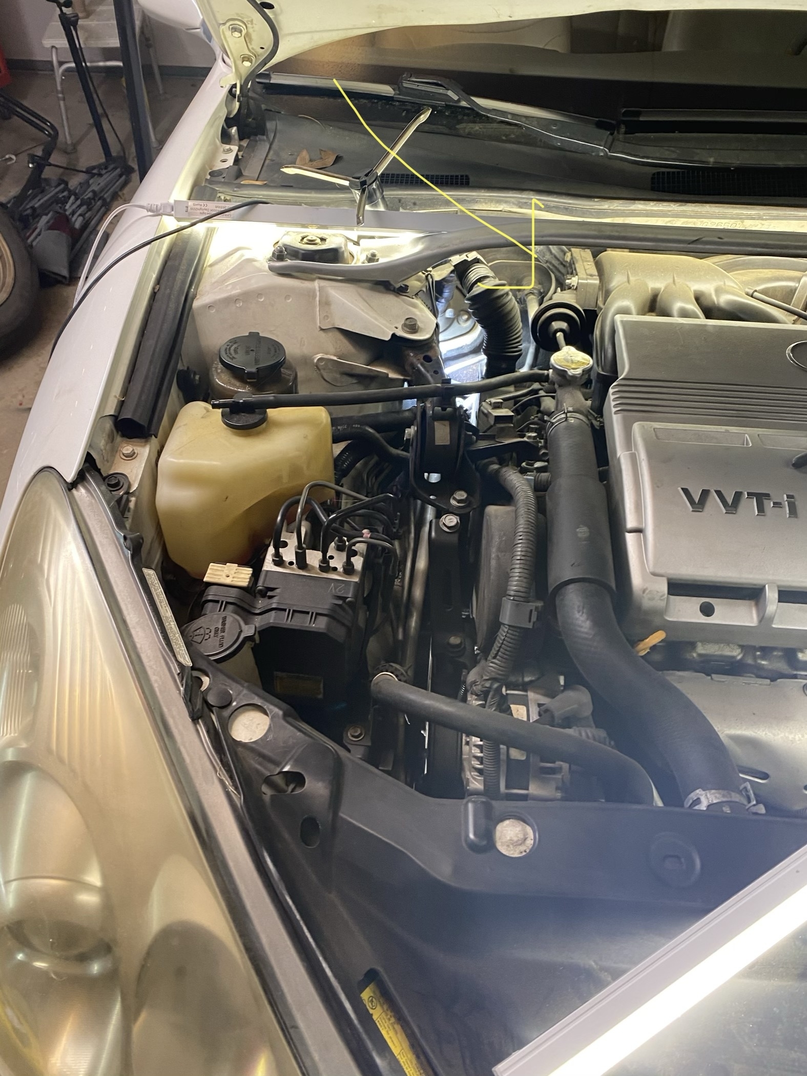

Additional picture.
Oct 24, 2020 at 5:29 AM
SPEAR7778
  • 5 POSTS
I will also send a pic from under.
Oct 24, 2020 at 5:42 AM
SPEAR7778
  • 5 POSTS
Another pic.
Oct 24, 2020 at 5:43 AM
SPEAR7778
  • 5 POSTS
Berger is one from under the car. Any help is appreciated!

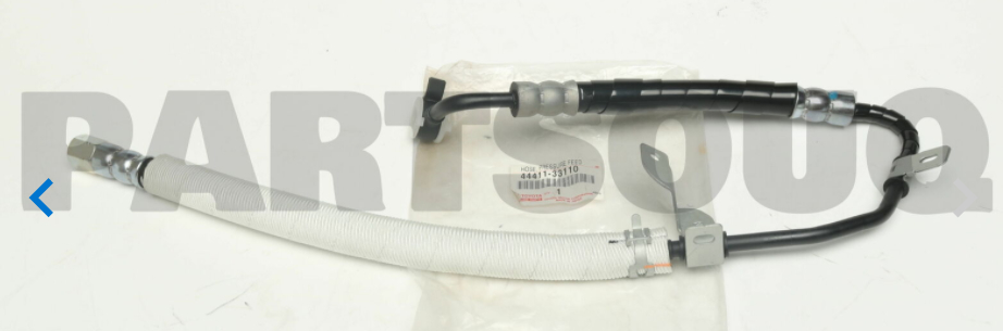

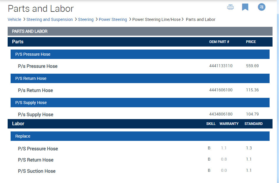

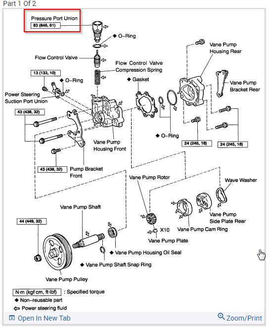

That looks like the pressure line. Take a look at this diagram and then the picture of the replacement line and see if it is the same on the vehicle.
Let us know if this is not it but that connection to the pump has a bolt that goes through a union nut which would make it the pressure line. i included the part numbers for the power steering hoses as well.
