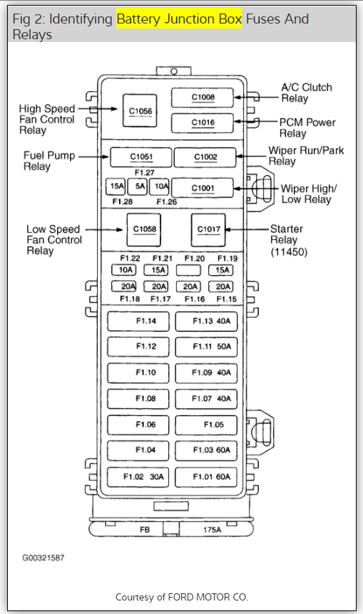

icc fuse location?
2004 FORD FALCON
200,000 MILES
MICKY BUTTAR
no power to the radio?
Dec 19, 2020 at 3:54 AM
  • 54,832 POSTS

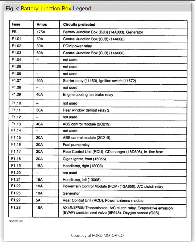

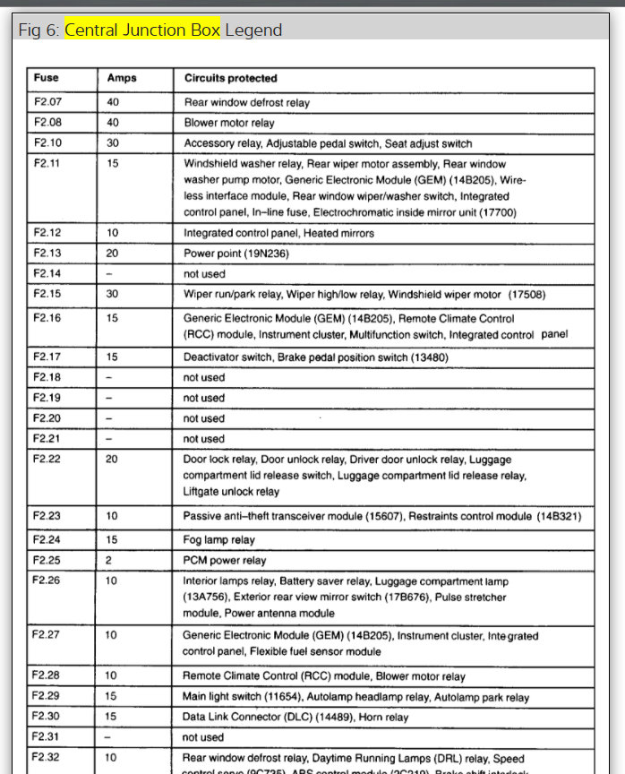

In the 2004 Ford Falcon, the ICC (Integrated Climate Control) fuse is located in the fuse box under the dashboard on the driver's side. Here's how you can locate it:
