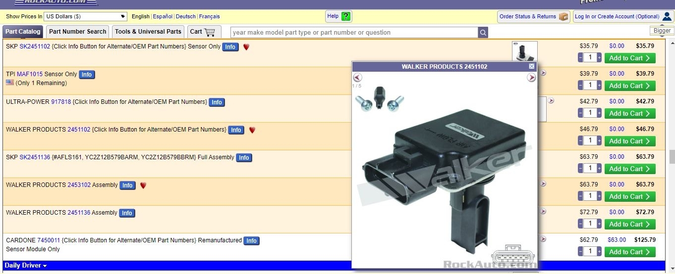

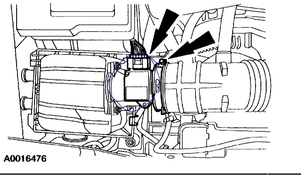

Good afternoon,
It is part of the mass air flow sensor.
I attached a picture of the sensor and its location.

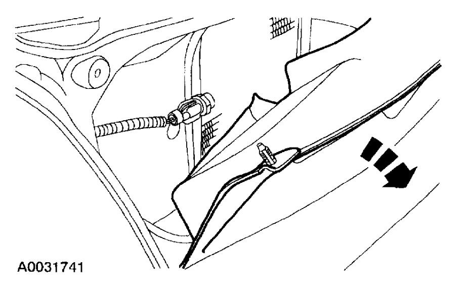

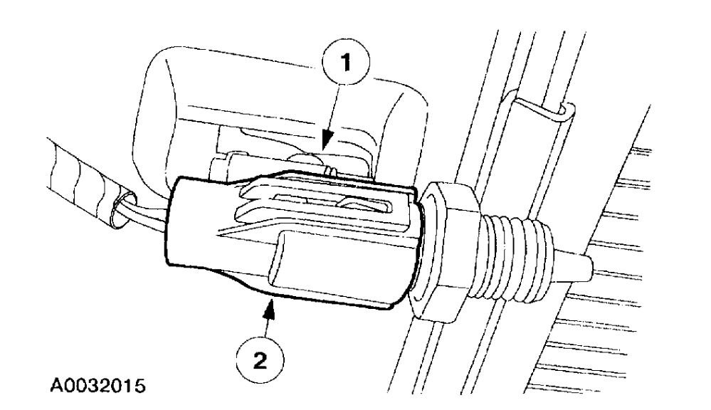

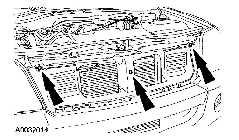

Good afternoon,
The sensor is behind the grille on the radiator support.
I attached the procedure and pictures for you.
REMOVAL
1. Remove the radiator grille.
2. Remove the three upper pin-type retainers in the radiator air deflector.
3. Position forward the air deflector.
4. Remove the ambient air temperature sensor.
1 Detach the pin-type retainer.
2 Disconnect the electrical connector.
