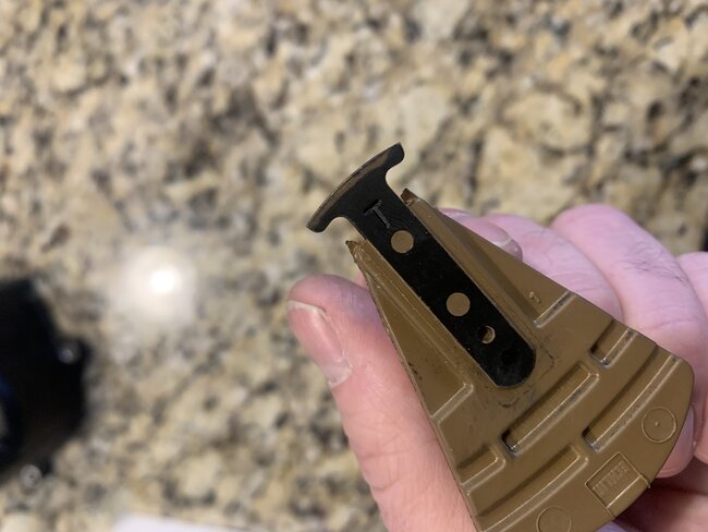

I changed the spark plugs, spark plug wires, cleaned the IAC valve and checked for vacuum leaks(none) and it still runs rough. There is no check engine light. I am stumped. Please help. Any suggestions will help.

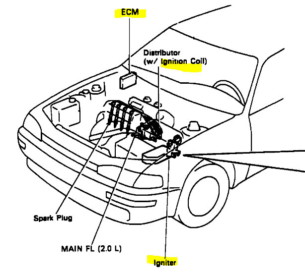

The idea that this happened after washing the engine simply indicates we have something electrical wet. Although the check engine light isn't on, I would suggest checking to see if there are any codes stored.
Here is a link that explains how to do it:
https://www.2carpros.com/articles/toyota-trouble-code-definitions-and-code-gathering-method-1990-1995
Next, if you were spraying under the hood, the ignitor, and the distributor/ignition coil are there. Did they get wet when you worked on the engine bay? See pic below
Note, I highlighted the PCM, but that should be on the inside of the vehicle. Check those components for water, dampness, and so on. Also, I realize you replaced the spark plug wires, but did you remove the distributor cap to make sure nothing is wet?
See pic below.

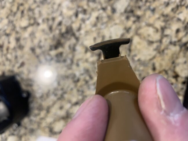

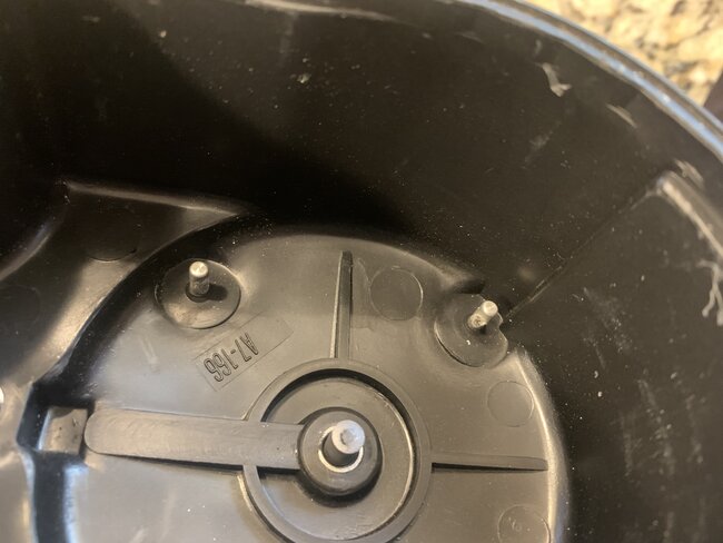

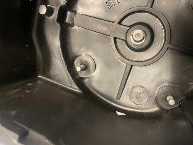

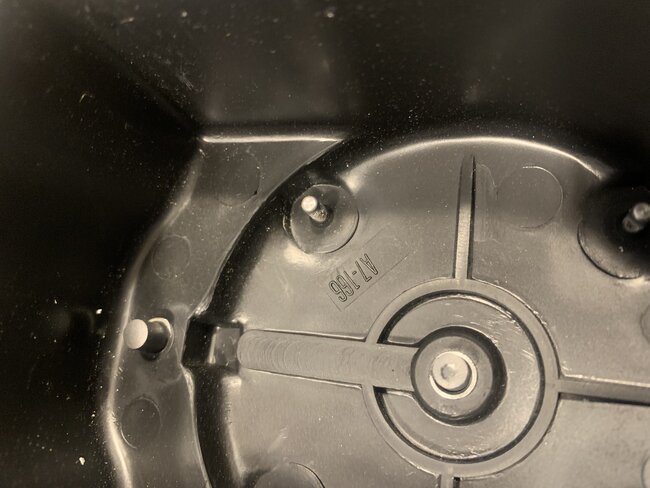

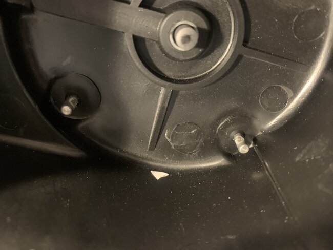

I pulled the distributor cap and rotor off. They weren’t wet but I attached pictures of both. Are the terminals on the cap bad and is the tip of the rotor bad?
Nov 30, 2022 at 5:30 AM
  • 110,240 POSTS
I've seen a lot worse. They should be replaced, but it isn't an emergency. Is the vehicle still running rough? By chance, did you try the carb cleaner test?
