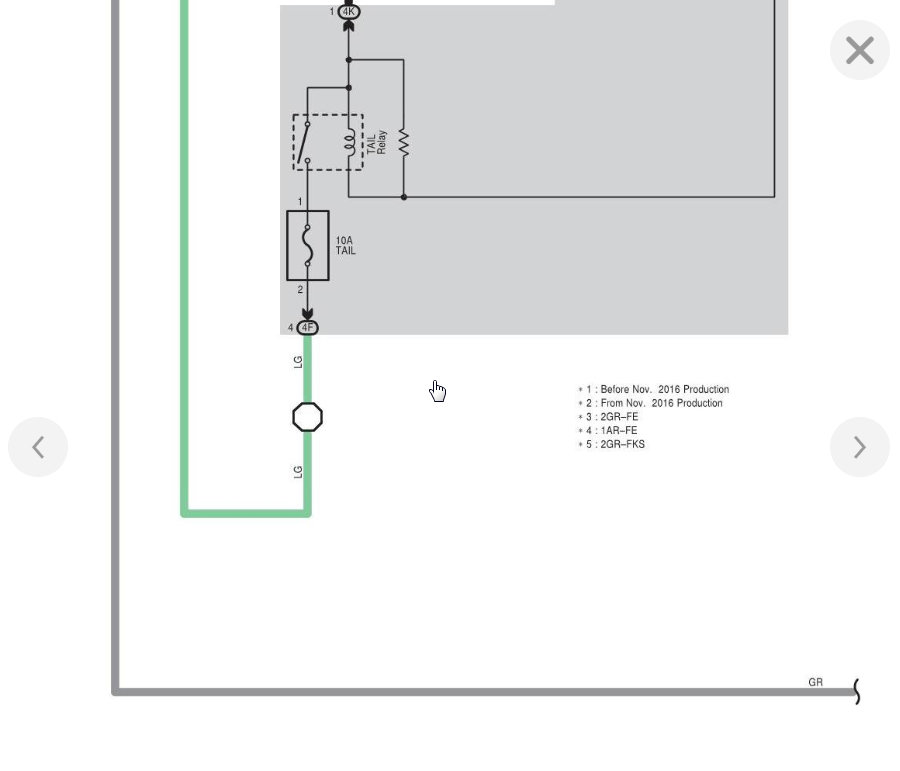

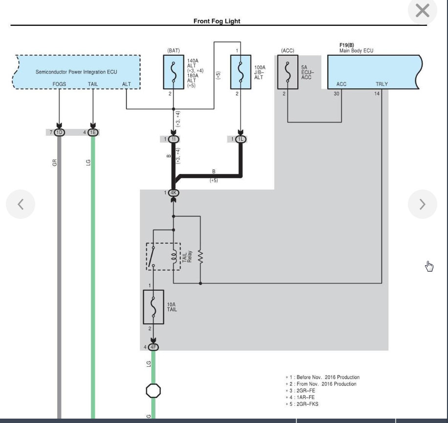

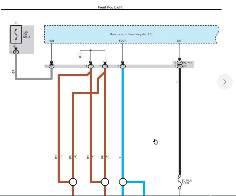

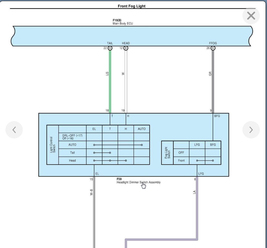

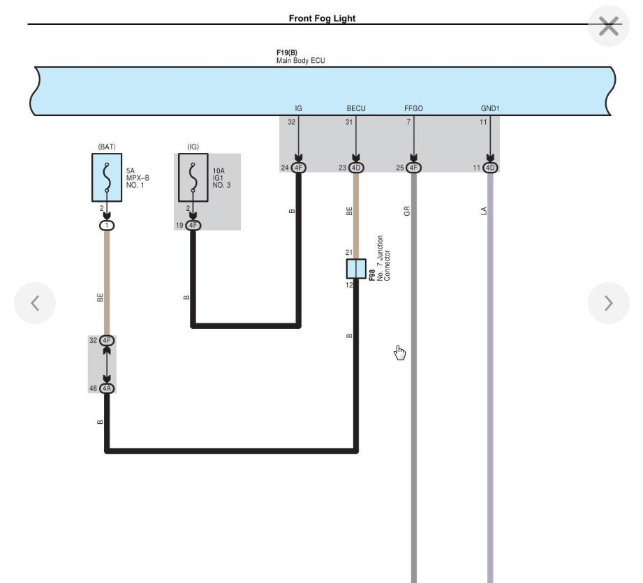

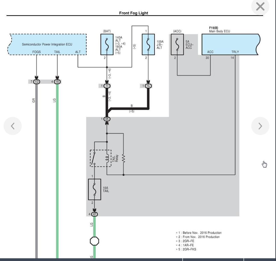

I have the vehicle listed above LE model. Electrical wise the remote start was installed. I also want to add fog lights. I've did a lot of research regarding fog light connectors. The majority indicated that it is pre-wired. The problem I'm running into is, I can't find the connectors. I've taken the liberty to physically install an after market kit, installed the multi-switch stalk with fog lights switch. I'm not bit of surprised that the fog light indicator didn't show up when turning on the fog lights switch. I would like for the fog lights to work if possible to work with the factory stalk.
Dec 25, 2019 at 5:46 AM
You may be able to install all the components but they will not work until you change the sales codes so that the ECU knows that there are fog lights installed. Unfortunately this day and age of vehicles, the computers are told how they are equipped and if they don't know that they have fog lights then the ECU (Body) it will never turn them on.
You will need to consult a dealer to see what needs to be done to complete this. Fog lights are probably pretty common so I am sure they will know everything that is needed.
