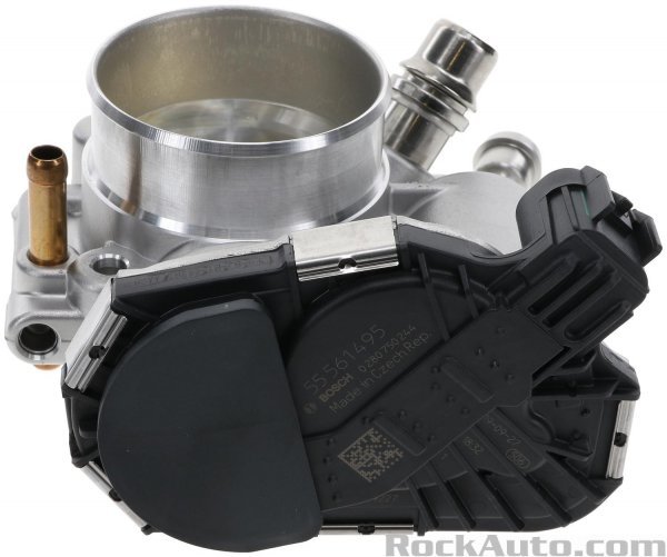

Around the mileage throttle body's go bad are usually between 60k to more. I am at the mileage to replace it anyhow. But i did not think i would damage it by removing it to clean it. Little did i know the cover would not have a throttle position sensor under there.
Here is a photo of what mine exactly looks like. If i was to replace it would this fix the issue? Also, for reference here is the throttle position sensor i bought from rock auto. But i honestly think it's no use for my vehicle.

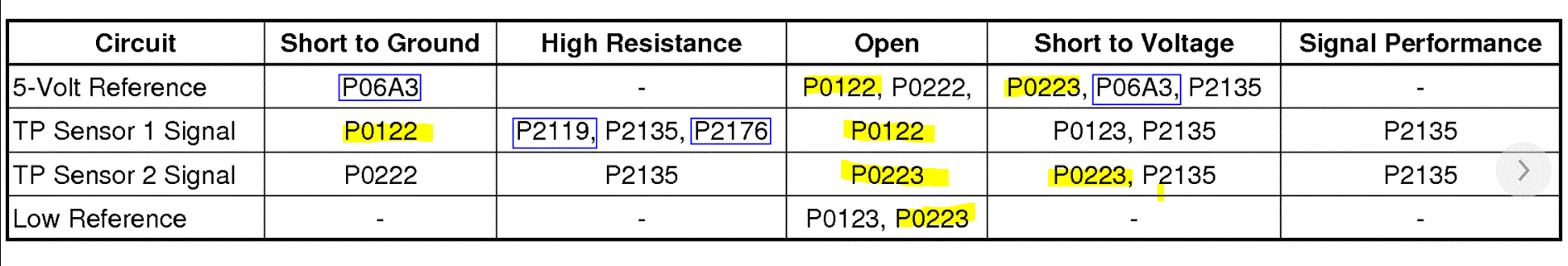

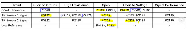

The codes are related to TPS 1 and TPS 2. I read through the codes, and something is wrong with the wiring. You may have an open circuit, short to ground, short to power.

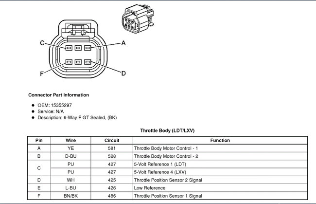

Remove the connectors and inspect the pins in both the TPS and the connectors. Make sure they are not bent or pushed in.
Next, check pin C for a 5v reference signal. If that is good, check pin E for ground. If that is good, check and make sure there isn't something causing an issue for pins D, E, F. They could be the issue if there is no contact or if they are damaged.
See pic 1 below. It indicates what could be the cause for these codes. If you look at pic 2 below, it shows the pin locations.

I was just wondering what you said (check pin E for ground. If that is good, check and make sure there isn't something causing an issue for pins D, E, F.)
I assume pin E would have to have a reading for ground, correct?
And I know you said pin c has to have ref voltage of 5v. But for pins D, E, F, what readings am I looking for? Sorry for the vague questions. Just trying to make sure I get the readings I need here.

No problem. Yes, pin c should provide approx. 5 v. Pin E is ground (low reference provided via the PCM) and the signal wires need to be checked with the TPS connected. You should see between 0v and 5v when moving the throttle from idle to WOT.
I hope that makes sense. Let me know if you have other questions.

I removed my throttle body in my car listed above (LT model) to clean the whole throttle body assembly. I might have damaged the throttle body because I try to open the electronic plastic cover and now it will not close tight with the metal tabs on it. I know now I did something wrong because after reinstalling the throttle body I got two codes p0122 and po223. The engine idles and shakes rough, and I can hardly accel the pedal driving. I checked all my work and made sure connections were clean and tight but now the computer cannot understand the throttle body, so I am getting these two throttle position sensor codes.
Should I just replace the throttle body? I think I damaged it because with an electronic throttle body you cannot open the throttle plate and pry open the plastic cover. Someone from A GM Dealer told me I had a throttle position sensor, but I do not because it's built in.

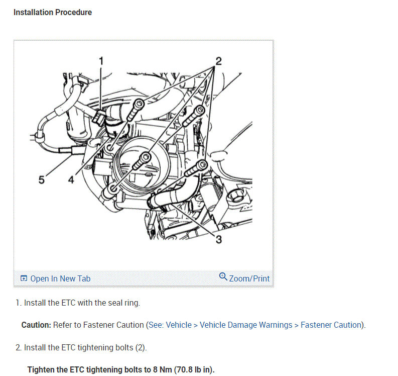

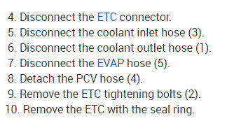

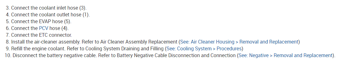

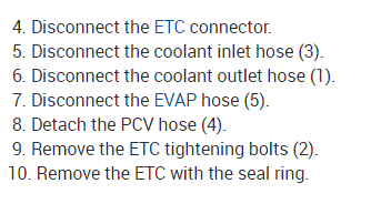

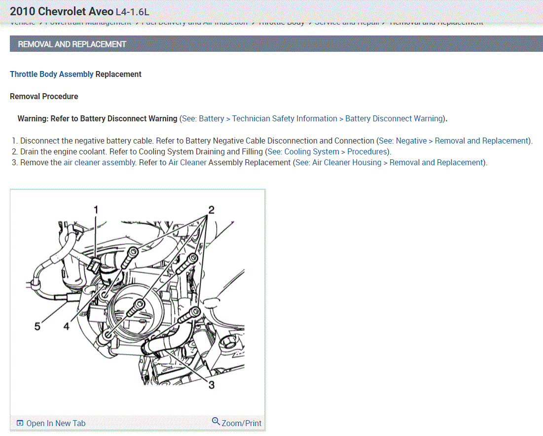

Did you read my response to the original post? If so, let me know. Also, there isn't a relearn procedure for this vehicle.
I attached the directions below for removal and replacement of the throttle body. If there was a relearn procedure, it would have been included in the directions.

Joe. The connector checks out fine and the wires are fine. I was able to get a reference voltage of 5v and the other pins were around 0v to 5v with the connector connected. I also checked the pins connected at idle with wide-open throttle. All are near the value you told me they should be.
I now think I might have damaged the throttle position sensor trying to take it off and the internal parts got bent inside. I cannot remove the sensor because it's tightly placed on the throttle body assembly. So, I assume GM built the TPS with the assembly so to replace the sensor I would need a throttle body assembly. Should I just replace it since all the electrical side checks out good?
Oct 24, 2021 at 9:15 AM
  • 110,194 POSTS
It sounds like the sensor itself is good, but if something was bent, that is likely where the problem is coming from. If everything electrical checks good, then I suspect it will need to be replaced. I don't like to make those decisions when I'm not there simply because the part isn't cheap.
