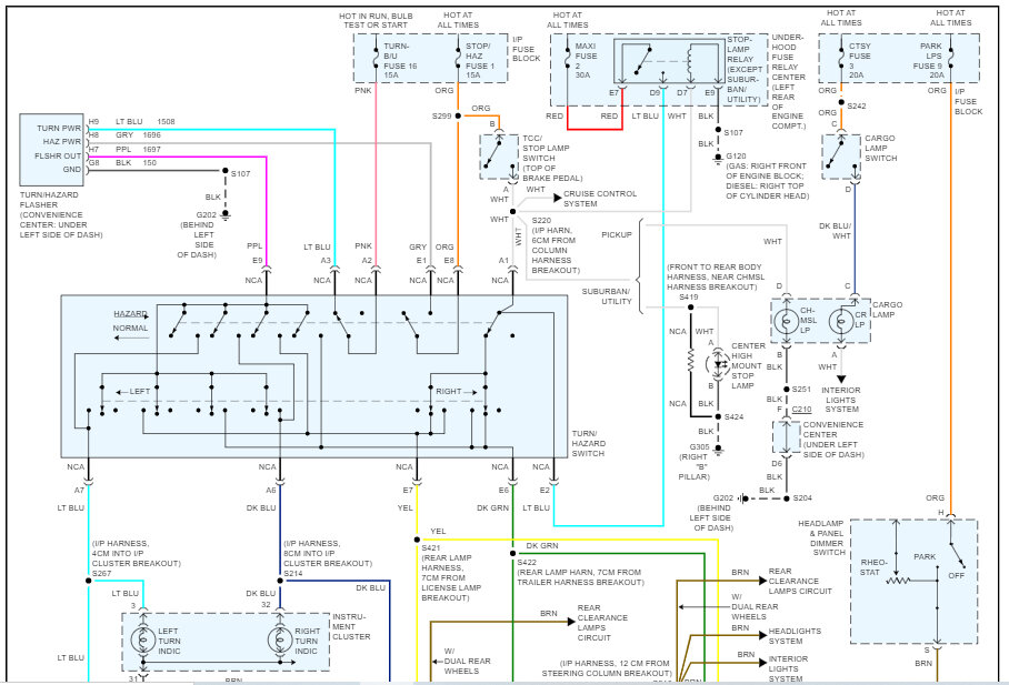

I need wiring schematic for box bed?
1997 GMC C1500
100,000 MILES
KARLA ZEN ART
I have some loose wiring down by the spare tire on the main rail on the left-hand side of the truck box and I’m not getting power to my rear. In need of schematics.
GMC 1997 k1500 5.7 Lt.
Mar 31, 2023 at 8:15 PM
  • 110,244 POSTS

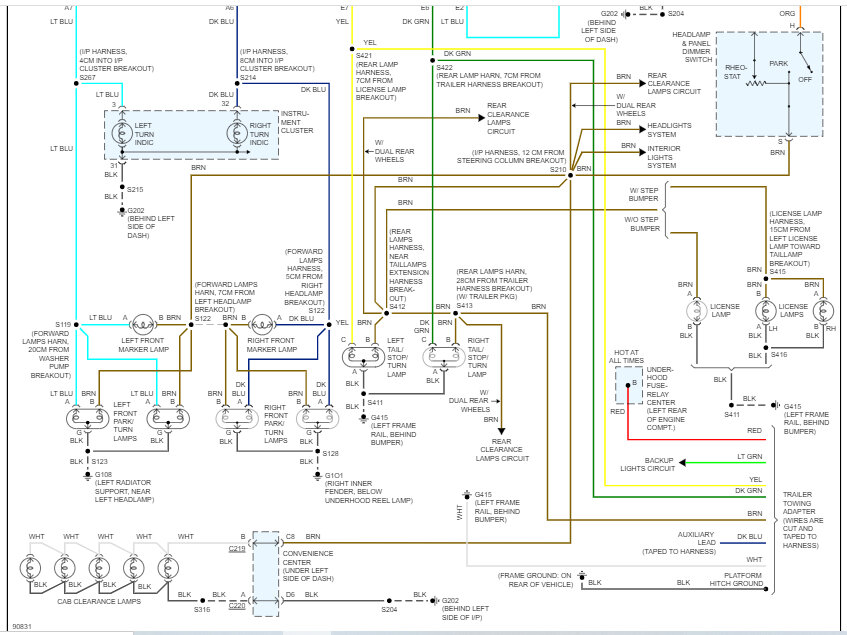

If it is an aftermarket box on the rear, the wiring may have been changed by the body company that installed it.
Take a look and let me know if they help.
See pic below.

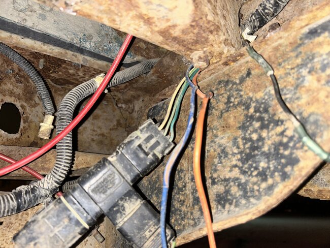

Hi, so i got all the ground wires connected on the box, but after i started the truck, it shorted out under my dash, and i have some ground points that have come loose and blowing fuses. I'm not sure where they go.
that is possibly my issue?
Apr 2, 2023 at 7:33 PM
  • 110,244 POSTS
What shorted under the dash? Also, are you certain that the wires you refer to are all grounds? Could you take a few pics and upload them for me to see?
