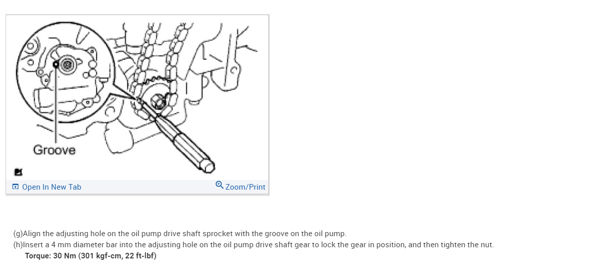

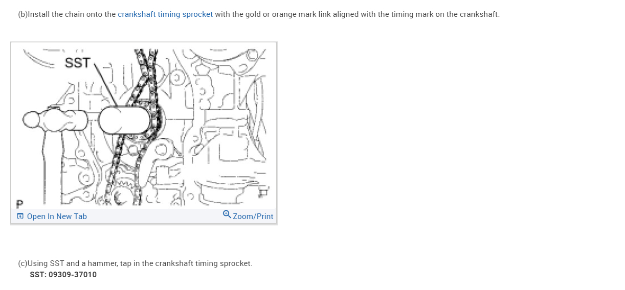

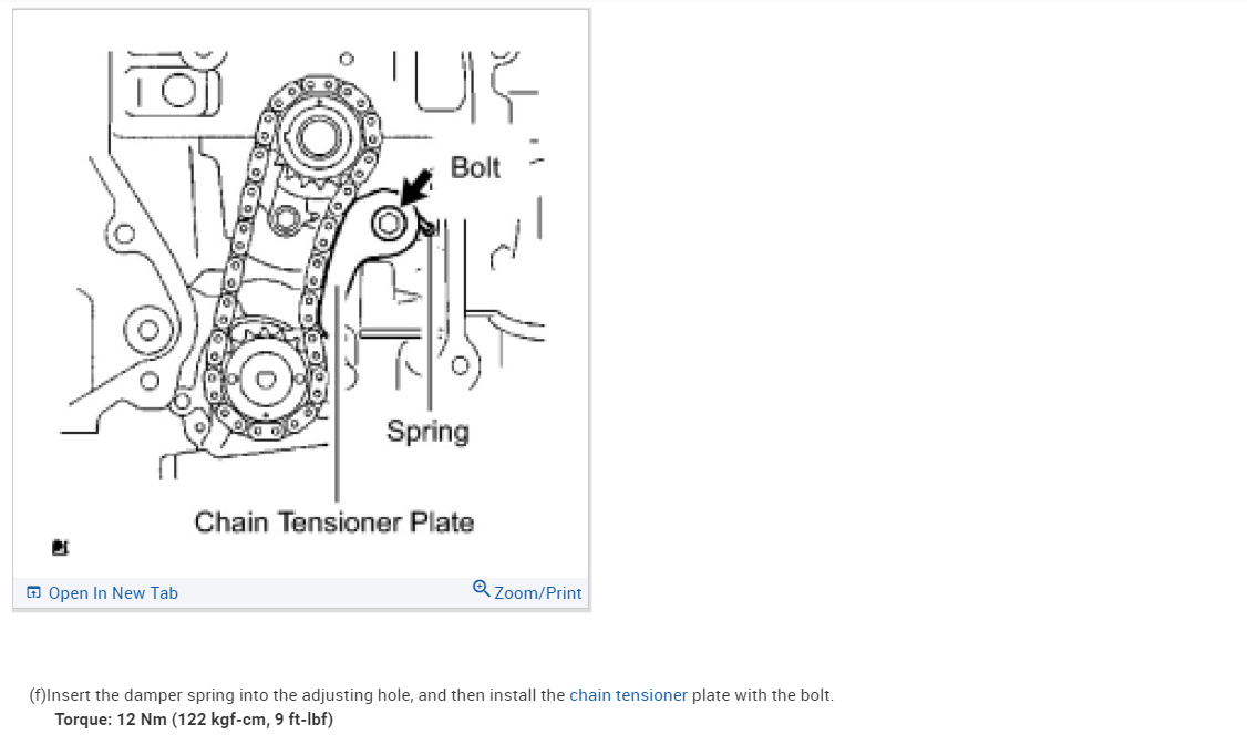

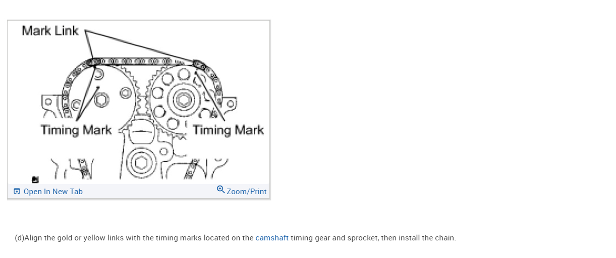

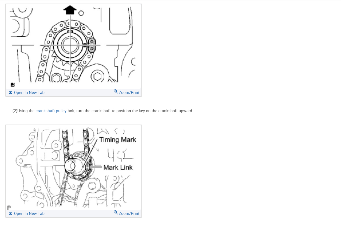

What is the timing order (marks)?
2008 SCION XB
134,567 MILES • 2.4L
JEFFHOLMES88

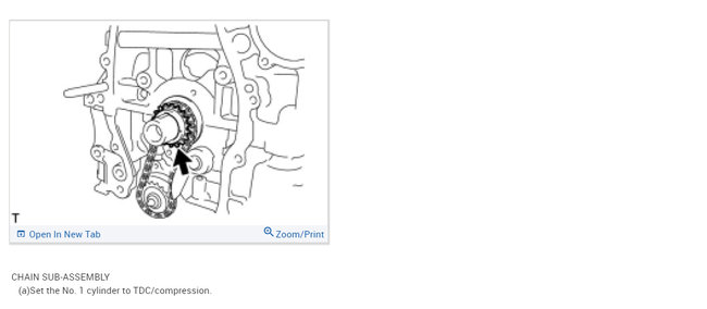

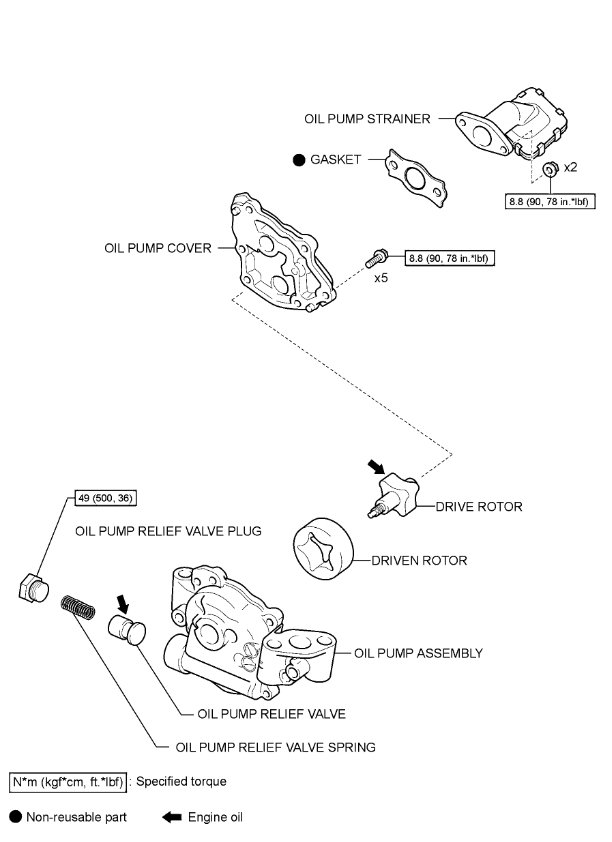

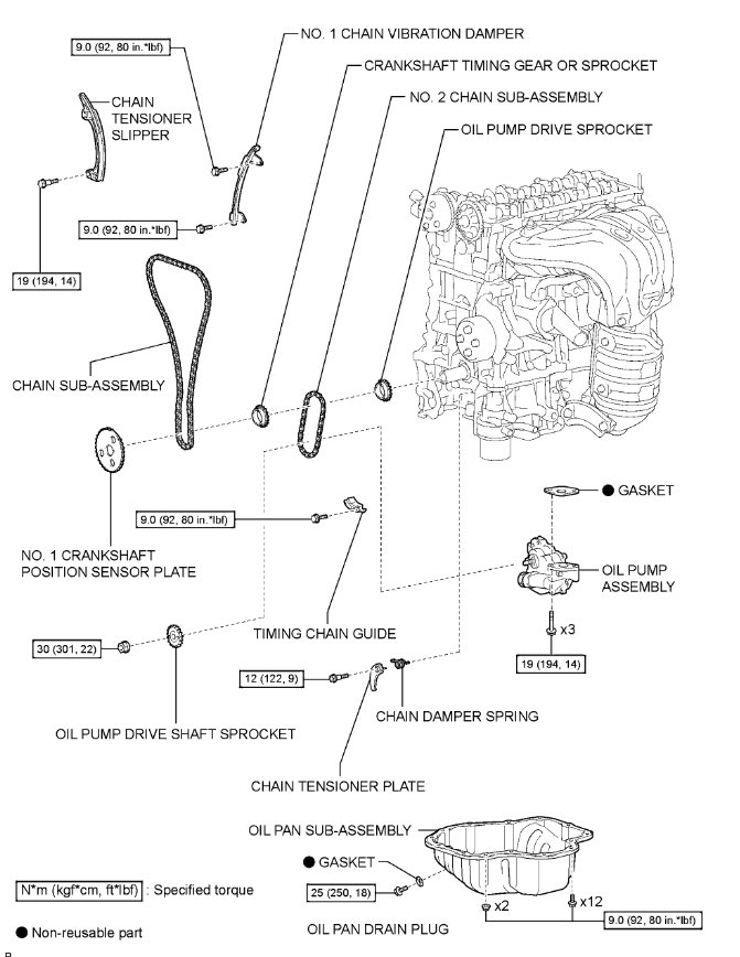

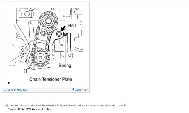

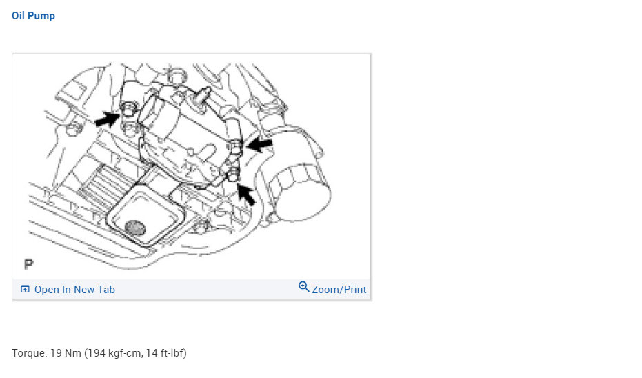

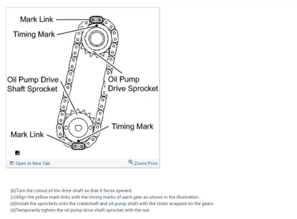

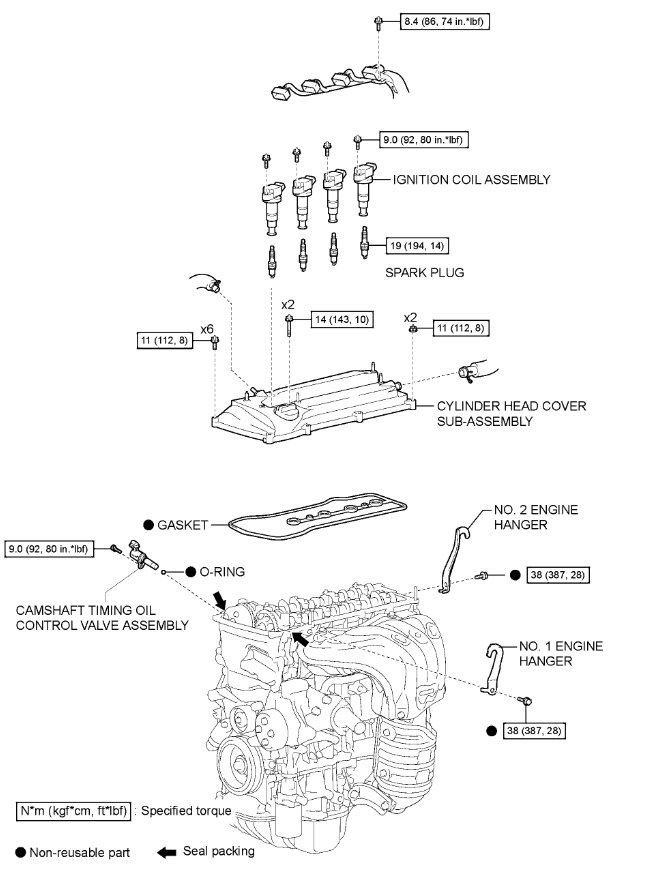

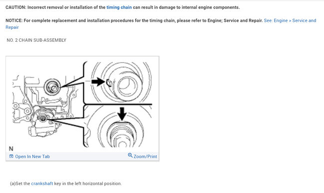

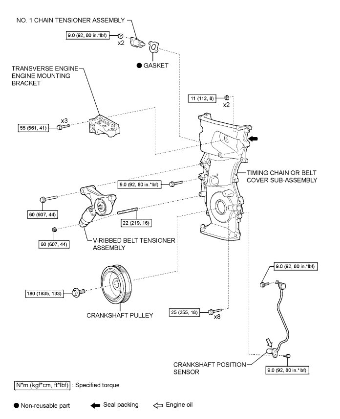

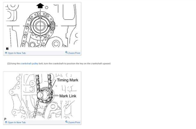

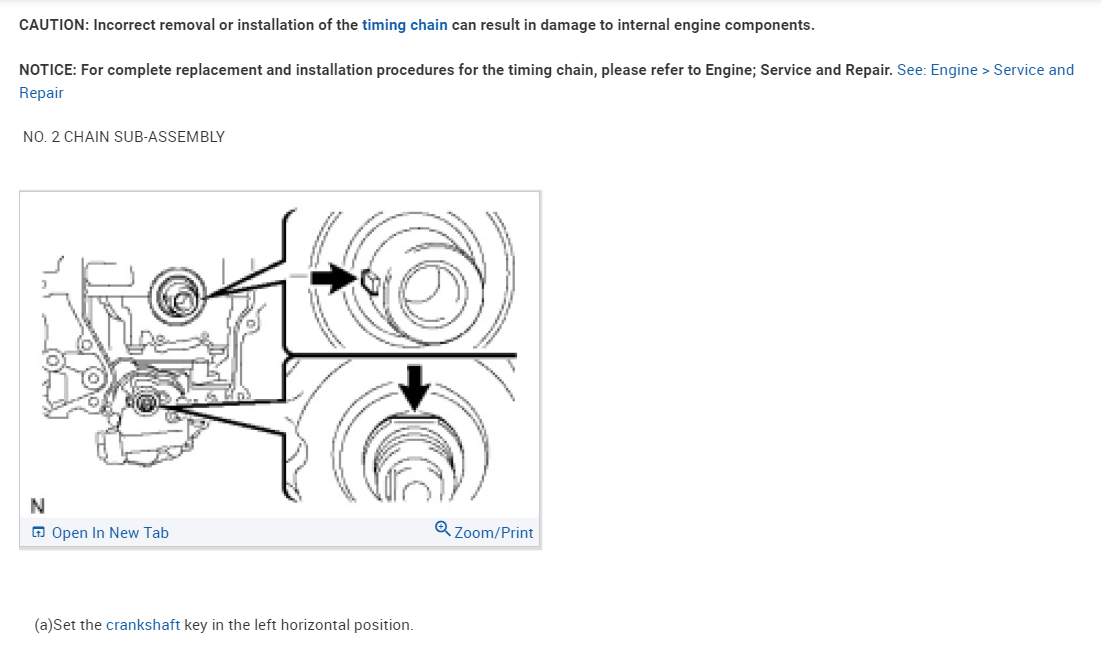

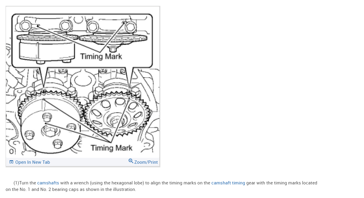

The oil pump went bad now i don't know how to time it.
Jul 31, 2022 at 8:39 AM
AL514
  • 5,662 POSTS
Hello, just make sure all the colored links on the chain are in the correct place before taking anything apart. Did you lose all oil pressure at some point?
