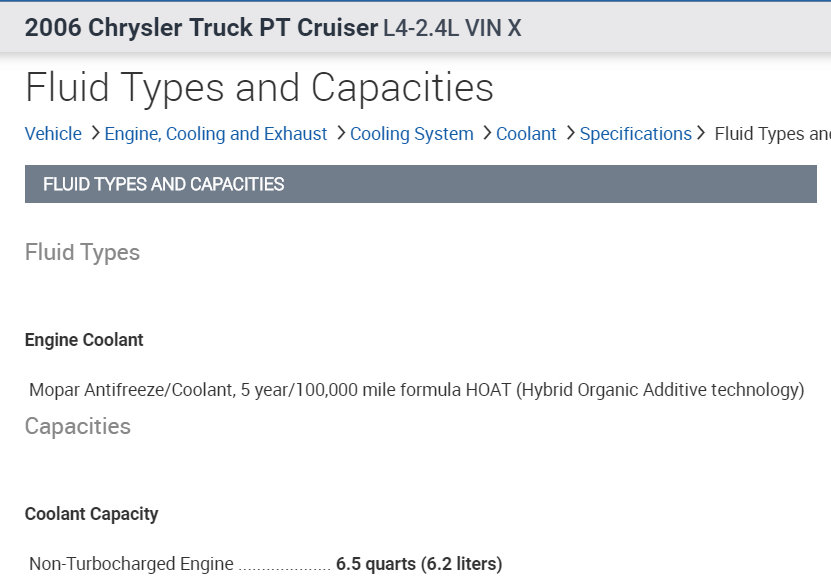

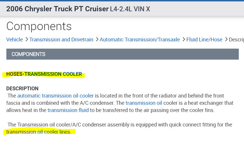

I need to know what the part name is and where exactly to buy these at
2006 CHRYSLER PT CRUISER
195,000 MILES • 2.4L
CANDACEISBIZARRE
  • 7 POSTS
I am replacing my.radiator and i need to buy a transmission line that goes to the radiator i guess but i cant find where to buy one at? Do you know what the part is exactly called and where to buy it at and how much? Also i need to know does it matter what kind of coolant i use to put back in my new radiator once i replace it with the new one can i just buy the dollar general cheaper coolant or does it need to be a certain kind or brand andhow many jugs of it do i need to buy?

The information that you requested is in the diagrams down below. Please go through the information in these guides and get back to us with how everything turns out.
