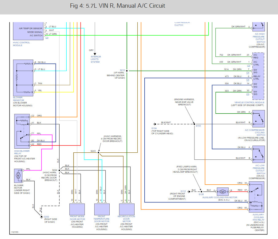

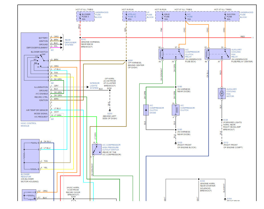

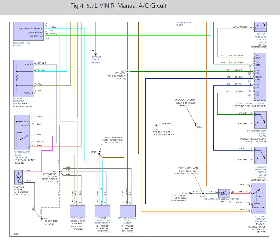

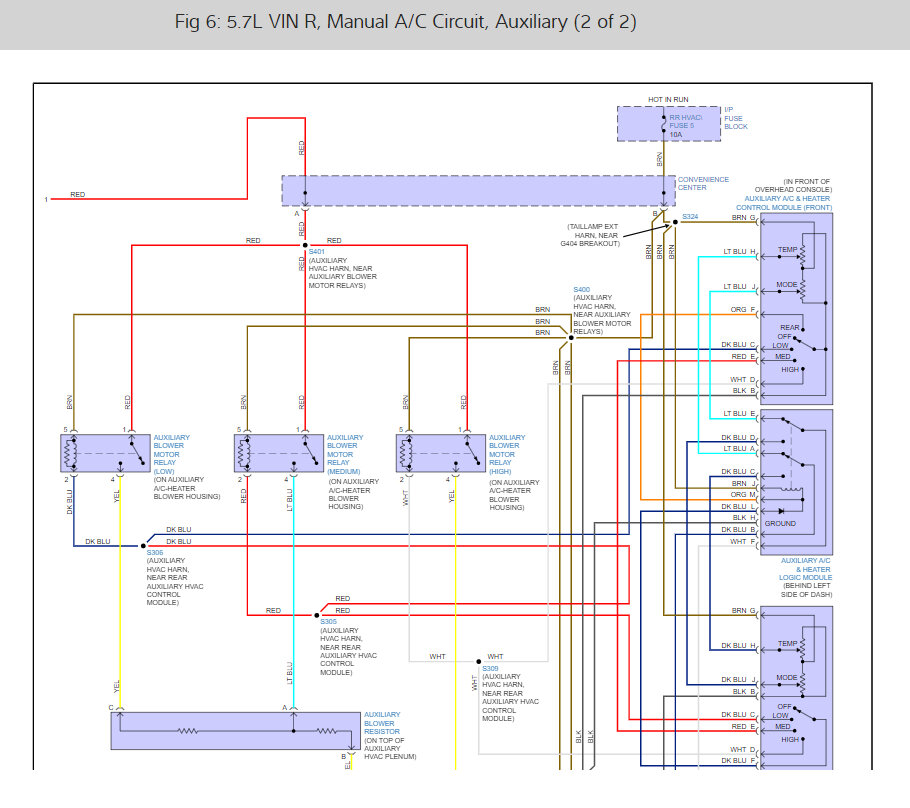

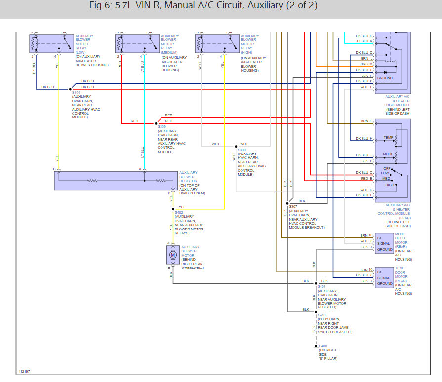

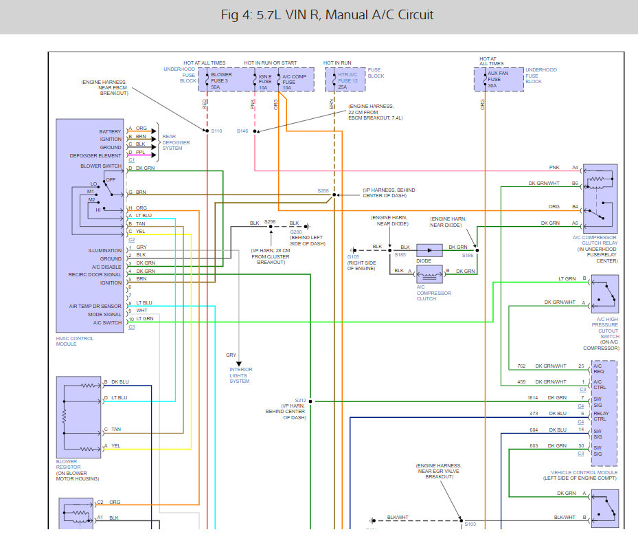

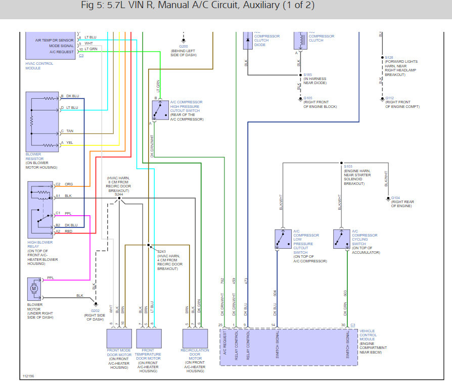

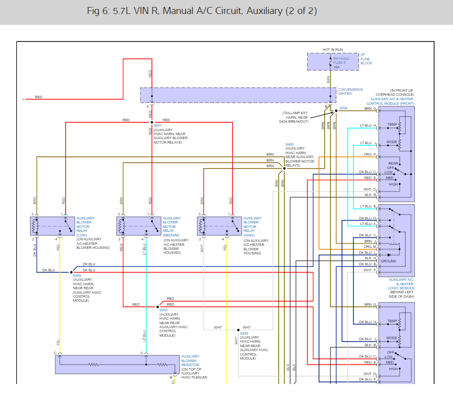

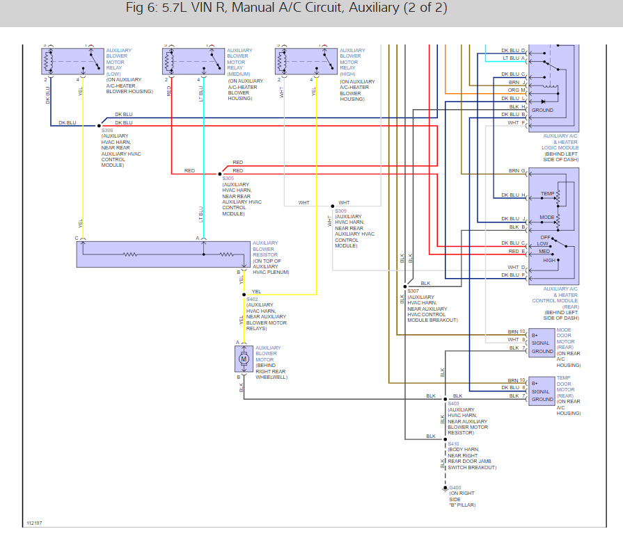

I also can't figure out why my dash lights are not working. I checked the bulbs. It's not them. It's not a fuse but the wire diagram for their climate control would be really appreciated because I can't remember exactly what I did last year but there was a way that connected, and it was for the heat and it worked and now I don't know which one to do. Thank you
Oct 29, 2022 at 2:38 AM
  • 55,837 POSTS
Here are the wiring diagrams for the HVAC system and a guide to help you check the connections:
Check out the images (below). Please let us know if you need anything else to get the problem fixed.
