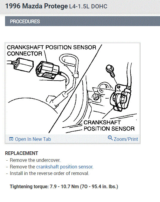

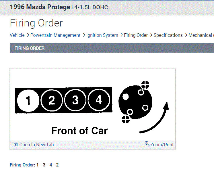

I'm not getting no fire to start my car. I need the firing order. i need to know what the two top spark plug wires are on the distributor and plus I'm not getting no fire.

If you look at pic 1, it shows the firing order, cylinder orientation, and the rotation of the distributor rotor.
Now, if you have no spark, do me a favor. Check to see if there is an RPM signal. If the vehicle has a tachometer, see if it is moving at all when cranking. If you have a live data scan tool, see if there is an RPM signal.
IF you find there is no signal, chances are the crankshaft position sensor has failed. IF you look at pic 2, it shows the directions and location for removal and replacement.
Here are a few links you may find helpful as well:
https://www.2carpros.com/articles/how-a-crank-shaft-angle-sensor-works
