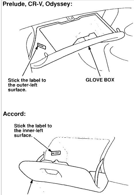

I'm trying to get the anti-theft code to put in to the radio so I can make it work again. When I tried to turn the radio on it says error anti-theft engaged.
Apr 6, 2021 at 3:22 AM
STEVE W.
  • 15,330 POSTS
If you changed the battery and the theft lock engaged you can try the onboard reset. Press and hold the radio power button for at least 2 seconds, this will usually reset the unit so it turns on.

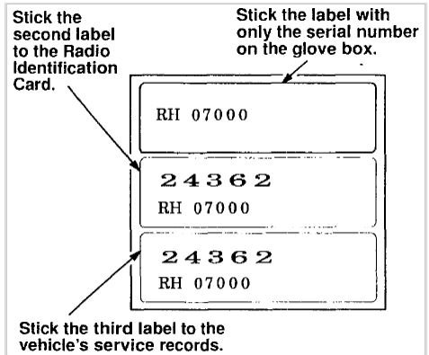

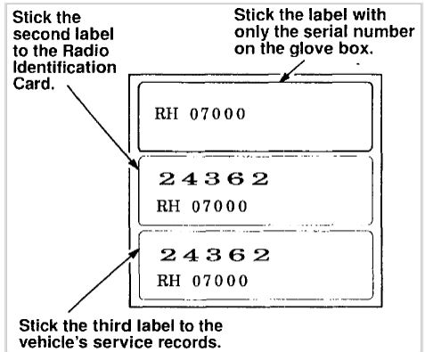

If however that doesn't work and you cannot find the code written in the owners manual or on a sticker stuck inside the glove box on a sticker like the image shows (the RH number would be the serial number and the sticker with two numbers is the serial number and code, if you find that sticker you turn the key on, turn the radio power on and enter the code using the radio preset buttons) you will need to do one of two things, the easiest is to visit a dealer, you will need the registration for the car and ID showing you own it. They will then call in and get the correct code.
