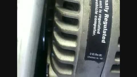

My oil light keeps coming on and when it does a few minutes later a loud sound under hood appears. Faster you go louder it gets. i replaced 4 deactivation solenoids as well as all the spark plugs. When my oil light comes on that means the noise under hood is coming next.. the faster i go it sounds like it's going to explode.

You have an oil pressure issue. When the light comes on, the pressure is either low or not there at all. That is the noise. The engine bearings are not being lubricated and the noise is damaging the motor.
https://www.2carpros.com/articles/engine-noises
At this point, you have damaged the engine driving it this way.
Did anyone do a manual oil pressure test?
Most likely you are going to need the engine replaced.
Can you upload a video of the noise?

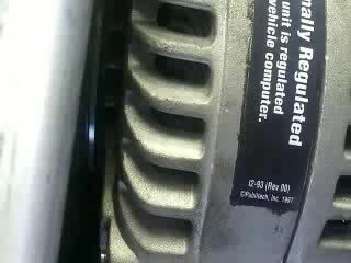

This is the sound it makes:
Apr 2, 2020 at 4:16 AM
That is an internal engine noise from the bearings and lifters. It comes from the lack of oil pressure.
I would stop driving immediately and have this addressed and repaired before it leaves you stranded and the engine locking up.
