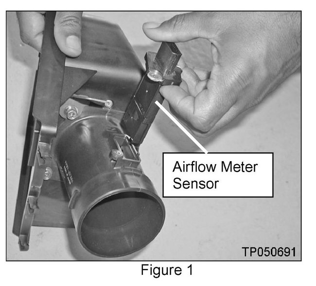

My car is listed above it is a gcc spec. The first problem is sometimes my car at idle turn off I computer check and found MAF sensor fault. I replaced it with new original and it was okay. Now after one month again the same problem came. The second problem is my car temperature is sometimes fluctuate up and down on highway speed 100 km/h I changed the thermostat before original it was okay, but after one month same problem come again. I changed the radiator cap and while touching the hose upper and lower they do not seems to be that hot.

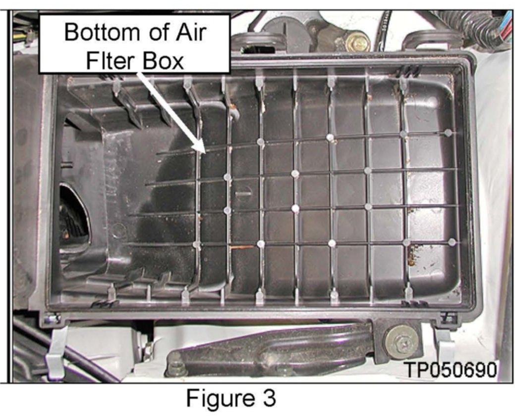

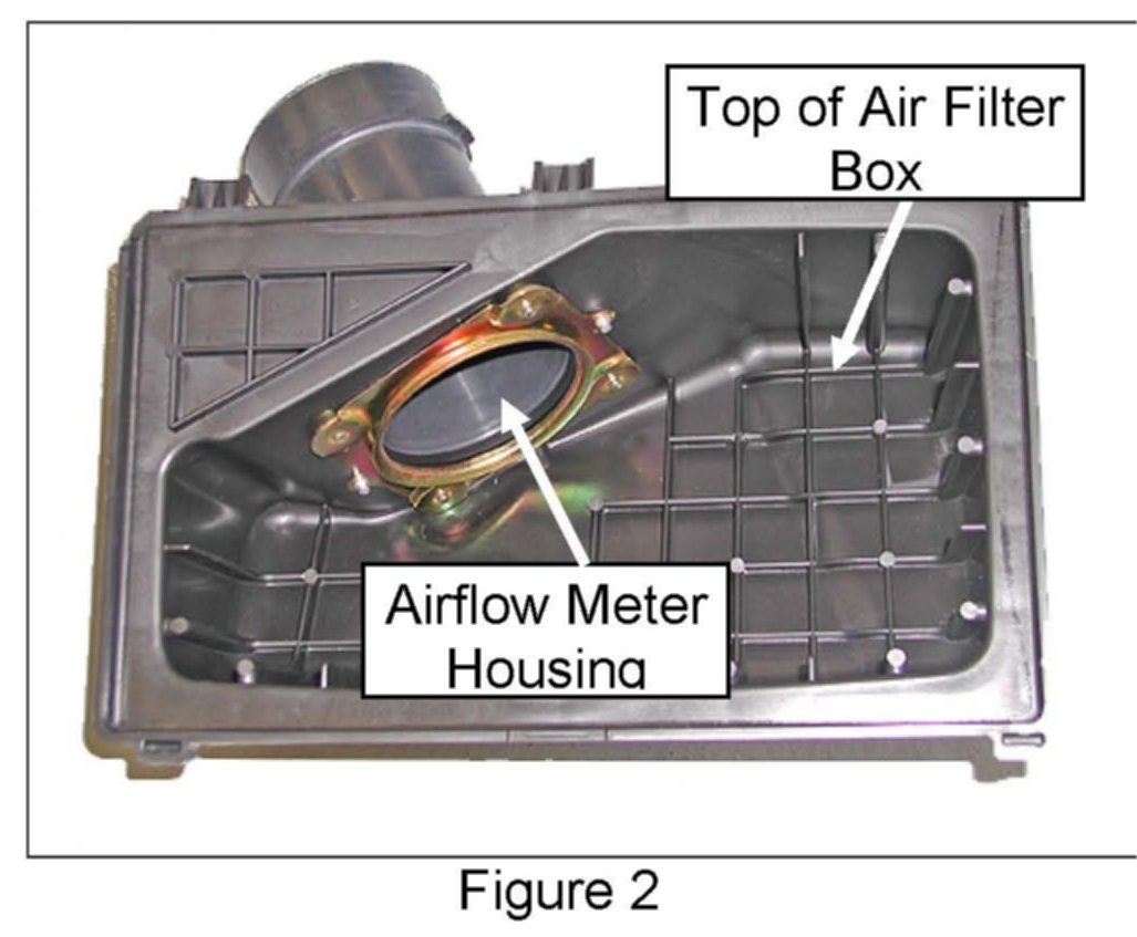

Here are the directions for removal, servicing, and replacement of the component. I have also added pictures specific to your vehicle.
SERVICE PROCEDURE:
1. Remove the top of the air filter box with airflow meter assembly from the vehicle
2. Remove the airflow meter sensor from the airflow meter housing.
^ It's held on with 2 T20 Tamper Resistant Torx(R) screws.
3. Thoroughly clean the air filter box and the airflow meter housing.
^ Wipe out the entire inside area of the airflow meter housing with a clean rag (see Figure 2).
Use low-pressure compressed air or a shop vacuum to clean out all dust, dirt, and debris from inside both halves of the air filter box and inside of the airflow meter housing (see Figures 2 and 3).
CAUTION:
^ Cover the ducting from the throttle body with a clean shop towel or other method so dirt or debris cannot enter the engine intake manifold.
4. Install the new airflow meter sensor into the old airflow meter housing (see Figure 1).
^ Do Not replace the entire airflow meter housing; replace only the sensor listed in the Parts information.
^ Tighten the screws to 1.2 - 1.8 N.m (0.12 - 0.18 Kg-m, 11 - 16 in-lb)
5. Reinstall the top of the air filter box with the airflow meter assembly back into the vehicle with a new Genuine Nissan air filter.
