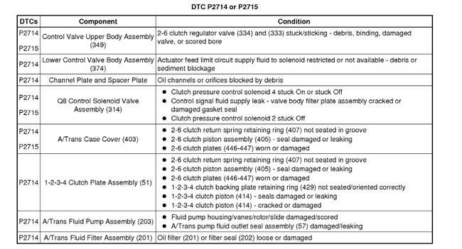

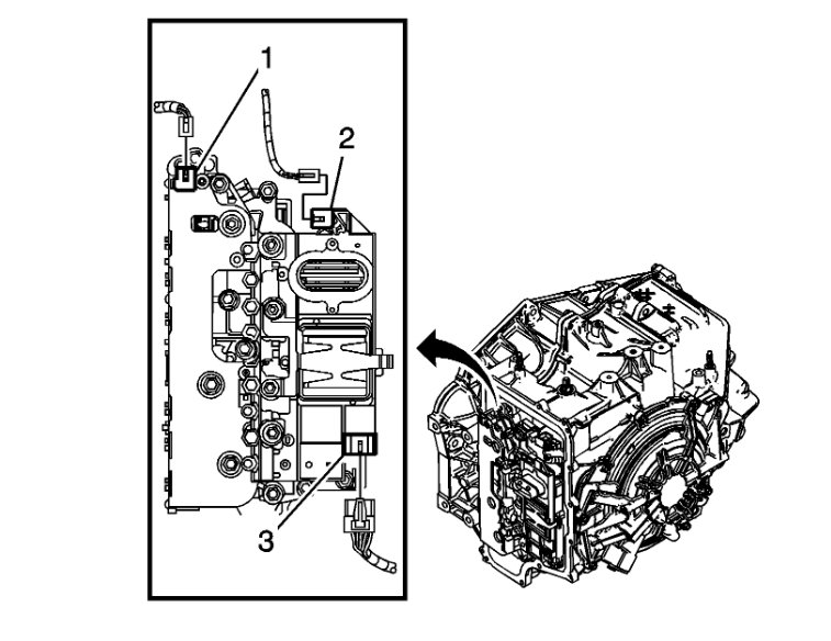

I have transmision code p2714
2012 CHEVROLET TRAVERSE
76,452 MILES • 3.6L • V6 • 2WD • AUTOMATIC
AGEL
  • 40 POSTS
I would like to know were the pressure solenoid D is located and if i could get transmission plug wiring diagram?

The code is for the clutch pressure solenoid number 4 in the transmission. It is part of the valve body itself. I posted below the flow chart for the code.
DTC Descriptors
DTC P2714
Clutch Pressure Control (PC) Solenoid 4 - Stuck Off
DTC P2715
Clutch Pressure Control (PC) Solenoid 4 - Stuck On
Circuit/System Description
The clutch pressure control (PC) solenoid 4 is part of the control solenoid valve assembly which has no serviceable components. The PC solenoid 4 regulates transmission fluid pressure to the 2-6 clutch regulator valve which controls pressure to the 2-6 clutch. The transmission control module (TCM) calculates gear ratio based on the RPM signals from the input speed sensor (ISS) and the output speed sensor (OSS). The TCM compares the expected transmission gear ratio to the calculated gear ratio for each commanded gear.

Conditions for Setting the DTC
P2714
TCM has detected an incorrect gear ratio or neutral condition when the 2-6 clutch is commanded ON. This condition must occur 3 times.
P2715
TCM has detected an incorrect gear ratio change when the 2-6 clutch is commanded OFF during a shift or, when 2nd gear ratio is detected in 1st gear. This condition must occur 3 times.

1. Verify the transmission line pressures are within the ranges specified in the Line PC Solenoid Valve Pressure table. Refer to Line Pressure Check See: Automatic Transmission/Transaxle > Component Tests and General Diagnostics > Line Pressure Check and Solenoid Valve Pressure See: Automatic Transmission/Transaxle > Mechanical > Solenoid Valve Pressure.
If line pressures are not within the specified ranges
Refer to Fluid Pressure High or Low See: Automatic Transmission/Transaxle > Symptom Related Diagnostic Procedures > Fluid Pressure High or Low.
If line pressures are within the specified ranges
2. Ignition OFF, remove the Q8 control solenoid valve assembly. Refer to Control Solenoid Valve and Transmission Control Module Assembly Replacement See: Control Module, A/T > Removal and Replacement > Control Solenoid Valve and Transmission Control Module Assembly Replacement.
3. Perform the Control Solenoid Valve and Transmission Control Module Assembly Solenoid Performance Test See: Automatic Transmission/Transaxle > Component Tests and General Diagnostics > Control Solenoid Valve and Transmission Control Module Assembly Solenoid Performance Test. Test all solenoids on the Q8 control solenoid valve assembly. A pressure change should occur for each solenoid valve.
If a pressure change does not occur for each solenoid
Replace the Q8 control solenoid valve assembly.
If a pressure change occurs for each solenoid
4. Listed in the table below, are conditions for each component that could set DTC P2714 or P2715. Carefully inspect each component for that condition. Repair or replace as necessary.
