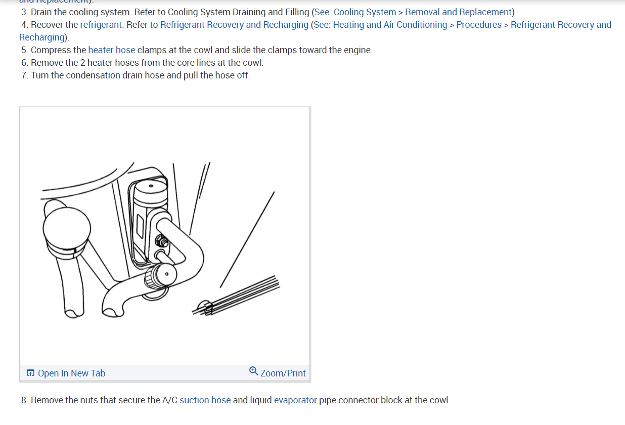

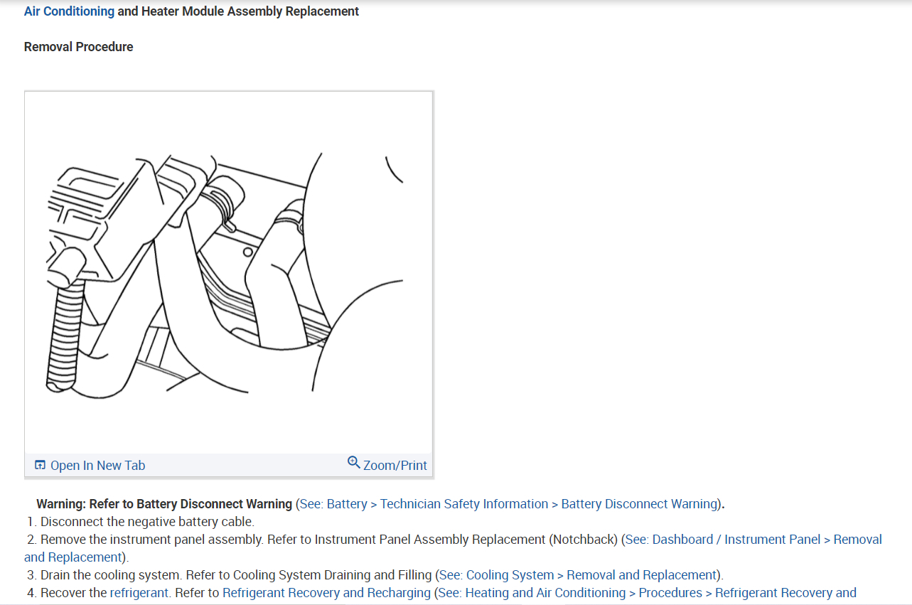

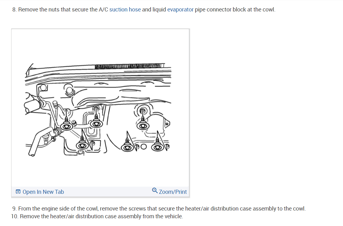

Hi, i was wondering i you have found any solution to our problem? I have tried countless times to glue it but failed multiple times. I believe as you know the space is really restricted and i was wondering if there was any other solutions.But I've mentioned to re-position it in a certain way so the air flow resumed again. Thank you for your time!
Car listed above is an LS model.
Jul 31, 2021 at 9:25 PM
Good morning,
Can you post some pictures of the damage you have so I can see what is the actual issue?
You may have to remove the heater case to either repair it or replace the heater case.
I attached some pictures of the removal for you to view.
