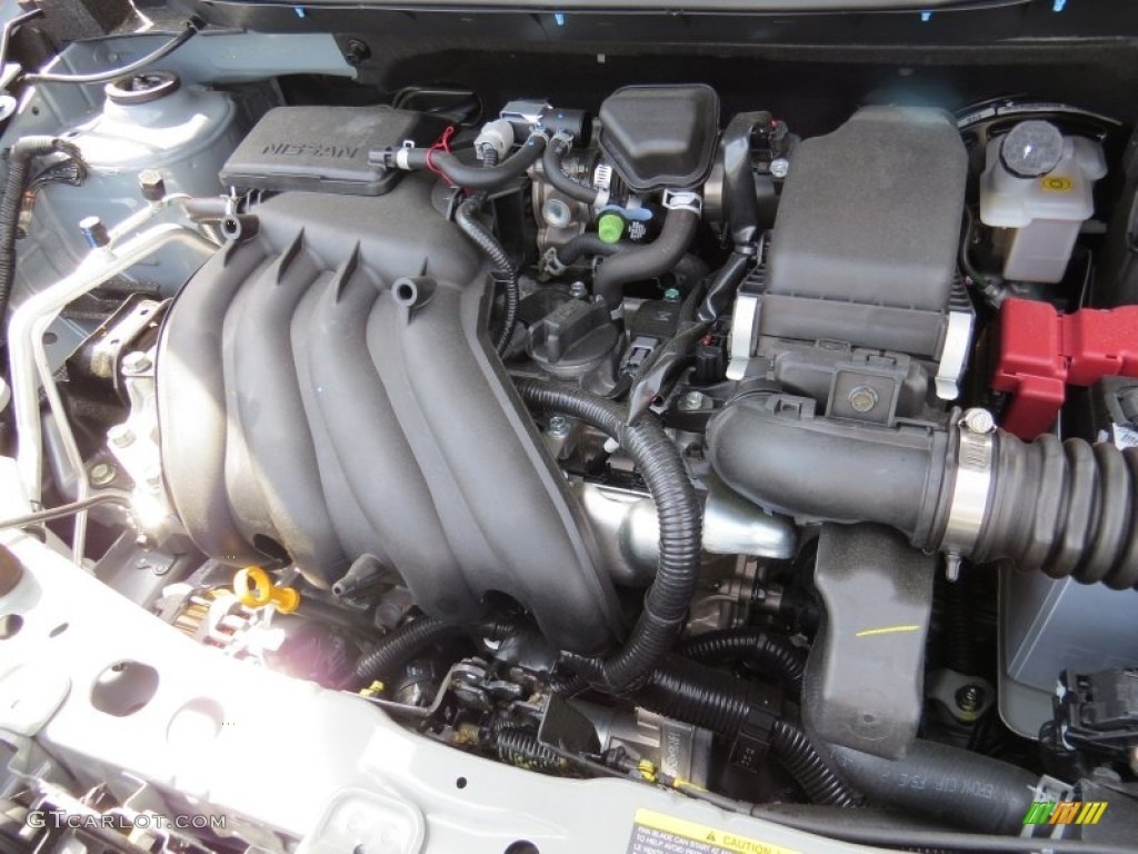

I have questions about some weird items I see in the engine compartment?
2014 NISSAN VERSA
87,000 MILES • 1.6L • 4 CYL • 2WD • AUTOMATIC
ALEX STATHAS
  • 71 POSTS
What is the tiny red wire that is wrapped around the vacuum hose that connects on top of the intake manifold where the Nissan label is located, and the other end of that vacuum hose connects to a thing on top of the throttle body with an electrical connector on its left side. So, what is that thing or sensor and what does it do? Also, that thing has a smaller vacuum hose on its right side and that vacuum hose has a tiny green cap on the other end so what is that tiny green cap and what does it do? Also, I see an electrical connector right next to the air filter housing and I don't know what it is for, I see that the oil filler cap has no gasket on it, is that okay? and why is the ignition coil next to the oil filler cap labeled M on top of it and what does the M stand for? I supply an image to make the above questions easier to answer as I can see this image on my desktop all the time and I cannot identify the above parts, thank you very much in advance for helping me identify the above parts on my desktop computer image which I will post below.
Apr 5, 2023 at 1:27 AM
BRENDON S
  • 653 POSTS
Good morning, ALEX STATHAS
The vacuum line with the green cap is actually a test port for your Evaporative Emissions System or EVAP for short. This is where you would put a smoke machine to test for a leak in the EVAP lines.
The thing on top of the throttle body with the 2 hoses going into I believe is the Canister Purge Valve for the EVAP System. This valve only operates when the engine is running and up to operating temperature. The PCM will send an electrical signal to open the valve and allowing fuel vapors from the EVAP canister to be burned in the engine.
The connector next to the air cleaner looks like it is a Mass Air Flow Sensor. This one probably has an Intake Air Temp Sensor built into it as well.
As for the "M" on the ignition coil, I'm not sure. Maybe someone was trying to diagnose a misfire condition?
The red wire doesn't look like it goes to anything. Can you follow it and see where it goes? It almost looks like it is holding up the harness that goes to the Purge Solenoid, maybe they broke that clip whoever was in there.

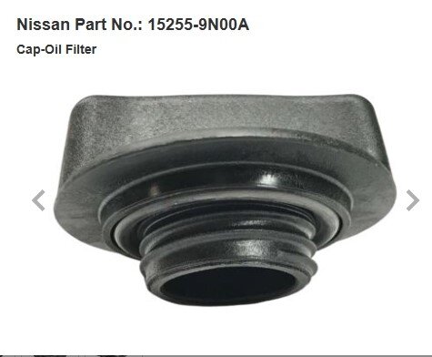

The oil cap should have an O-ring on it. I have added a picture of it for you. If it doesn't just grab one from the dealer it should be under $10.00.
Here is the part number:
161193AN1D
Hope this helps.

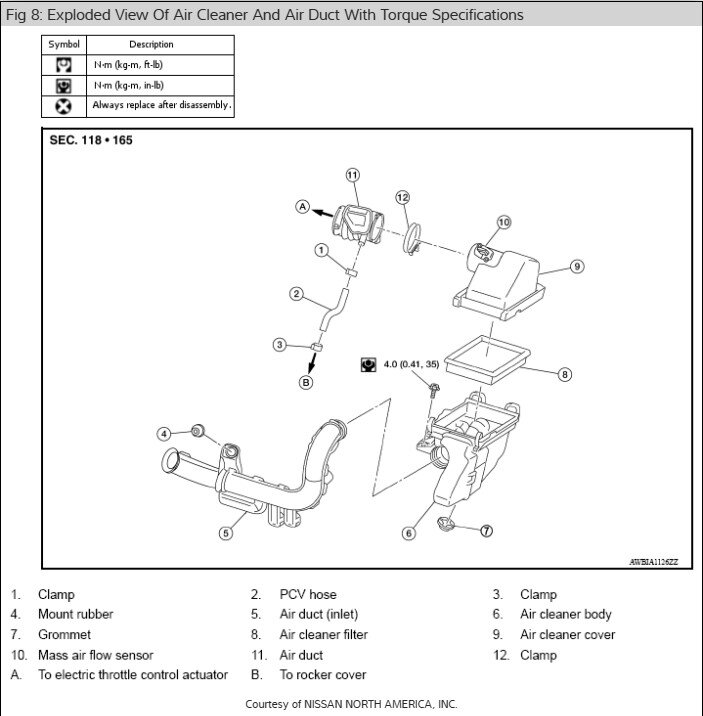

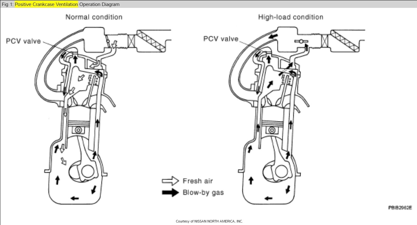

Hope you are doing well. According to my information this is part of the Positive Crankcase Ventilation or PCV system of the engine. It removes blow-by gases that are built up in the engine using engine vacuum sucking them into the combustion chamber where they are burned. It is part of emission control but also keep gaskets and seals from blowing out from the pressure in your crankcase as well as preventing sludge build up. This area doesn't have the valve. The PCV valve on your engine is on the passenger-side of your valve cover. Intake air is drawn into the valve cover and through the PCV valve on the opposite side of the valve cover under normal operating condition. Under high load conditions it uses both to draw gasses out of the engine.
I have added a couple pictures for you.

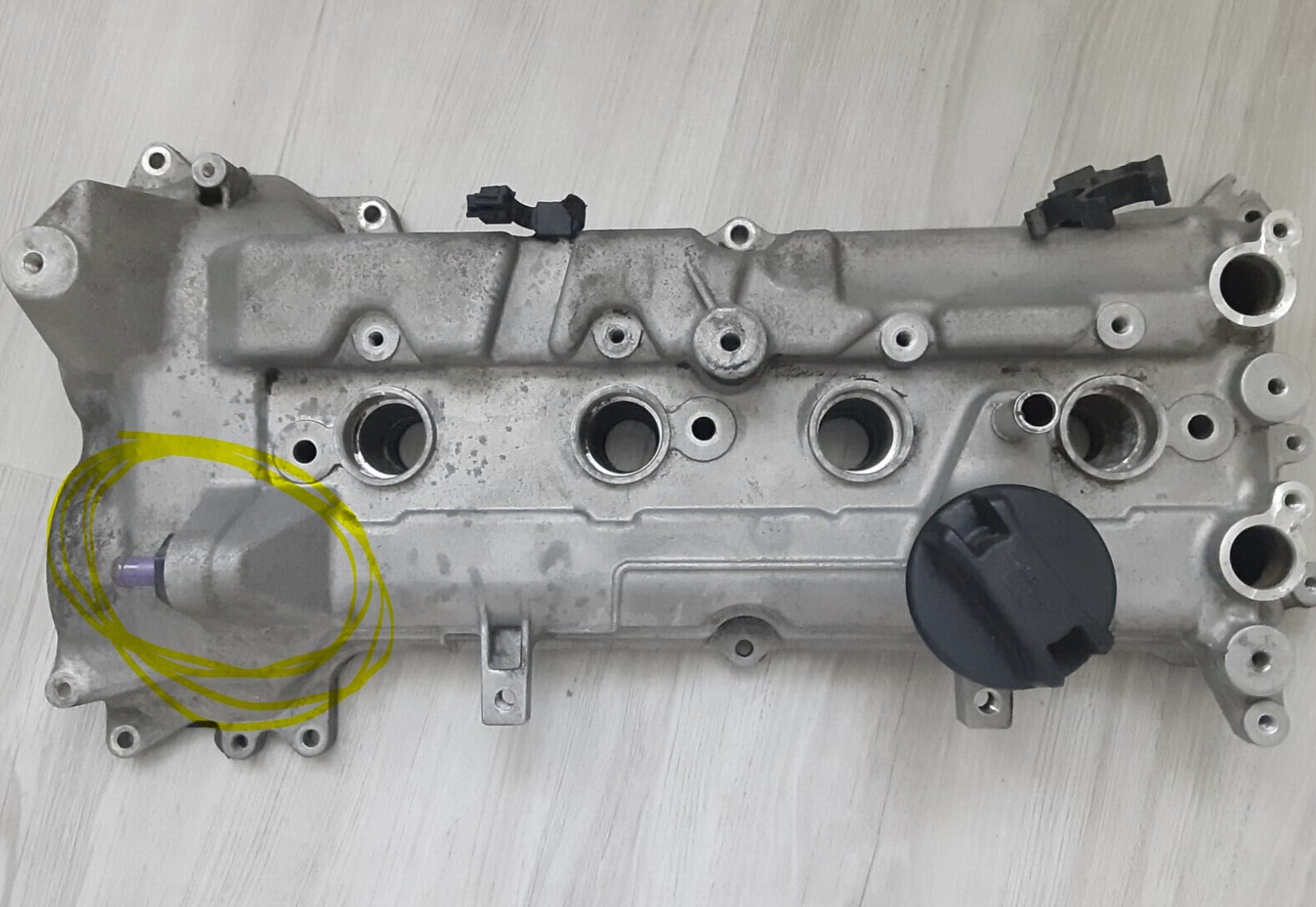

Thank you for informing me Brendon S. as I had mistakenly thought that the large vacuum hose between the throttle body and air flow sensor was pushing air to the valve cover, now I know that this vacuum hose draws blow-by gases from the crankcase and PCV valve to the engine intake manifold plenum runners, and the PCV valve is located on the opposite side of the intake manifold on the lower side of the intake manifold which is not visible on this bing images website photo that I have on my desktop background or desktop wallpaper, I actually saw this PCV valve on our car and it's a little blue item located just above the intake and exhaust variable valve timing solenoids which also are not visible on the internet photo, we do 3 month or 3,000 mile bulk synthetic oil changes at Walmart but we only put 2,000 miles in 3 months on our engine so we do it at 3 months because they come first before the miles, I am wondering can a clogged PCV valve cause the engine to seize up and will our frequent regular bulk synthetic oil changes help the PCV valve last longer? and if the engine seized up how much would a used engine cost to have installed and can the cost be financed and if the used engine is running with noise will Walmart refuse oil changes due to the noise and force us to go to Mobil 1 Lube Express which wants 5,000 mile oil changes? Thank you very much in advance for your information Brendon S. Alex Stathas
Apr 7, 2023 at 3:23 PM
BRENDON S
  • 653 POSTS
Hello ALEX STATHAS,
So, your close the PCV Valve is located on the passenger's side of valve cover I have included a photo for you. Under normal driving conditions you were correct, air does go from the intake to the valve cover and exit through the PCV Valve on the passenger's side of the valve cover and travels back to the intake via another hose. However, when under heavy load conditions such as wide-open throttle sometimes referred to as WOT, gasses are sucked into the intake using both hoses.
For the oil changes. Nissan recommends every 5,000 miles so doing it sooner is really good for your engine. It keeps it clean and running at its best. I have an Altima myself I change the oil every 3,000 miles or 3 months as well. To me 5,000 miles is too much. I have seen Ford's that the oil gets changed every 10,000 miles. To me I don't see how this is a good idea.
The PCV System relives crankcase pressure. Without it, it will cause oil leaks by pushing out seals and gaskets. It also can increase oil consumption by allowing oil to enter the engine and be burned. This can lead to performance and fuel economy issues. It can also cause sludge to build up on the valves and pistons, put stress on bearings and build oil up in cylinders causing a misfire. So, it can cause an issue and it is possible it could seize up the motor, eventually but more indirectly.

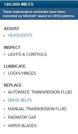

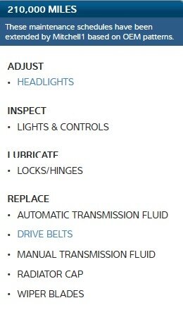

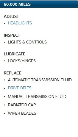

I will say that with the extra hose that the system has if your PCV valve gets clogged the gasses will still be drawn into the intake and burned. Also, you would notice things like oil leaks, poor performance, and fuel economy dropping if it is clogged.
Best advice I can give is keep up with your maintenance and drive it like a Cadillac. Nissans are very well-made vehicles in my opinion. I own a 2018 Altima; I do all my own service on time and have never had one issue with it. I am at about 87,000 miles. We have driven to Memphis, Key West, New York. Longest drive was 36hrs non-stop and the car was perfectly fine.

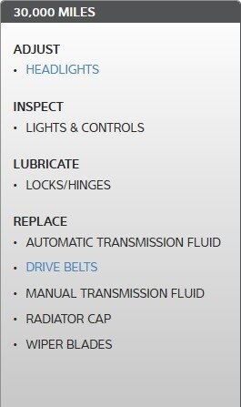

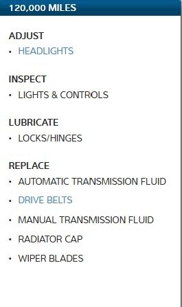

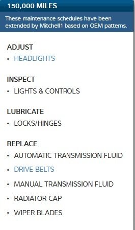

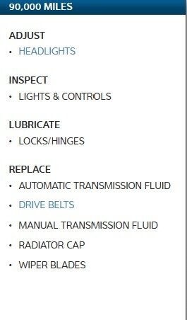

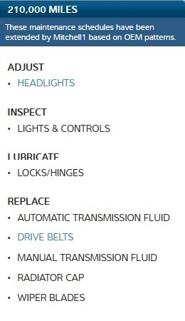

I am adding the maintenance schedule for your vehicle for you. Just so you can keep an eye on things. You should be able to find this in your service manual as well. You can have these items done earlier than what the listed mileage says on these. This is just to help make sure nothing is missed and keep your vehicle running at its best.

Oh, it's no problem at all, you're not being nosey. I have never changed my PCV valve. Most dealerships will put it in for free if you are there getting an oil change you just got to pay for the part they should charge labor. It is a very easy job takes about 5 minutes. I do have an O-ring on my engine oil cap. I have not noticed any sludge at all, but I also do my oil changes early. Every 3,000 or 3 months whatever comes first. Nissan recommends every 5,000 miles but I won't wait that long. The car runs great. I have had no issues. I am going to do my plugs soon so I will probably change out the PCV at that time. The part is around $10 or so. It definitely wouldn't hurt if you did it at your next oil change.
I am adding a picture of what your oil cap should look like.

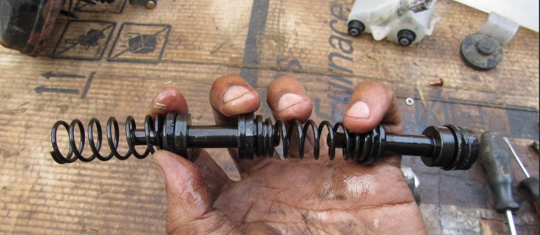

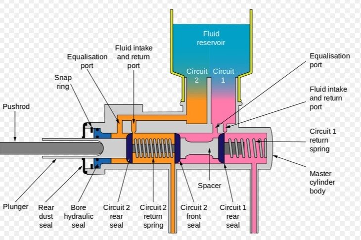

what does the brake master cylinder housing underneath the brake fluid reservoir and behind the positive battery terminal contain? I heard it's a piston but does that piston look the same as an engine piston? oh I forgot to greet you before starting this letter so good afternoon Mister Brendon S. I will again download the internet photo of a 2014 Nissan Versa SV engine compartment so that you can see the large positive battery terminal, the brake fluid reservoir, and the brake master cylinder underneath it, thanks, Alex Stathas
Apr 10, 2023 at 1:31 PM
BRENDON S
  • 653 POSTS
Good morning, ALEX STATHAS,
It does have pistons in it but no they do not look like the pistons in your engine. I have added a few images for your reference.
