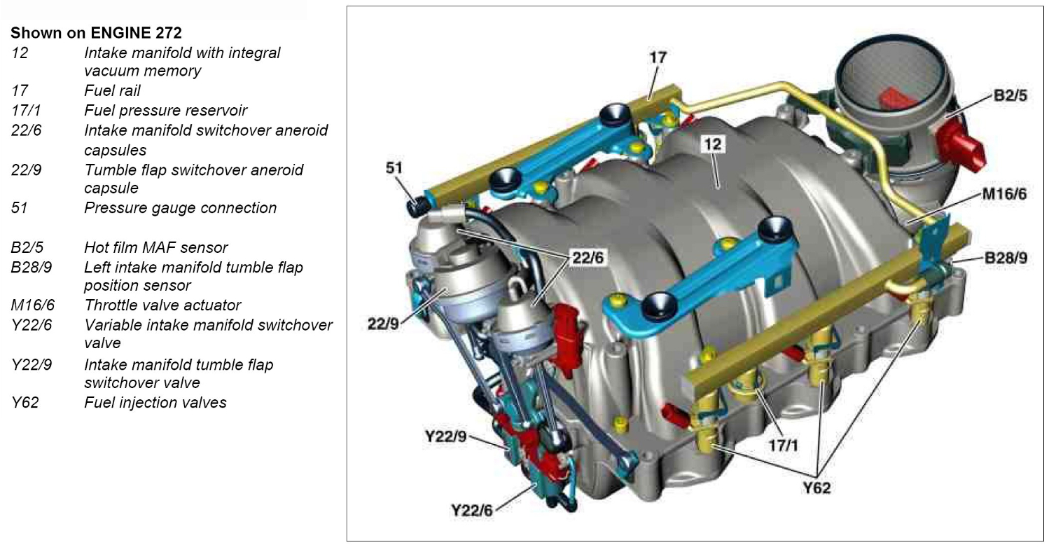

I need help with the codes. P2015, 07e8, and P2015 07e8pd?

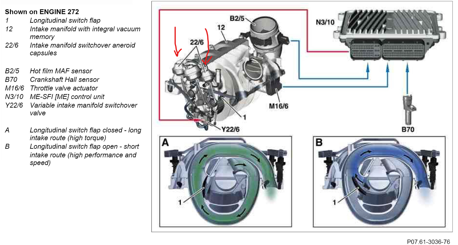

I looks like the tumble flap switchover control for the intake manifold is having a problem.
P2015: This code typically refers to an issue with the intake manifold runner position sensor/switch.
07E8: This is not a standard OBD-II code but rather a generic code indicating a request for more information about the powertrain
P2015 07E8PD: The "PD" suffix typically stands for "Pending."
Here is how to change the part out and check to make sure the butterfly valves are moving freely. Sometimes the vacuum line or control linkage will become disconnected which will give you this code, once you have found the problem clear the codes and you should be all set. Check out the images (below). Please upload pictures or videos in your response to any problems so we can see what to help you with.
