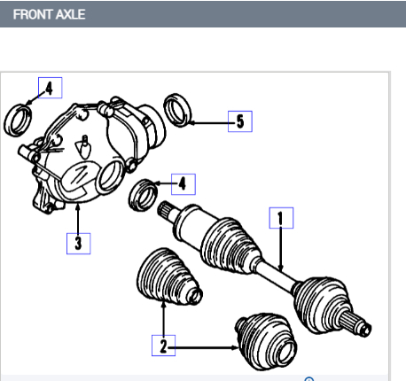

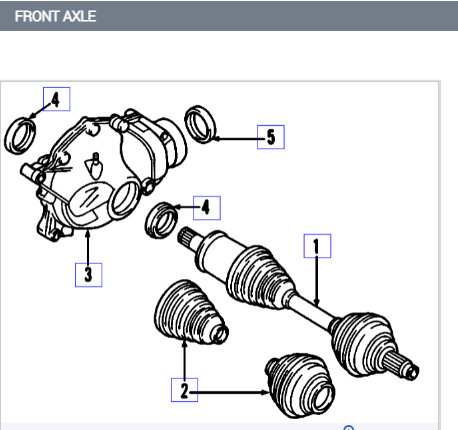

This noise can be due to worn suspension components, faulty CV joint, bad tires etc.

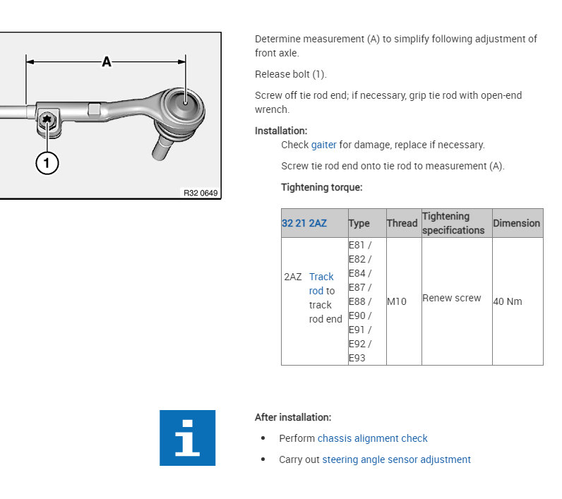

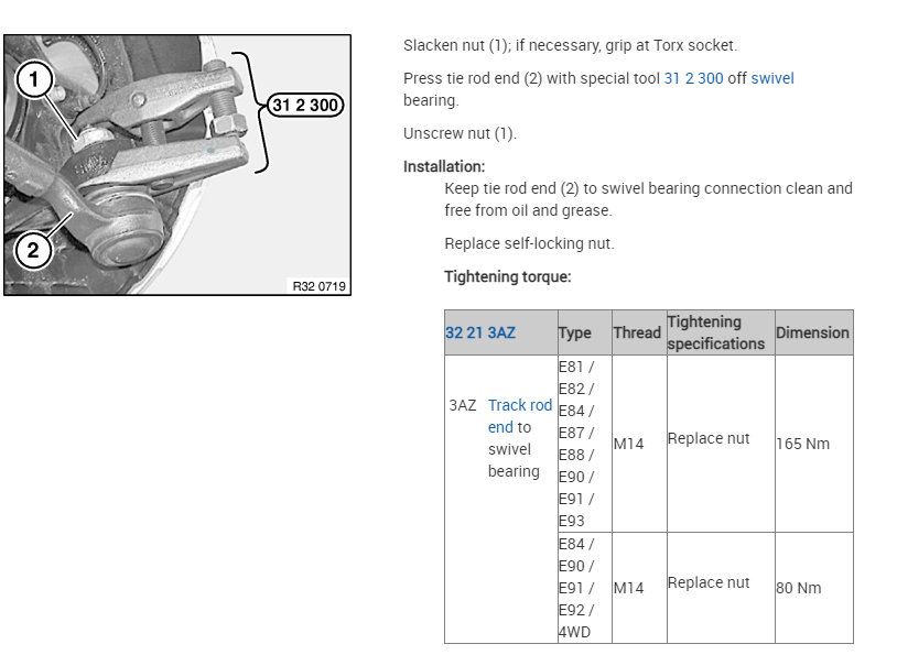

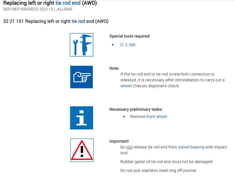

If you hear the noise when turning wheel, it can be due to a bad tie rod or CV axle.
Please let us know more details of what you are experiencing.
