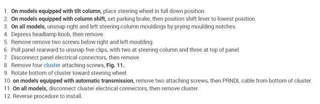

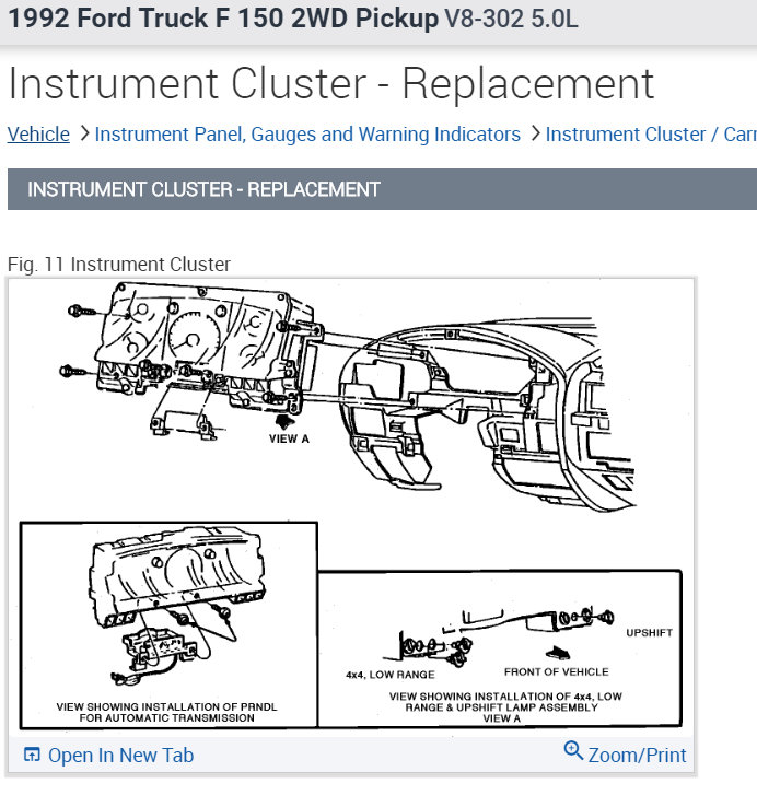

I have the truck listed above straight 6 with a 5 speed transmission. My speedometer and digital odometer stopped working. I replaced the speed sensor on the differential and checked all fuses. Still not working.
Sunday, September 29th, 2019 AT 11:51 AM
KEN L
  • MASTER CERTIFIED MECHANIC
  • 48,363 POSTS
I would check the instrument cluster wiring connector for corrosion, but it sounds like the speedometer module is out inside the cluster. You might need a rebuilt/used cluster. Check out the diagrams (below). Please let us know what happens.
