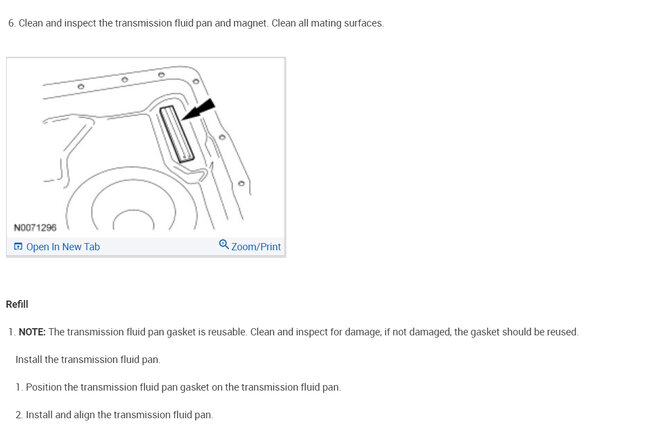

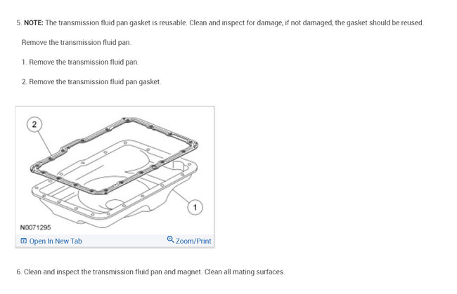

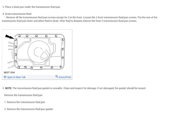

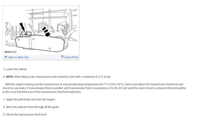

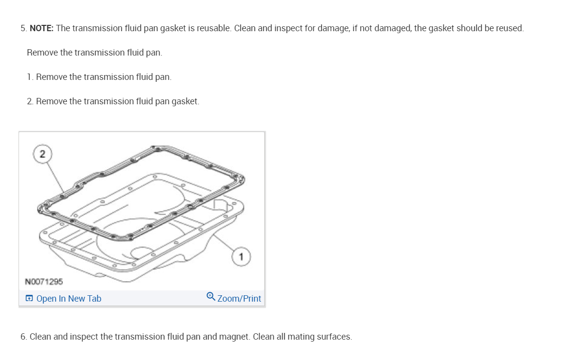

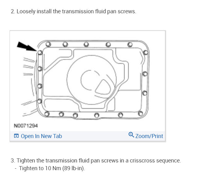

The truck has to be shifted through gears to even move at all at first. It had plenty of transmission fluid surprisingly considering in 50,000 miles I hadn’t changed it. I can slow down and stop turn around and it seems like the truck loses momentum and doesn’t want to drive as well. I drove half a mile and it seemed like it was struggling and gradually slowing down. First 30MPH and then 20MPH. when I got home and pulled in from my little test drive. So, I concluded after staying stationary it loses the ability to move without being shifted through gears several times first and it gradually loses all its momentum while driving even short distances.
Jan 13, 2023 at 4:18 AM
  • 55,224 POSTS

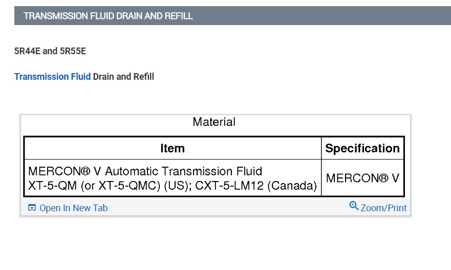

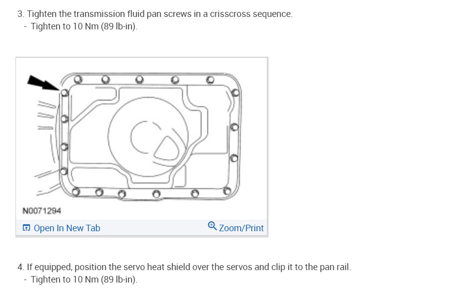

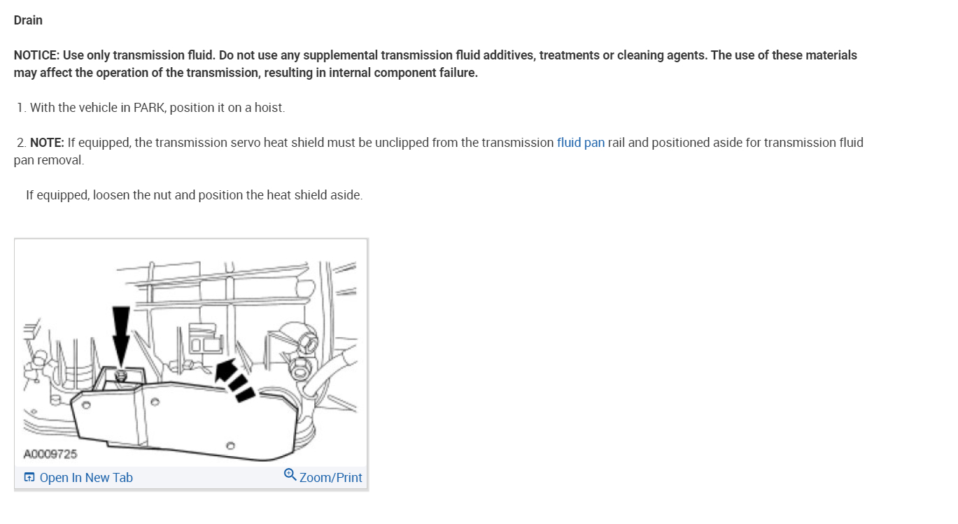

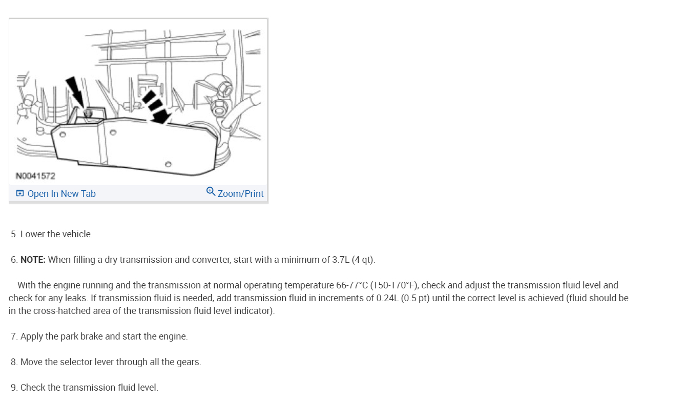

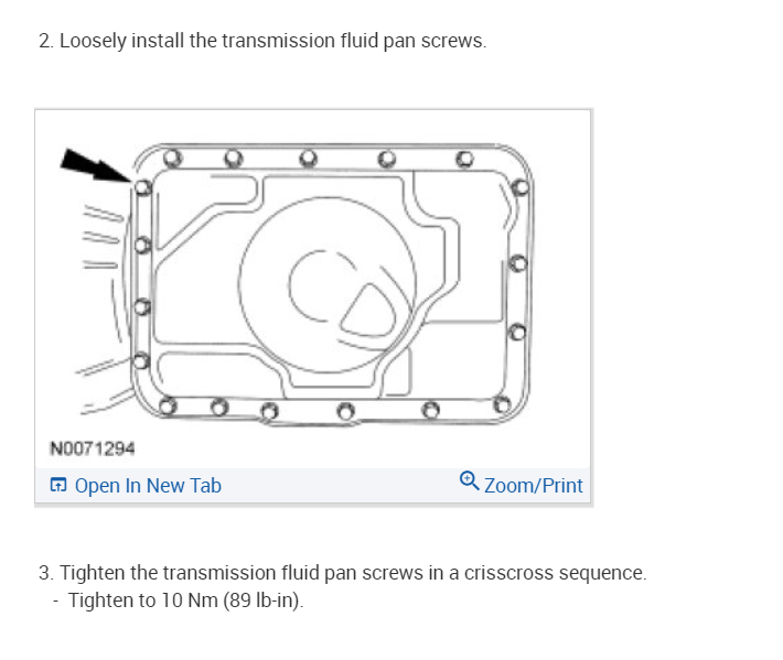

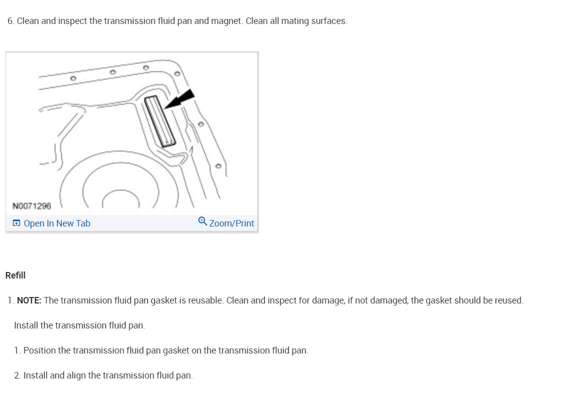

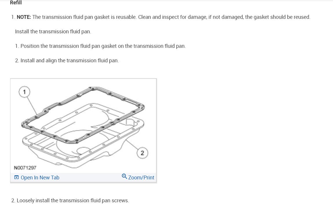

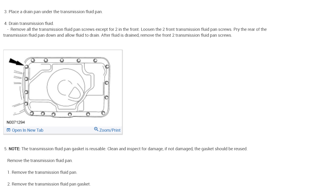

The transmission might be burnt up, but we should check the fluid condition by smelling it. Also, is there a check engine light on? if so, we should check the codes.
We should try to service the transmission which can help it. Here is a guide to help with instructions in the images below for your truck:
Make sure you change out the filter.
This video shows the job being done on a similar truck:
https://youtu.be/HJdcWI6m3J4
Check out the images (below). Let us know what happens and please upload pictures or videos of the problem.
