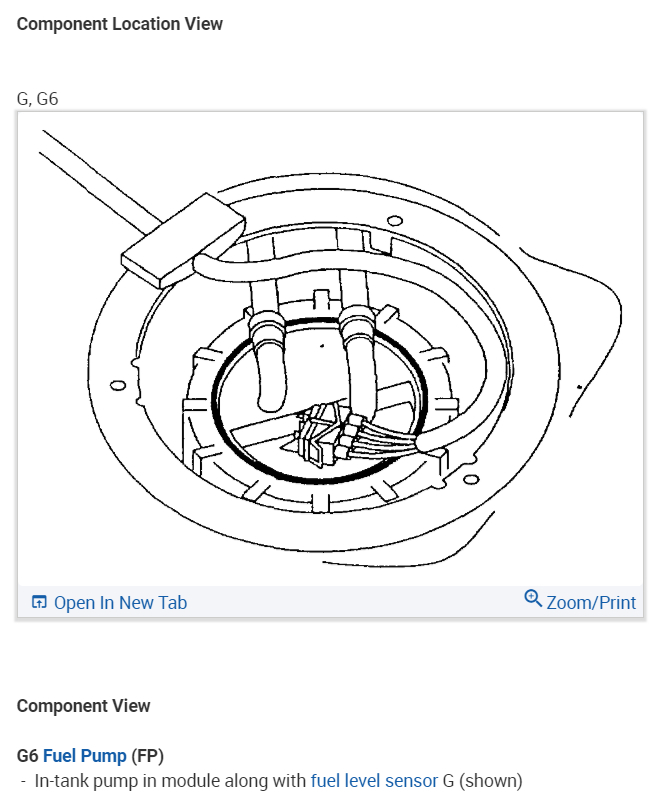

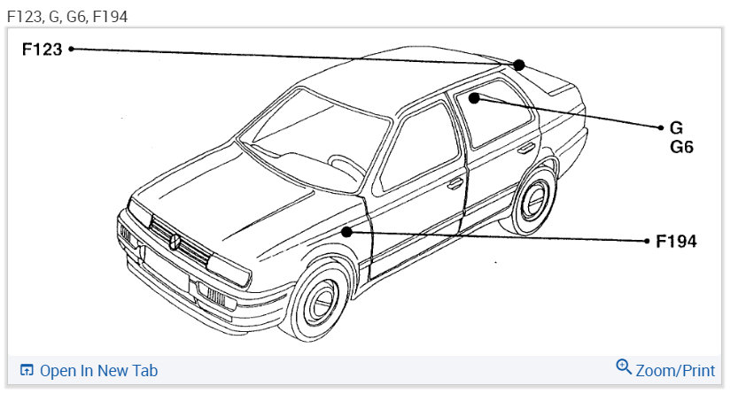

This sounds like a classic fuel pump going bad slow to pressurize and maintain pressure. Here is a guide to help you confirm the issue and diagrams below to how you how to change the fuel pump:
and
