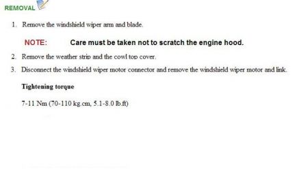

I am living in Mexico and drive a car no one has seen down here. The w/w motor went out and no one can fix it. I found where I can buy one in the US and have it shipped down here, but I don´t know how to take the old one out, where it is located or how to put in the new one. Please help me out. I am semi functional with doing small repairs. Thank you for your help. Jim Kinsey

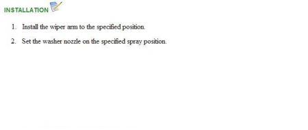

wiper motor is located between windshield and engine area, under the cowl vent.
https://images.2carpros.com/forum/automotive_pictures/261618_Noname_333.jpg
https://images.2carpros.com/forum/automotive_pictures/261618_Noname2_92.jpg
