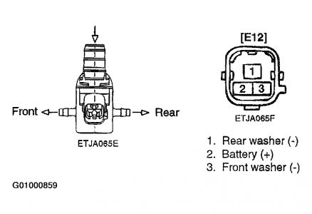

how to change washer fluid pump / not spraying seems bad - appears to be inside right front fender well

Washer Motor, Behind right front corner of bumper cover .. remove cover and pull motor out of fluid bottle
WASHER MOTOR
With the washer motor connected to the reservoir tank, fill the reservoir tank with water.
Connect positive (+) and negative (-) battery cables to terminals 2 and 3 respectively to see that the washer motor runs and water sprays from the front nozzles.
Connect battery positive (+) and negative (-) cables to terminals 2 and 1 respectively to see that the washer motor runs and water sprays from the rear nozzles.
Fig. 15: Identifying Washer Motor & Connector Terminals
