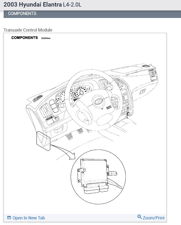

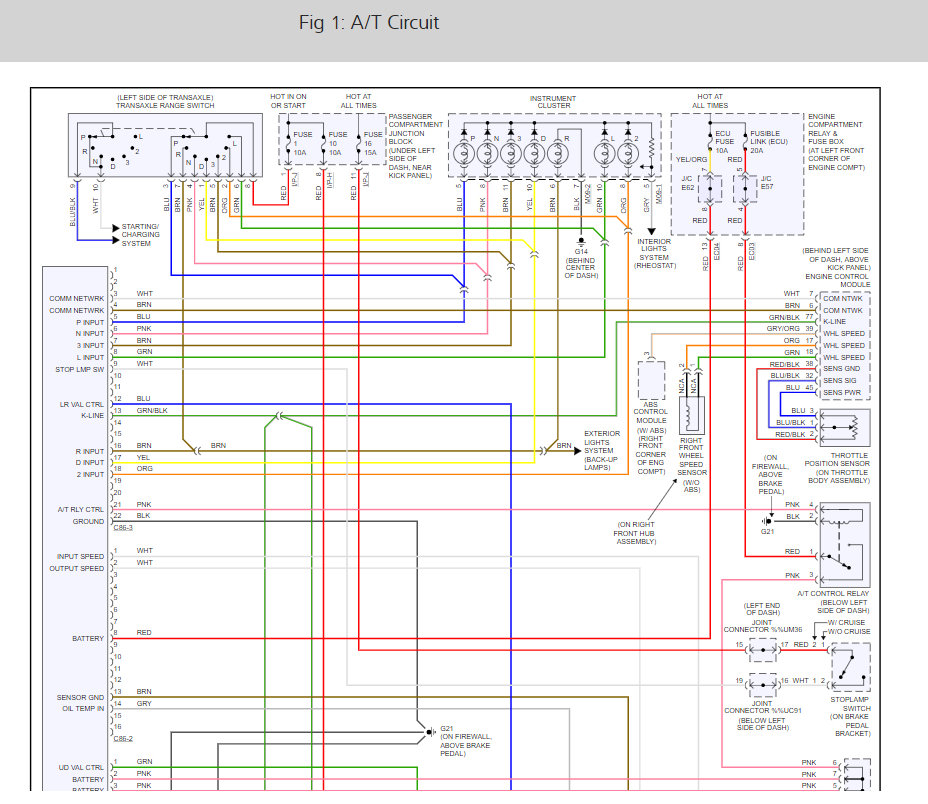

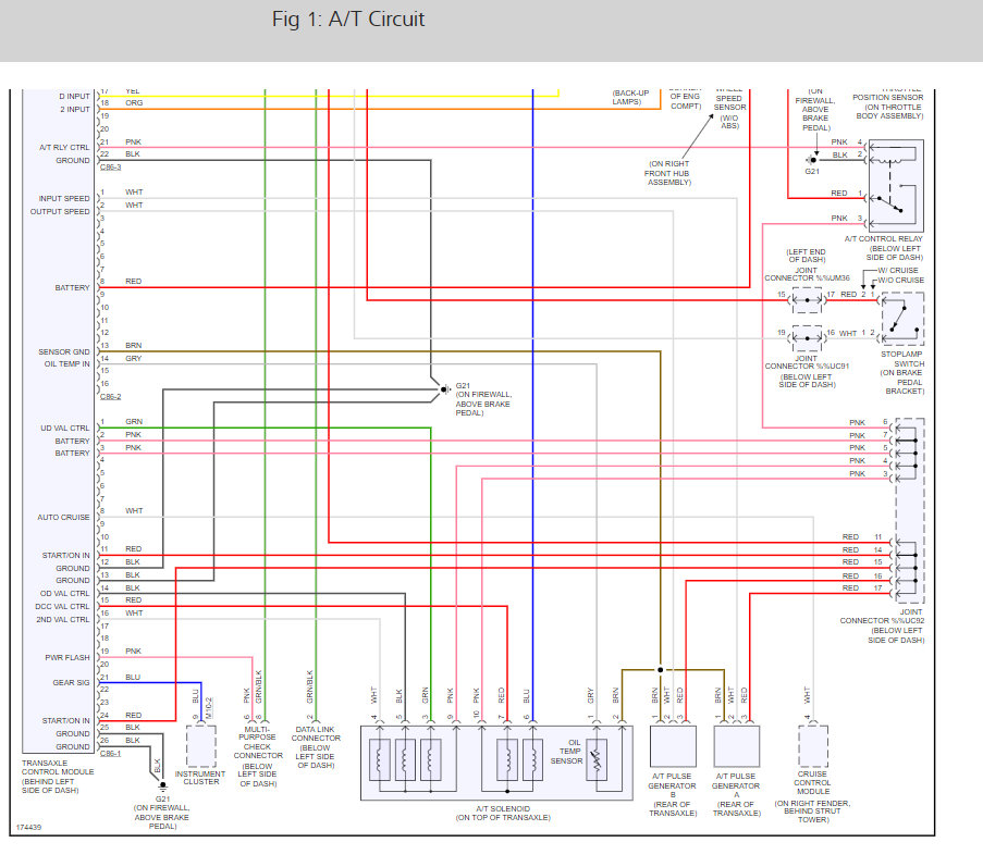

Okay guys having same problem with my 2003 Hyundai Elantra. Check light came on, from a dead start if I press the gas it revs high and lags to a slow start. I took to orielys yesterday and scanner showed P0715, I bought and replaced input sensor.
Check light is still on and it’s driving the same, I took it back scanned again and same P0715 code came up, and now P1529 saying no dtc. What do I do? Change the output? Is my trans no good?
Any help is greatly appreciated
Jul 2, 2019 at 6:43 AM
  • 55,224 POSTS
It sounds like the TCM is out or you have a bad connection between the TCM and transmission. Here is a guide to help you run some test and the transmission wiring diagrams so you can see which wires to test for the sensor and the TCM locations well.
Check out the diagrams (Below). Please let us know what you find. We are interested to see what it is.
