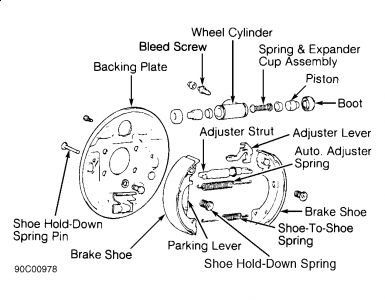

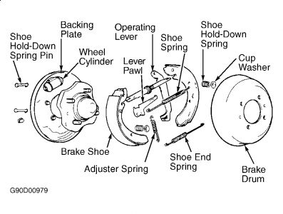

Does any one have a diagram of back wheel brakes. I am trying to assemble it from bare back plate and I was not there when they took it off. If I have a diagram I should be able to figure it up.

Ok there is two types of brake systems. Bendix and Mando type. If you look at the pics included you should be able to determine which type you have an put it back together following the diagram below. Here are you pics. Thanks and let me know how it goes.
