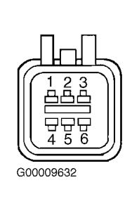

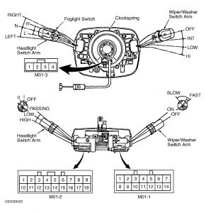

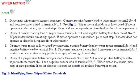

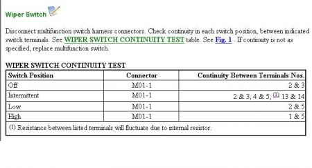

My wipers stopped working, so I replaced the motor, and they still would not work. So I replaced the wiper relay, and still they did not work. Any ideas on what to do next? Any help would be helpful, thanks.

You did not mention if the wiper washer motor worked or not. The unit that squirts fluid to the windshield.
If not working: Locate passenger compartment junction block (fuse box) behind left side of dash and check fuse #22 20A.
If working: Follow this diagnostic
https://www.2carpros.com/forum/automotive_pictures/55316_02elantrawiper_1.jpg
https://www.2carpros.com/forum/automotive_pictures/55316_02elantrafig1_1.jpg
https://www.2carpros.com/forum/automotive_pictures/55316_02elantraswitch_1.jpg
https://www.2carpros.com/forum/automotive_pictures/55316_02elantraswitch_2.jpg
