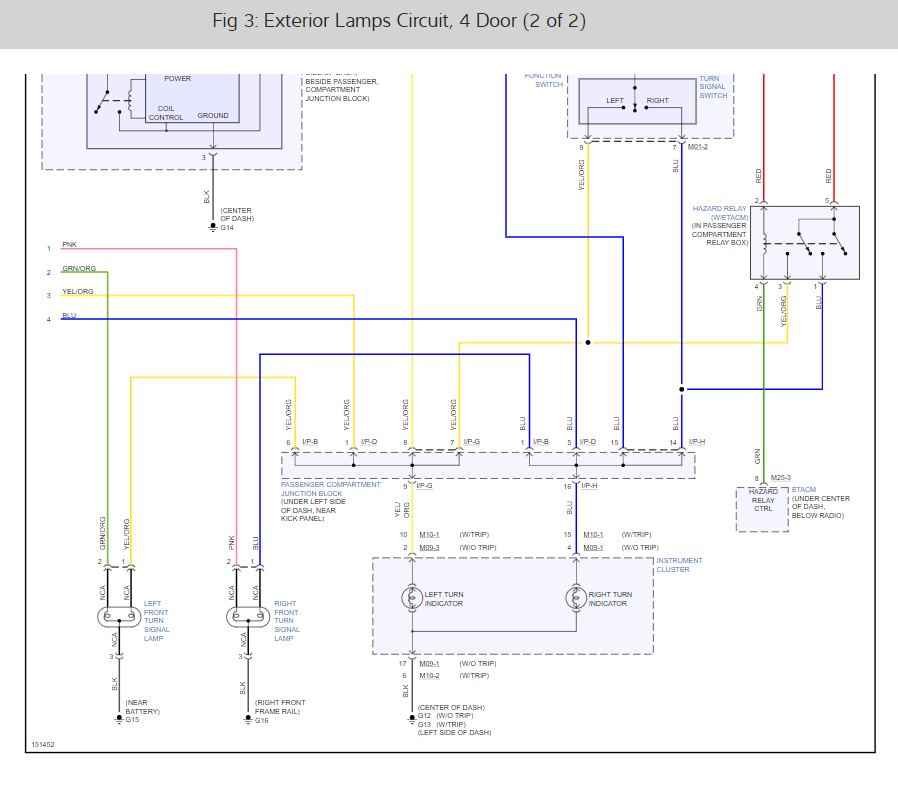

Drivers side tail light will not work. I have changed 2 bulbs now thinking maybe I got a bad one, but the second one did not work either. I literally took each rear end light off, disconnected the lead wires to the lights and pull the harness out of the grommet. I tried the drivers side rear end light on the passenger and it worked, then took the passenger to the drivers and again, did not work. I know there's nothing wrong with the rear end lights both sides work, is there something else I'm missing here? I checked fuses, ok. Also strangely enough, the yellow running light on the "drivers" side, just offset of the headlight is not working either. I also replaced that bulb this time around and it also, did not work, with a brand new bulb. My drivers side night time tail light is out and my drivers side running light is out, neither work with a new bulb. HELP! Tickets suck
Friday, February 27th, 2009 AT 7:06 PM
7 Replies
ZACKMAN
  • 4,202 POSTS

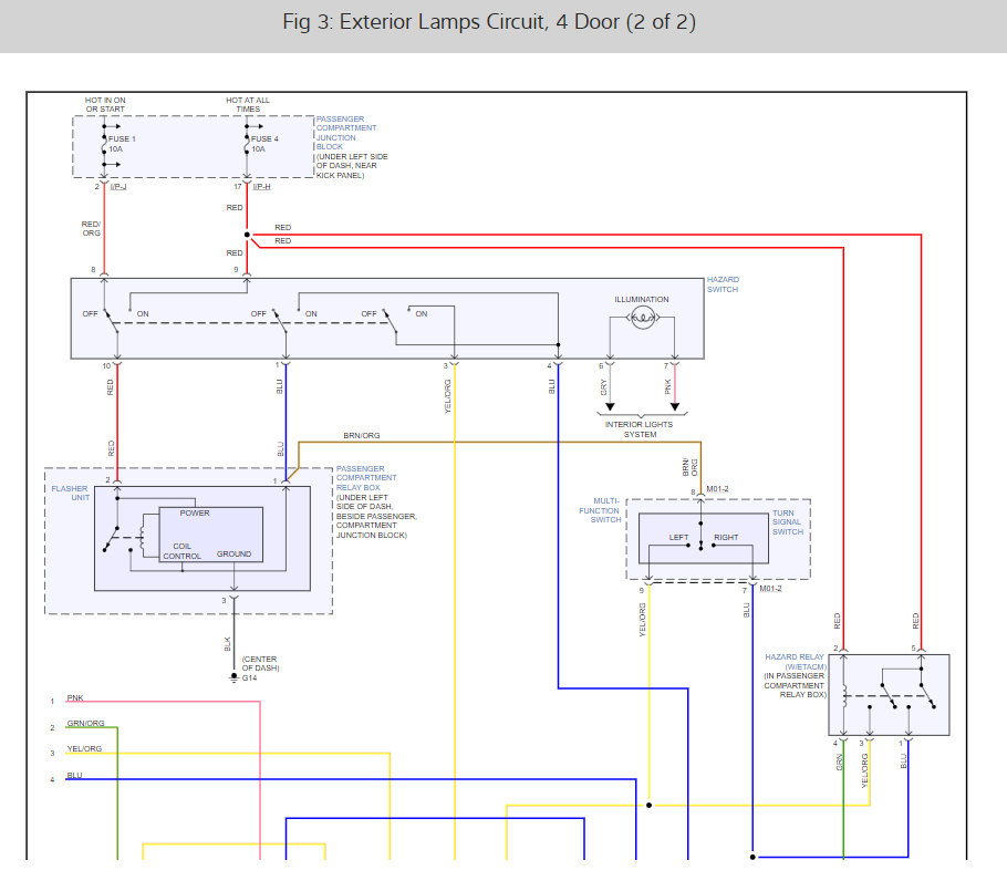

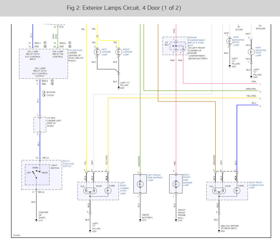

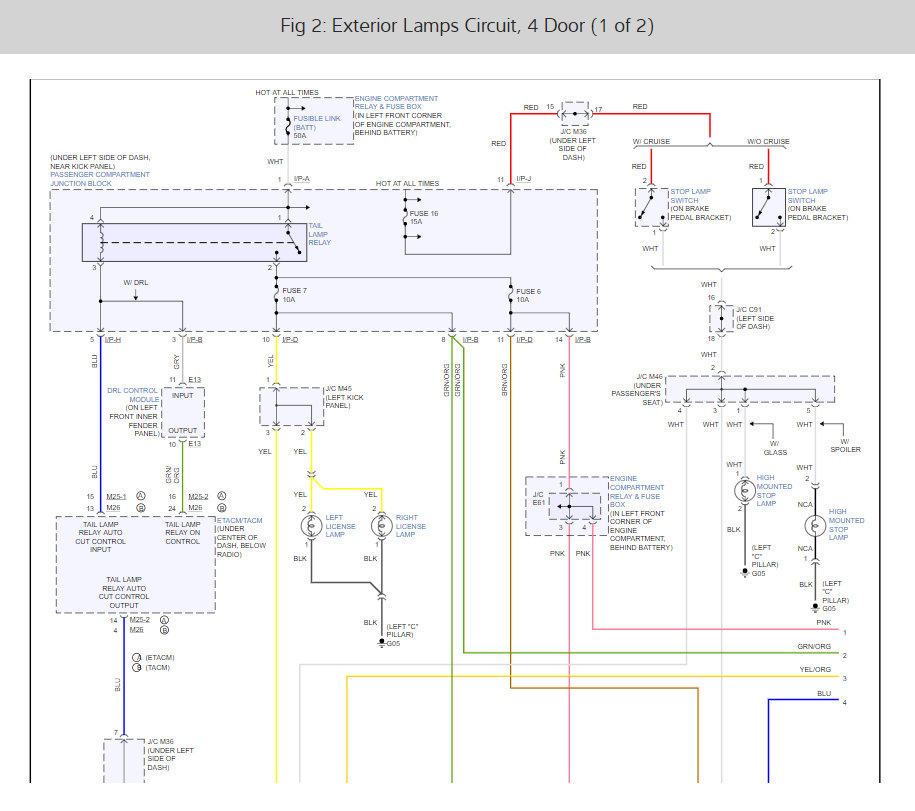

There are several fuse and a tail light relay that run the system you must be losing power somewhere here is guide to help you find it with the tail light wiring diagrams featured below.

I'm not an expert or anything with cars, but recently my 99 Hyundai Elantras' Taillights stopped working, when I turn the switch to turn them on, all that comes on is the headlights
Tuesday, April 28th, 2020 AT 12:55 PM (Merged)
WRENCHTECH
  • 20,761 POSTS
I believe your tail light relay is out
EDDY214
Thanks it was the problem all working now.
