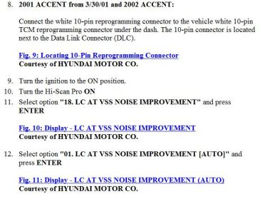

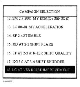

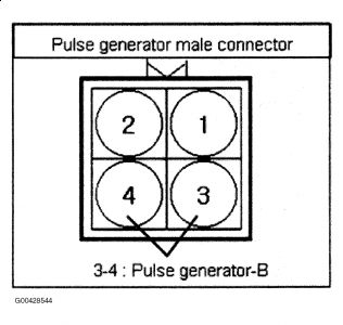

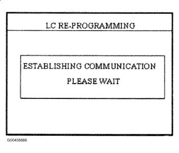

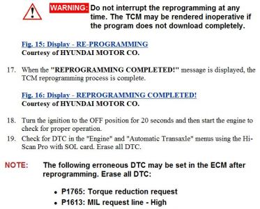

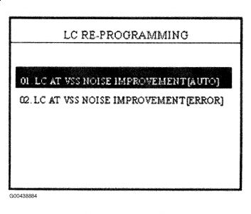

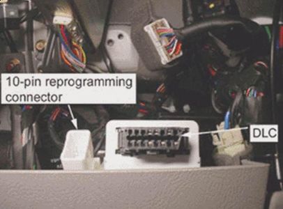

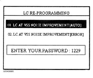

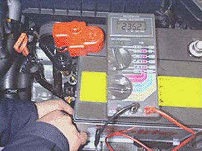

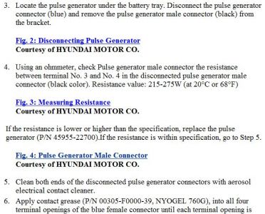

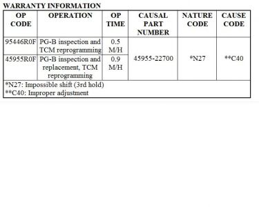

i have a 2001 Hyundai Accent GL and the engine light is on I had ran a code reader through to see what the problem was and the code that came up was about the speed control sensor is eaither missing or not hooke up. How do I find out the problem?
Saturday, March 21st, 2009 AT 6:54 PM
3 Replies
ZACKMAN
  • 4,202 POSTS
Instead of the description, can you post the actual code number so we can provide the proper diagnostic?
Tuesday, March 24th, 2009 AT 12:45 AM
HAILEYSMOMMY
  • 11 POSTS
The code is P0722
Tuesday, March 24th, 2009 AT 9:41 AM
ZACKMAN
  • 4,202 POSTS

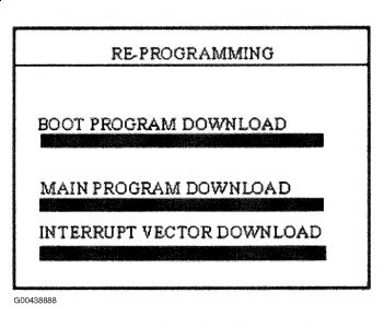

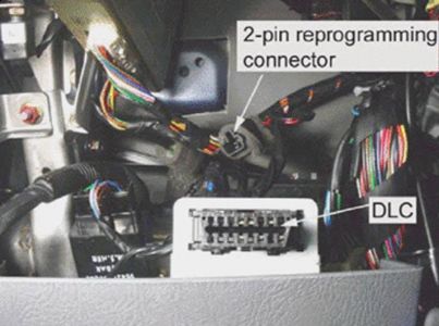

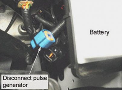

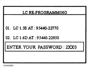

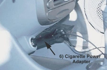

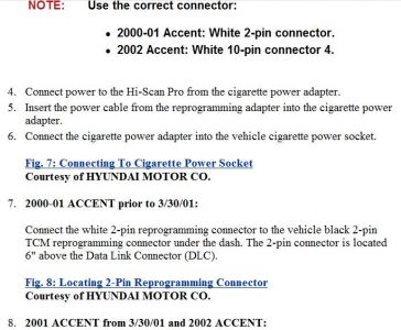

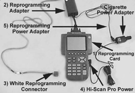

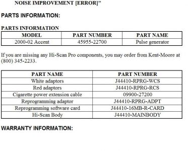

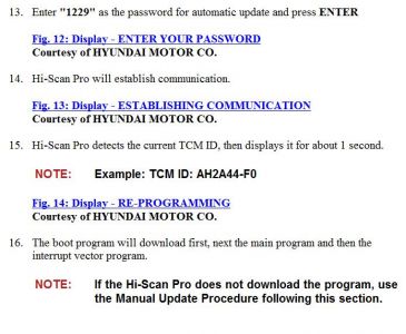

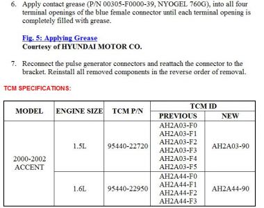

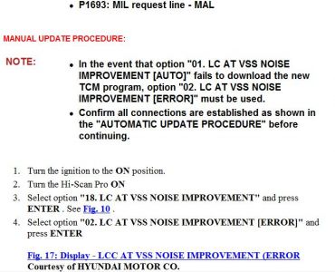

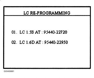

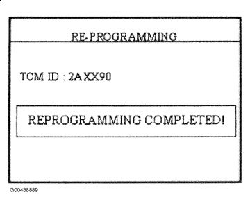

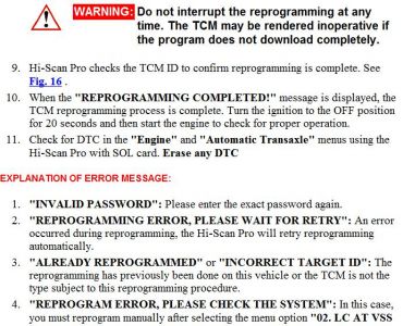

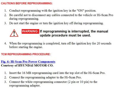

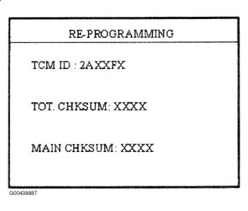

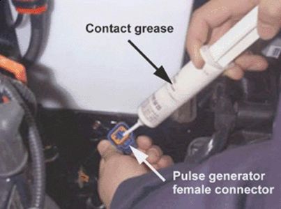

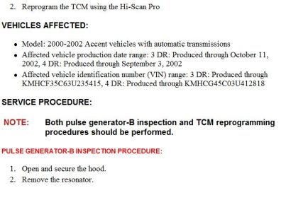

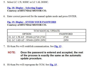

It is actually more than just speed sensor. It requires the programming of your transmission control module, that Hyundai has issued a Technical Service Bulletin 03-04-016.
https://www.2carpros.com/forum/automotive_pictures/55316_01accentp07221_1.jpg
https://www.2carpros.com/forum/automotive_pictures/55316_01accentp07222_1.jpg
https://www.2carpros.com/forum/automotive_pictures/55316_01accentp07223_1.jpg
https://www.2carpros.com/forum/automotive_pictures/55316_01accentp07224_1.jpg
https://www.2carpros.com/forum/automotive_pictures/55316_01accentp07225_1.jpg
https://www.2carpros.com/forum/automotive_pictures/55316_01accentp07226_1.jpg

I don't believe that this is something that can be done by a DIY, as it involves Hyundai scan tool.
