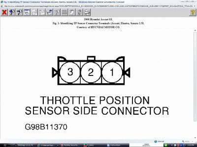

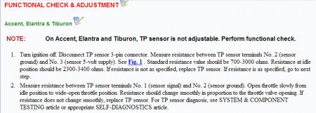

Bought car recently. Wouldn't run at all untill I had the MAF changed. Runs good now but it wont pass smog and has trouble shifting. Error codes "PO123 TPS sensor A CKT high input" and a transmission code. The TPS is a easily replacable part and it looks as if the hack I bought it from already did. Isn't there a way to set/calibrate the TPS electronically? Which the hack probably didn't do.
Also may need a Cat but thats another future issue.
Doing my daughter a "favor"
May 2, 2008 at 2:14 PM
MERLIN2021
  • 17,250 POSTS
There are many TSB's on the automatic tranny in these, but to get you the right info I need the actual tranny code..TPS is not adjustable, you can only do a function check, here's how:
https://images.2carpros.com/forum/automotive_pictures/62217_TPSa_1.jpg
https://images.2carpros.com/forum/automotive_pictures/62217_TPSb_1.jpg
You might need to clear the codes with a scanner...
