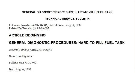

will this be covered by a service bulliton or a recall
my gas tank has a fill problem'
Common blockage issues are with the canister close valve and the canister filter. But you could also have a defective fuel cut valve in the tank or a blocked canister. You could also have a problem with a restricted hose or pipe either not allowing proper venting or not allowing the fuel to enter the tank properly."
Feb 27, 2009 at 8:47 PM
KHLOW2008
  • 41,814 POSTS
Hi suzonka, There was a TSB for this problem but you need to refer to the dealer if it is covered under warranty.
https://images.2carpros.com/forum/automotive_pictures/192750_TSBRefuelHyundai01_1.jpg
