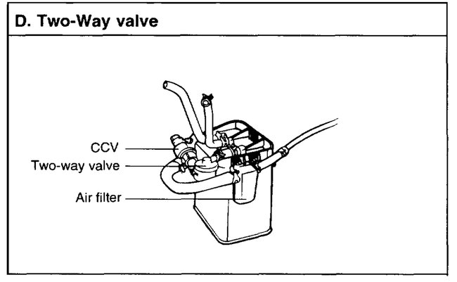

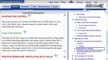

P0446 has to do with the Evaporative Emission Control Devices-could be the charcoal canister close valve, solenoid purge control valve,
https://www.2carpros.com/forum/automotive_pictures/12900_eec_1.jpg

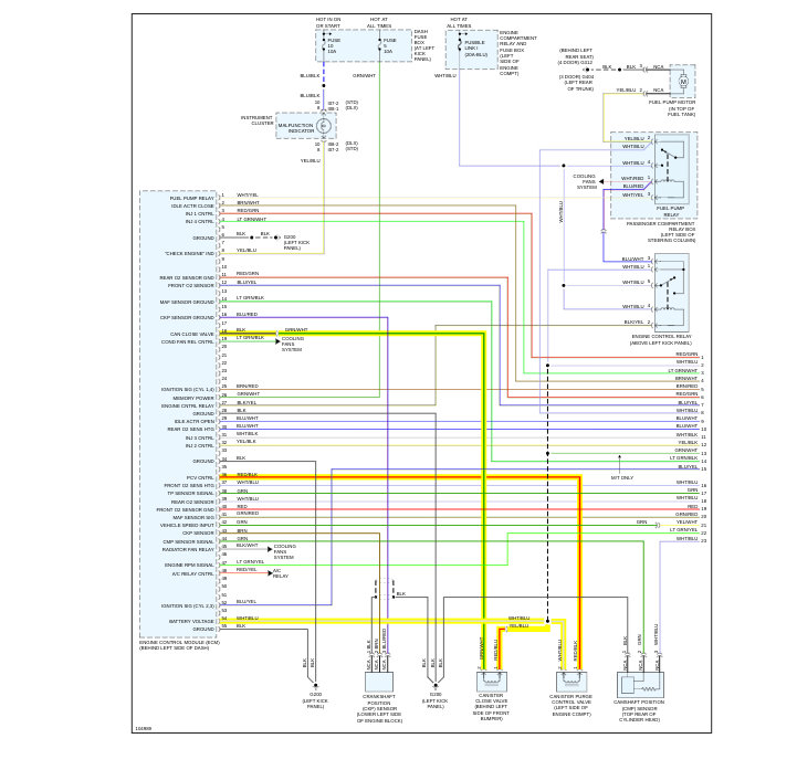

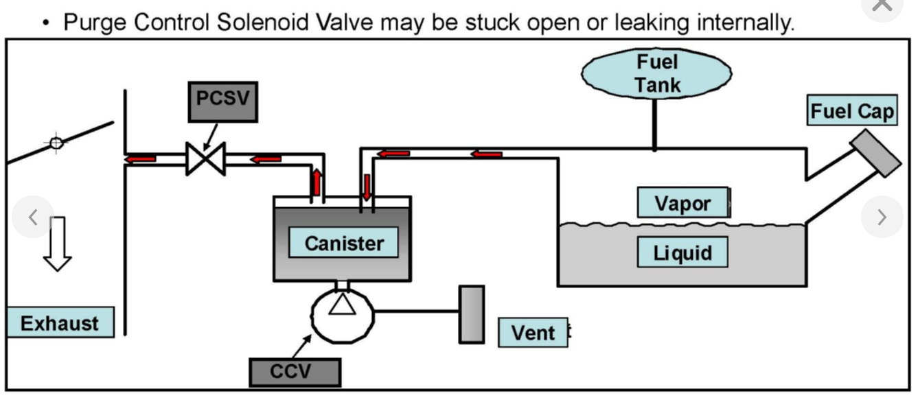

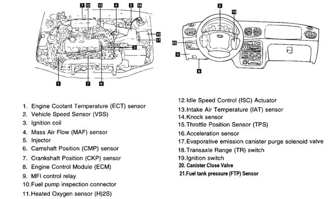

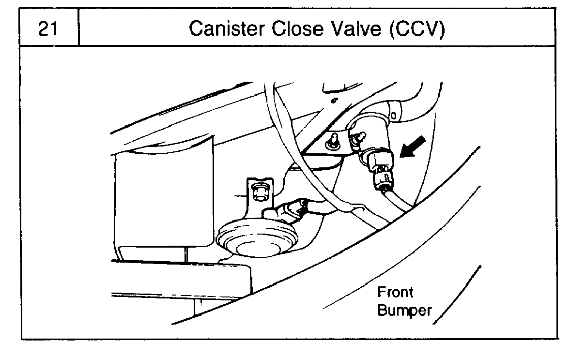

It is possible to be any of the things you mentioned but check the gasket of the fuel filler cap itself, For damage or deformation, replace the cap if necessary. Check the evaporative
purge control valve circuit I highlighted the circuit for you. Check The canister close valve white plunger is moving freely up and down. It is located in the fuel tank and can be accessed at the top of the fuel tank. Inspect your evap hose and components for cracks and clogs. Hint: Evaporative emission control system may not function normally because of mechanical trouble be sure there is good vacuum. I attached checking engine vacuum below. Make sure the vehicle isn't in this safety recall I listed below. Call your local Hyundai dealer with your VIN number and they will check it out for you. Let us know if this information was helpful and what fix your vehicle.
