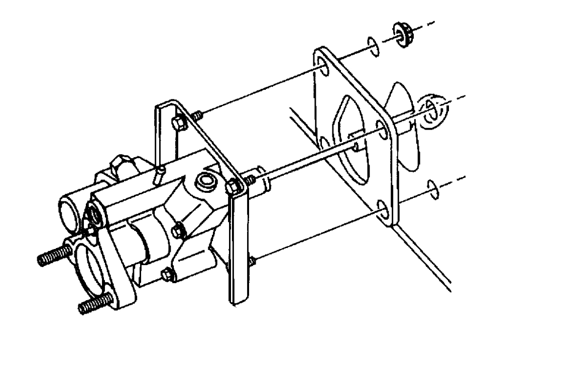

The brakes would not lock up when you were driving and a mechanic told us it was probably the hydrobrake booster.
Sep 28, 2019 at 10:15 PM
Good morning,
The brakes should not lock up up on a stop. That would indicate an issue.
I attached the procedure for you for the booster replacement.

Removal Procedure
1. Apply the park brake and block the wheels.
2. Disconnect the inlet hose, the steering gear. and the return hoses from the booster assembly
3. Remove the master cylinder. Refer to Master Cylinder Replacement.
4. Remove the stop lamp switch Refer to Stop Lamp Switch Replacement in Lighting Systems.
5. Remove the 4 booster to bulkhead nuts.
6. Remove the booster assembly.
7. Remove the gasket.
Installation Procedure
1. Install the gasket.
2. Install the booster assembly.
Notice: Refer to Fastener Notice in Service Precautions.
3. Install the 4 booster to bulkhead nuts.
Tighten the nuts to 33 Nm (24 ft. lbs.).
4. Install the stop lamp switch. Refer to Stop Lamp Switch Replacement in Lighting Systems.
5. Install the master cylinder. Refer to Master Cylinder Replacement
6. Connect the return hose, the steering gear, and the inlet hoses.
7. Bleed the hydraulic booster system. Refer to Bleeding the Power Steering System in Power Steering System.
8. Release the park brake and unblock the wheels.
