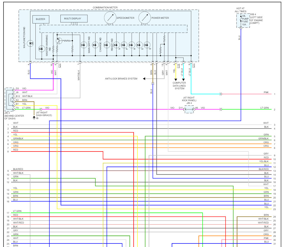

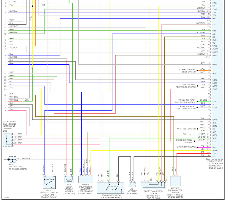

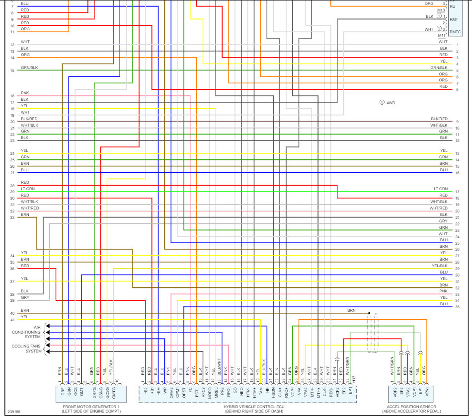

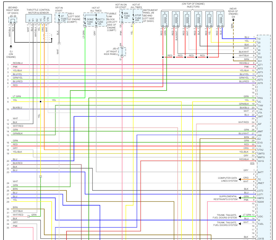

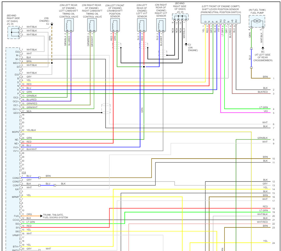

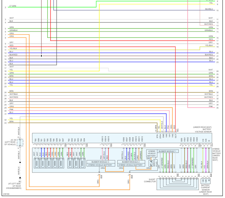

Sure, there are the hybrid and engine wiring diagrams as requested, also I have included a guide to help you test the connections. The large wires are high voltage so don't mess with those unless the hybrid battery is disabled.
Check out the images (below). Please let us know if you need anything else to get the problem fixed.
