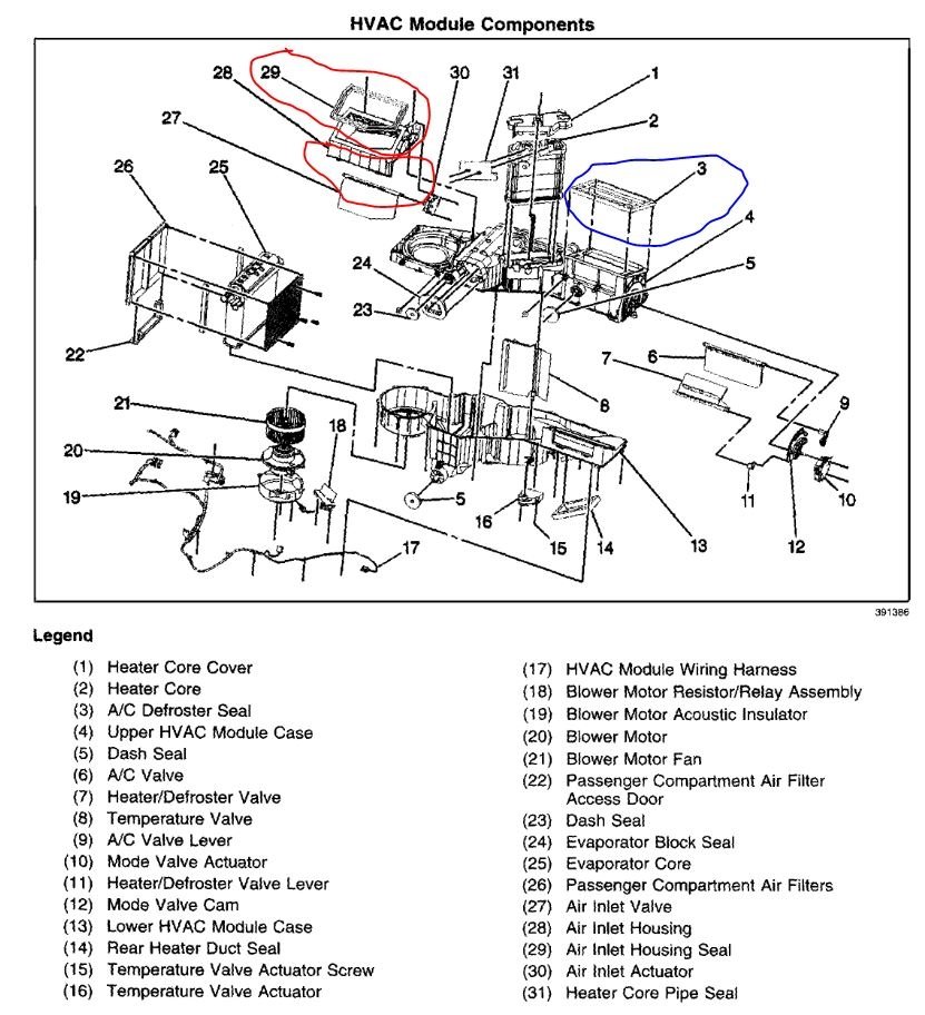

During cold months when heater is running, cool air is coming out from behind glove box while driving. Have plenty of heat just got a draft that's chilling for passenger in winter.

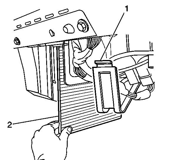

Try putting you hand there and changing the blower speeds, does the amount of air change as the speeds change? Now try switching from hot/cold and see if anything changes, next try that on the recirculate setting as well, It sounds like there is an air leak around the blower housing. It could be the housing or possibly the cabin air filter door is open or loose.

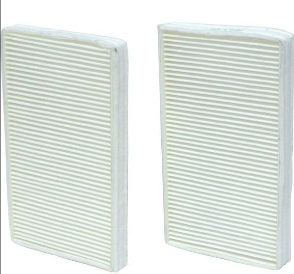

The air filter is located between the blower fan and the HVAC case. To access it you remove the under dash insulator panel, then remove the door over the filter. The filter will slide out in two pieces. If it hasn't been changed in a while I have a vacuum handy, they can dump quite a bit up junk out. Clean up the area, slide a new filter into place and put the door back on. If the door has warped or shifted you can replace it or apply some sealing foam like you use for weather strips. Or you can add extra screws if needed, just be careful not to damage the evaporator core as it's next to the filter. If you can find them the filters with activated carbon in them are a good upgrade. They cut down on exterior odors getting into the cabin.

Steve W.,
The cool air is not coming from the cabin filter door. It comes from the upper right corner behind the glove box. While truck is moving and warmed up, no fan on I can feel it with my hand. When I turn on the fan the volume of cold air decreases and is almost nil at full fan speed. Returning the fan speed to off and pushing the recirculation button the cool air increases. Adjusting the temperature does not effect the cool air amount. Pushing the outside air button does not effect the cool air volume. Turning on the A/C does not effect it either. Nor does switching the mode button from floor vent through defrost vent settings.

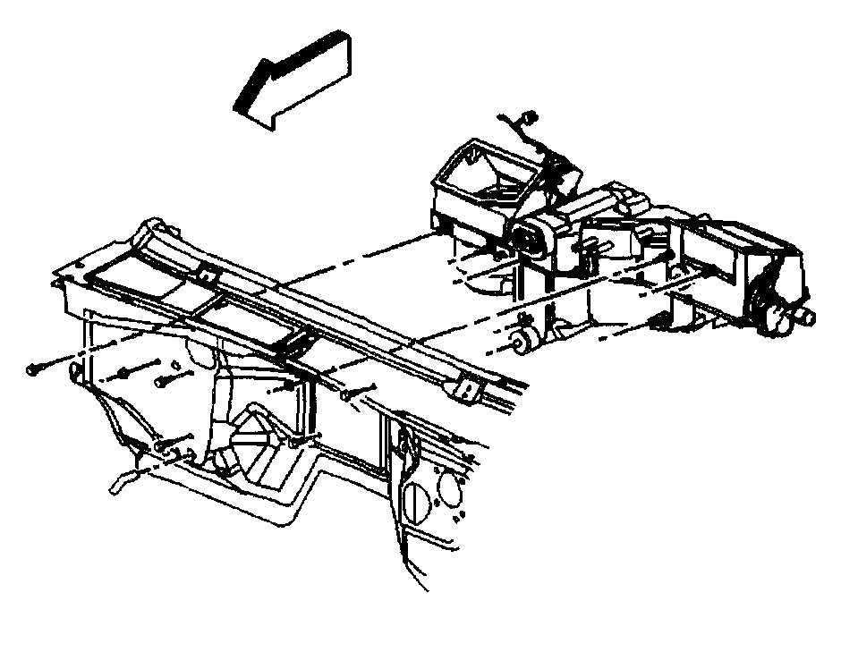

Okay. That sounds like the housing seals are failing, they are a foam type seal and deteriorate over time. The repair process is not fun as it involves removing the HVAC case to get to the area the seals are. To do that you need to strip out most of the interior to remove the dash and then the HVAC case. It is the same process as changing the heater or evaporator core. Which if you are going to do the seals I would suggest rebuilding the entire case just to avoid needing to take it apart again when one of those starts leaking.
This is the book process for the case:
1. Drain the engine coolant.
2. Reposition the inlet heater hose clamp from the heater core.
3. Remove the inlet heater hose from the heater core.
4. Reposition the outlet heater hose clamp from the heater core.
5. Remove the outlet heater hose from the heater core.
6. Remove the accumulator.
7. Remove the IP carrier. (This means the dash assembly and console)
8. Remove the heater/vent module drain hose.
9. Disconnect the electrical harnesses and the ground connections.
10. Remove the heater/vent module mounting nuts and the screws.
11. Remove the heater/vent module assembly from the vehicle.
What they don't mention is that the A/C system also has to be recovered and disconnected as well.

One thing I forgot to mention is after truck is warmed up and I park it, I turn down the fan and temperature control from max hot to say 72 degrees I hear a sound like a thud. Like something is sticking. Is this part of the problem too? The tech document states replacing the recirculation mode door actuator.

When the system is not in recirculation mode all of the air that comes into the vehicle is from outside air. It is pulled from the cowl area through the HVAC case. Fan on/off, temperature or mode makes no difference in that.
The only difference in the auto vs manual control system is that yours has more control over what the actuators do to maintain a set temperature, in the manual version the person will turn the heat up/down or fan speeds to control the temperature. In yours, you set a temp of say 80 and it reads the interior temperature through the aspirator and controls the fan, blend door and AC to maintain that temperature.
The thud sound you hear is the blend door, in max heat it will be fully open, when you turn the temperature down it will close to reduce the air temperature. The recirculation actuator is going to put the door in the normally closed position. In that position the air from outside the vehicle is what you get inside. That was why I had you turn the controls on and off and feel the airflow earlier. It showed there was no difference in the air you felt, if the temperature of the air changed or the amount changed I would suspect one of the actuators, in this case your testing points only at the case seals. The problem then is how to repair them.
The TSB applies to the earlier trucks, the one you own uses a different design in the case and body of the truck so it likely doesn't apply at all. However it might be possible to access the upper case seal through the cowl panel, I've never tried it on that particular truck, on the regular P/U version you need to pull the case to get to the seals, not an issue when the truck is on the assembly line, but once built it's not fun.
Service information shows the images I attached earlier, The only thing that would show better would be the build manual, but you won't find that outside of GM.

I did some more investigating, got AC/heater module, air distribution system exploded views from local GM dealer. I also took another drive. With fan, AC/heater off the air comes in right at the recirculation door. Pushing the recirculation button on, the cool air increases when door moves then slows down to the level it started with after it opens. And visa versa pushing it off. Also the foam on the door crumbles when I touched it, yikes. So, I am thinking the door is the issue. How bad of an ordeal is that to replace?
Apr 10, 2021 at 6:39 AM
STEVE W.
  • 15,330 POSTS
Same as replacing the other seals, unless you can come up with a way to sneak it into the housing around the door and get it to stick. If it were my vehicle I might think about using something like a dremel tool to cut an access hole in the case where I could get to the door , maybe even make it where I could get to the outer seal and use some of the minimal expanding foam to seal the outer case to the cowl area, then glue the cut out section back in once I was done, if it were mine that is. But I'm lazy and don't like pulling the dash out...
