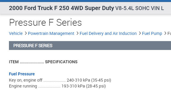

You replaced basically everything that can cause it. However, have you checked the fuel pump pressure? Low or high pressure can cause this. If you haven't checked it, here is a link that explains how it's done:
If you look below, I attached the manufacturer's pressure specifications.
Let me know what you find.
See pic below.
Aug 19, 2022 at 11:46 PM
MBFOR99
  • 46 POSTS
Okay, fuel pressure was fine now yesterday morning it just about stalled on me idling and it through a code for the IAC valve I replaced it that day idle seem a lot better until it get started again when already warm. do you think an ECT sensor could be sending wrong signals to the ECM and adjusting my air fuel ratio?
