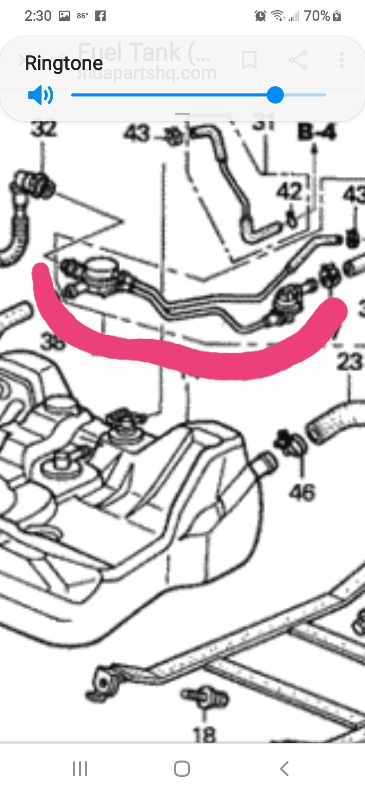

Thank you. The tank is plastic. It is all clean now. I used a combination of baking soda, vinegar and water, and scrubbed it with kitchen dish brushes. And I do intend to change everything you mentioned above, and adding the inline fuel filter.

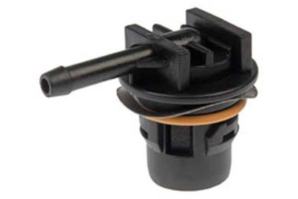

So, how do I remove the valve assembly (ORVR) from the fuel tank?
Oct 27, 2019 at 8:36 PM
STEVE W.
  • 15,349 POSTS
If that image is your tank you can take if off at the connections then remove the charcoal canister and replace it. I looked for a better diagram but the Honda City wasn't sold in the US, just everywhere else! On many Honda's they use a valve that twists into place like the one in the image. However they also have ones that are glued into the tank. Those are not easily removed, However you could use Acetone to flush the valve out, but it would need to soak to soften the varnish. Think you could take a picture of the pieces and tank and post it here? That would let me see the exact items. I would just use the Fit diagrams as they are based on the same chassis, I just don't trust that Honda actually used the same exact parts.

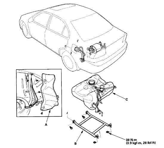

I have bought a new fuel tank strap, but I do not know which way it goes. Neither the vendor nor the manufacturer have responded to my query. Thank you for your help.
Nov 21, 2019 at 11:06 PM
STEVE W.
  • 15,349 POSTS
Okay, being a Civic makes it much easier to deal with. The tank straps go in place as in the picture. In your picture the longer legs to the left go toward the front of the car. Usually they are a fight to install as they use the bolts to tension the straps and hold the tank so you end up doing the octopus dance trying to hold things in place. What I normally do is get a floor jack and set the strap in place over it, then jack it up to hold the tank into place. Now you can position the strap and tighten it in place. Put all 4 bolts in a few threads before you tighten any down.
