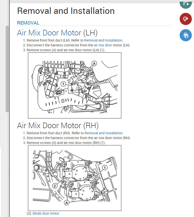

My vehicle does not blow correct temperature air. When the temperature on the control panel is set to 80 degrees, the passenger side blows hot air and the drivers side blows cold air. I tried replacing the temperature sensor under the center console, but this did not fix the issue. I read that the issue could be the blend door actuator. I want to try this fix, but I can't find any information on how to replace this part. Help please.

This sounds like a blend door issue due to having a dual climate system. However, we need to make sure you replaced the correct door.
Here is a guide that will help with this:
Below you will see the process for the left- and right-hand side actuators. I suspect your issue is on the left side.
Let us know what other questions you have and what happens with this. Thanks
