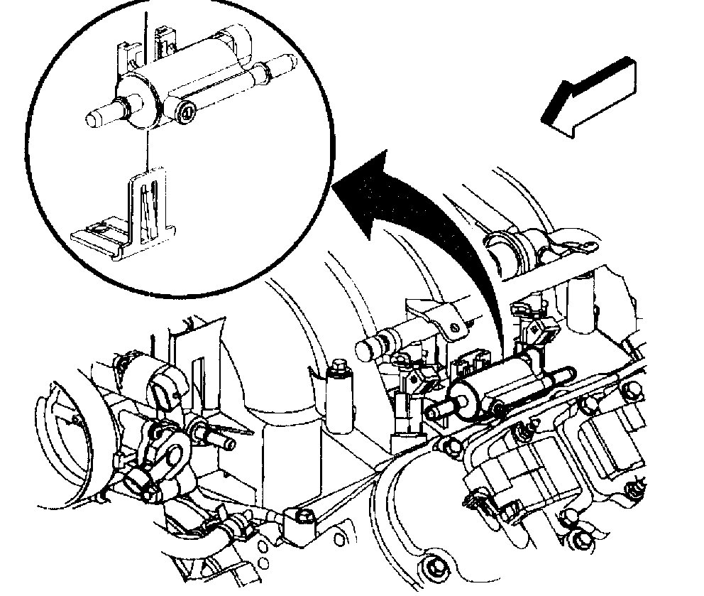

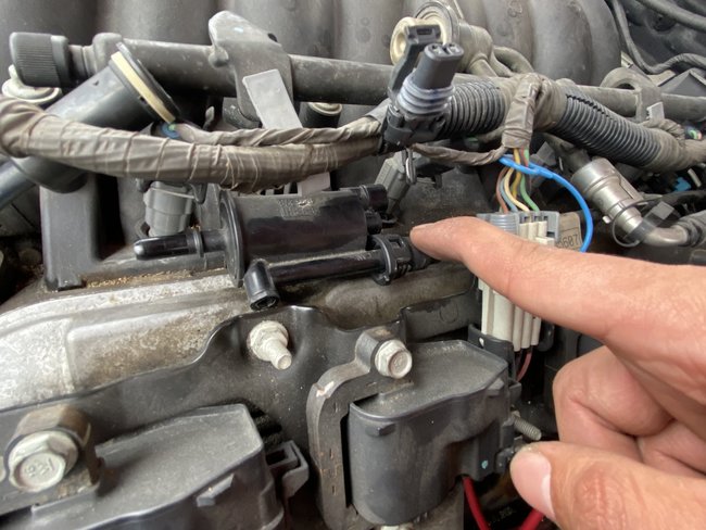

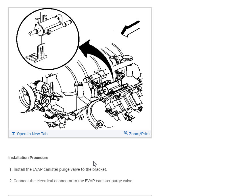

How do I go about to removing and replacing the purge valve?took one line off but the other one kinda stuck on there.do I need to remove the purge from the bracket to replace?
Apr 27, 2020 at 2:36 AM
If the line is fighting a little bit, I would remove the purge except for that line and then you will have more room to get it off.
I attached the process on how to remove and replace it. Let us know what happens and we can go from there. Thanks
Apr 27, 2020 at 3:59 AM
  • 110,240 POSTS
If you press the release, gently wiggle the connector while turning 1/4 turns back and forth. It should come off.

Here are the directions for replacement. The attached pics correlate with the directions.
_______________________________
2004 Pontiac GTO V8-5.7L VIN G
Procedures
Vehicle Powertrain Management Emission Control Systems Evaporative Emissions System Canister Purge Control Valve Service and Repair Procedures
PROCEDURES
pic 1

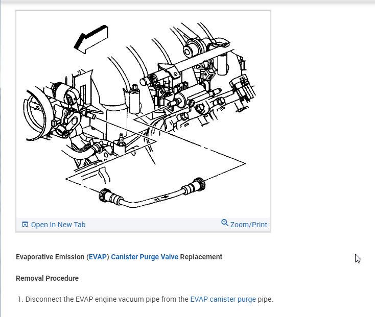

Evaporative Emission (EVAP) Canister Purge Valve Replacement
Removal Procedure
1. Disconnect the EVAP engine vacuum pipe from the EVAP canister purge pipe.

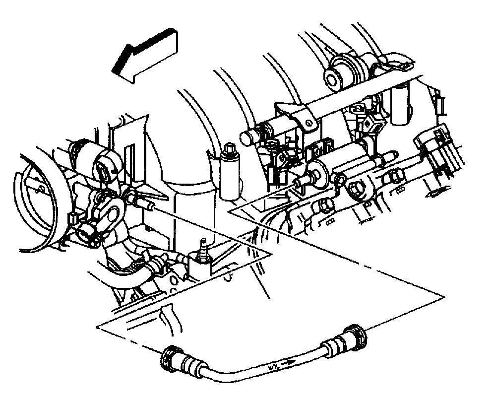

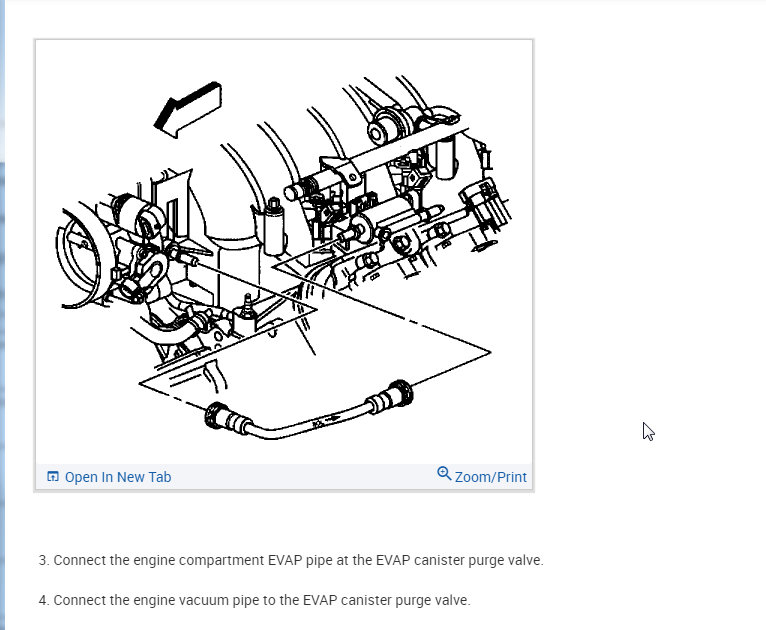

pic 2

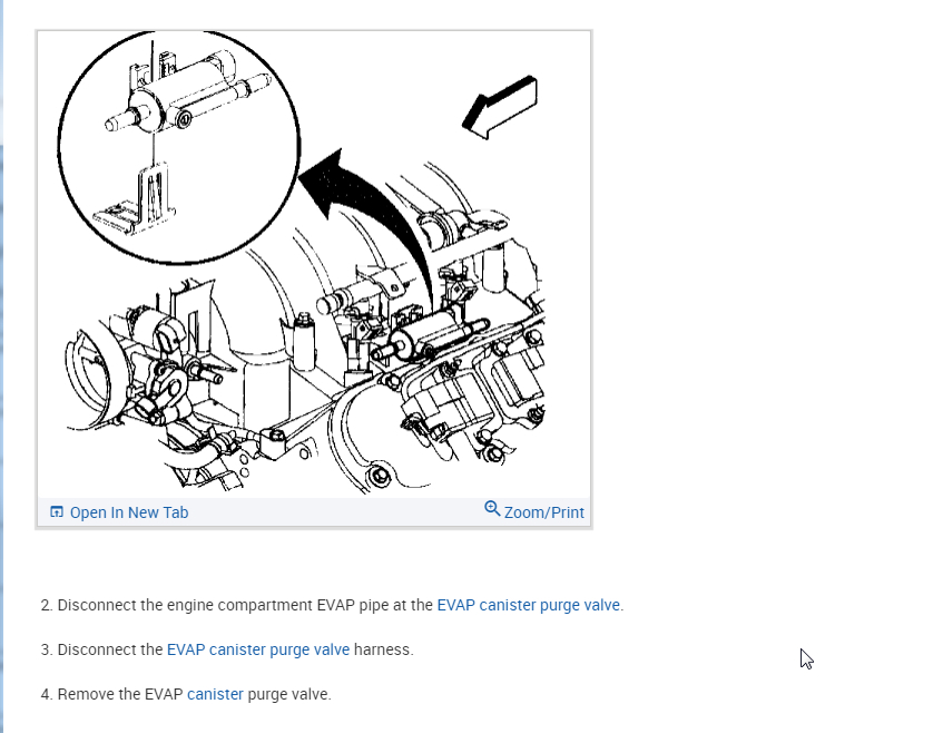

2. Disconnect the engine compartment EVAP pipe at the EVAP canister purge valve.
3. Disconnect the EVAP canister purge valve harness.
4. Remove the EVAP canister purge valve.

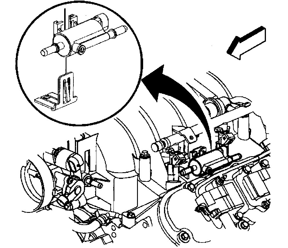

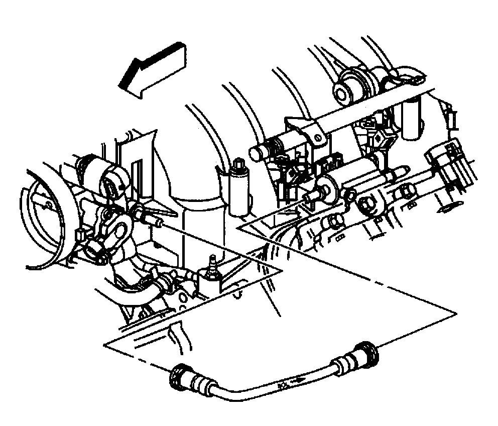

pic 3
Installation Procedure
1. Install the EVAP canister purge valve to the bracket.
2. Connect the electrical connector to the EVAP canister purge valve.
pic 4
3. Connect the engine compartment EVAP pipe at the EVAP canister purge valve.
4. Connect the engine vacuum pipe to the EVAP canister purge valve.

Let me know if it doesn't come off. Note there is a rubber o-ring in there that may have a bit of corrosion on it causing the problem.
